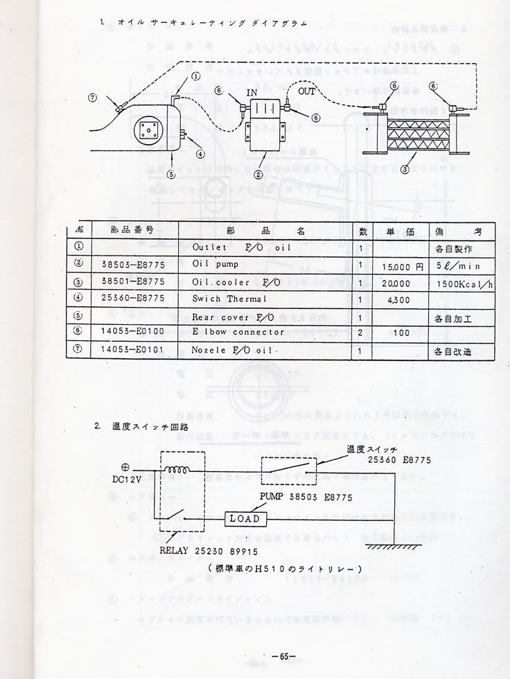

Thanks to Alan for providing these pictures in an earlier discussion...

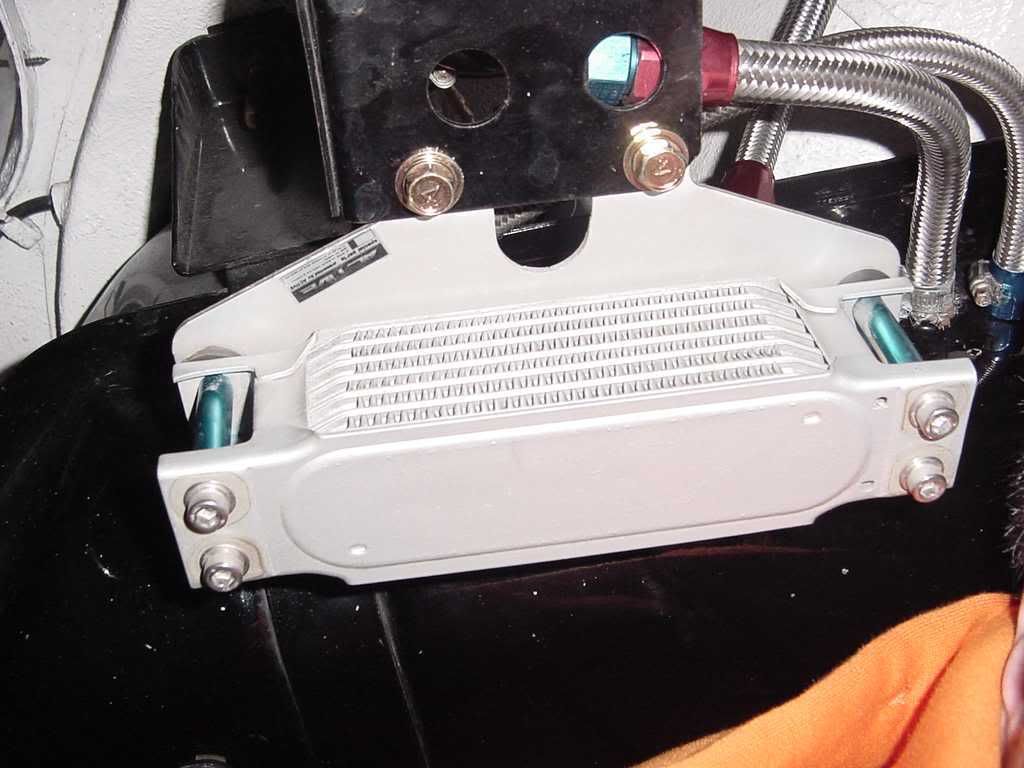

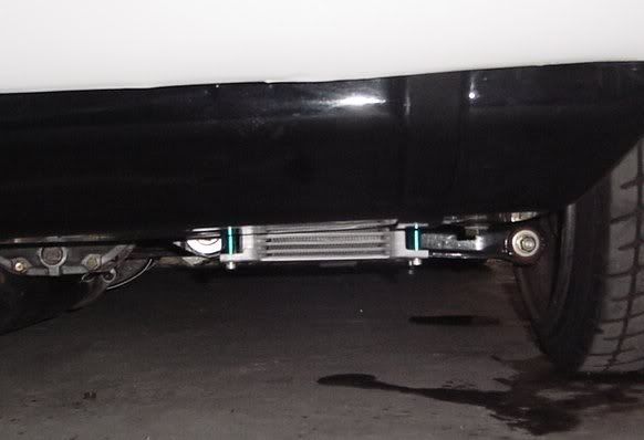

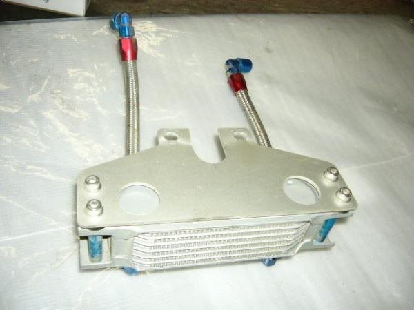

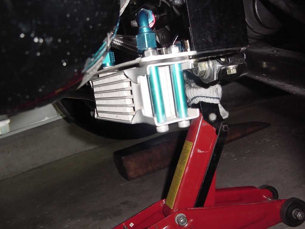

Damn... that's fugly (the oil cooler). I'm sure it's mounted there for air flow but surely it could be mounted somewhere hidden and a fan used for cooling instead??
That looks like more of a Japanese styling accent than a good place to put the cooler. Ever seen those Japanese cars with the oil cooler lines that go out the grill to a cooler mounted on the front bumper? That seems like what we've got here, form over function. I wouldn't put it there on a race car because it hangs down too low for one and it's very exposed to any minute impacts in the rear for two.
I agree with the funneh placement.. but that is one cool car...
You can't see the front of the cooler mounting bracket in those pics... I think there is another pic of htat car I cannot find... as I recall there is a grill in front of the cooler...
The red car looks like a really fine car with the oil cooler mounted in poor location. Lots of bad things could happen to a cooler mounted there. Including, but not limited to rear impacts (even minor), damage due to road debris, problems caused by loading and unloading car on trailer, etc etc. A better place might be tucked up and under the rear quarter panel and rear of the fuel cell/tank.

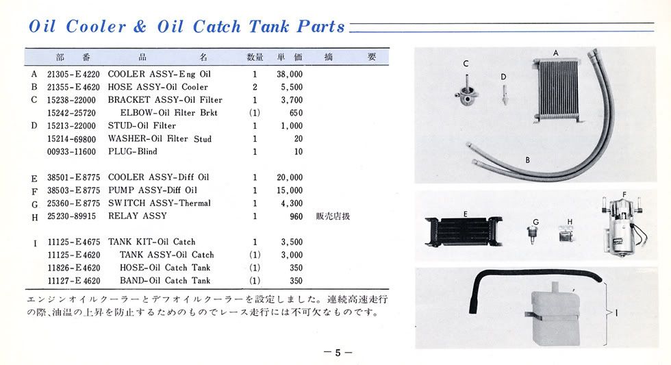

The stock oil cooler from the eurospec turbo is available from Courtesy nissan in Texas for $400. But the part number from the old works Rally prep catalog is not the same part number, though the pump looks identical.
http://www.courtesyparts.com/Merchant2/merchant.mvc?Screen=CTGY&Store_Code=CP&Category_Code=s30_nismo_diffoilcooler
I had Frank source one for JeffP, and Jeff took it all apart, cleaned it all up---this was form a used vehicle, and according to Jeff the inside was intact---basically he wasted his time taking it down.
These pupms are availble today as they are on all the GTR's as well. Current shopping in any Japanese junkyard should turn them up! LOL

That is some nice info Tony D... I forget to plow through the NISMO stock every now and then.. I pretty much wrote it all off long ago... over priced and understocked... but they do have some neat items still...
It would be nice to see some pictures/description of the internals of the stock pump if you have them available...
the NISMO pump is more than twice the cost of the tilton pump... the tilton pump also has affordable parts available...
The NISMO pump offers one HUGE advantage over the Tilton and others... It appears to be the only pump available that was designed for weatherproof, under-chassis mounting... The Tilton types have motor cooling fans... That usually means they should be placed in a protected location...
