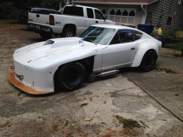

JMortensen Posted January 22, 2015 Author Share Posted January 22, 2015 (edited) On 1/22/2015 at 3:20 PM, Datz44 said: Awesome car!!! No words for your car's attitude. What size are the wheels and slicks? Take more pics of the whole car. Wheels are 15x14, slicks are 13" Hoosiers off of a Formula Atlantic. I've done most of the following projects here, so pics of almost all of this are available: finished fuel cell install with new hard lines dual master mod brake plumbing JSK brakes install bought Austin Hoke's Corvette brake setup and used Superlites with it Hoke Performance caliper bracket whole lotta roll cage IMSA rear flares custom AL dash rewire car - Dave Irwin did this 3 lb battery tail light panel 5.3L/T56 motor/trans mounts flexplate and dual 7.25 clutch Accusump rear control arm droop limiters remove front fenderwells Beta Motorsports hatch and hood coneeng.com mufflers and merge collectors Schoenfeld IMCA headers morphed into DIY side pipes laid radiator down and ducted to front tube frame detachable front end Woodward ps rack right and left side window nets modded sway bars braced front strut housing to spindle Ron Tyler diff mount 39 spline chromoly stub axles and companion flanges modded Harbor Freight tire mounting tool for the slicks made lexan door windows with slider for driver's side What I still need to do: DIY defroster from NASCAR brake fan Finish wiring (windshield wiper is the big thing) glue in windshield make lexan 1/4 windows install doors and seat(s) mod another front swaybar - kinda messed up the one I have on the car right now. Finish gigantic front splitter Finish front end/fenders Edited January 22, 2015 by JMortensen Quote Link to comment Share on other sites More sharing options...

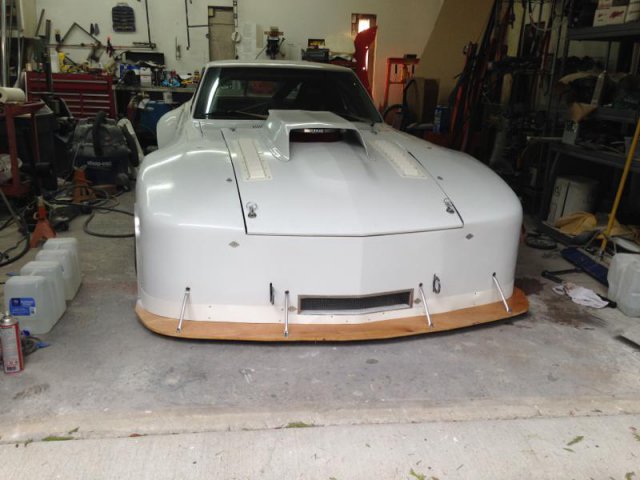

JMortensen Posted September 7, 2015 Author Share Posted September 7, 2015 (edited) Well, I drove it a little bit. It's definitely not a street car, that's for sure, but it does seem like it will keep me busy learning it for a while. Very fast, very twitchy. Intended to autox today, but believe it or not, it's about 1.5" too wide to fit on the trailer with the 14" wheels. When I had measured before I measured between the fenders, but when the bed tilts down there is a little frame rail that sticks out, and I can't get the tires past them. Will need another set of wheels and tires just to get it on and off. Thinking about doing 15x10s and putting rains on them. I can get 15x14 rains too, but I think the 10s might are probably a better choice anyway, even if it looks a little stupid on the car, plus I wouldn't need a 3rd set of wheels/tires. Also found that it high centers coming in and out of my shop and I had a (used) Hyperco spring fail on the first drive. Just went soft. I guess next step is get some 15x10s and raise it up enough so that I can drive it in and out of the shop. Edited September 8, 2015 by JMortensen Quote Link to comment Share on other sites More sharing options...
