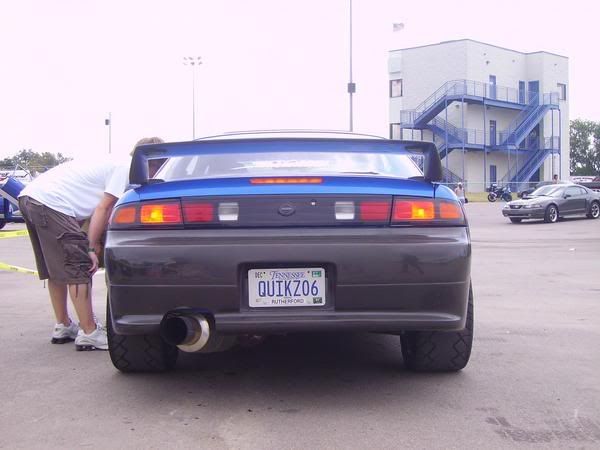

underground Posted January 13, 2008 Author Share Posted January 13, 2008 New Finished Shots of the Exterior/Wheels... Quote Link to comment Share on other sites More sharing options...
Careless Posted January 13, 2008 Share Posted January 13, 2008 what's with the bumper mismatch and the funky offset for the back wheels. Quote Link to comment Share on other sites More sharing options...
RB26powered74zcar Posted January 14, 2008 Share Posted January 14, 2008 I smell a ebay ad coming next.... Quote Link to comment Share on other sites More sharing options...
underground Posted January 14, 2008 Author Share Posted January 14, 2008 what's with the bumper mismatch and the funky offset for the back wheels. The whole car used to be carbon fiber two-tone, but then I ordered a Cwest Full Body Kit to change the look of the car. (Had been shot for a few magazines, and I wanted to update the look to get back into more magazines for 2007.) Well, the container showed up and the rear bumper was missing. I ended up keeping the carbon rear, and decided to eventually paint it. I just have not done so yet, but may in time, who knows. In regards to the wheels, what's the issue? They are 18x10 with a 295/35/18 tire. On a 240SX with a factory 6.5" (205/55/16) wide wheel, there is going to be some overhang. Quote Link to comment Share on other sites More sharing options...
