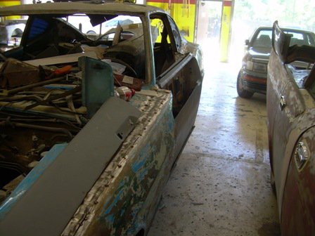

G.I.jonas Posted April 8, 2007 Author Share Posted April 8, 2007 Well i did some work lately on my body and have some pics to prove it.I completed the driver side of the metal work and started doing some of the fun stuff.I decided to use a foam core of sandable foam to make my door flares to blend in with my newly widened quarters.Basically layered 4 pieces of foam with adhesive cut the block to conform with the door,glued it on and then started trimming and sanding until it was close enough to glass over.Now it is just a matter of body filler and a lot of sanding.I was initially worried about the door handle but now i really like the cutout in the flare to accomidate it.Keep in mind this is just the first few stages and things will get a little more detailed as time goes on,i also havnt started with the rocker panel yet which is going to follow about the same contour and taper towards the front,should be easy enough for you all to visualize.Now i cant wait to get 5 lug hubs and new huge wheels to see how its really going to look,man i love body work:biggrin: ..enjoy Quote Link to comment Share on other sites More sharing options...

mario_82_ZXT Posted April 10, 2007 Share Posted April 10, 2007 That looks great! What are your plans for the rear? You should put a fuel cell and mount it so that there is enough space for a diffuser! Mario Quote Link to comment Share on other sites More sharing options...
VinhZXT Posted April 10, 2007 Share Posted April 10, 2007 Looking very good so far. I found chicken net is much easier to work with instead of foam. Something for you to think about and try it out. Good luck. I am attaching a couple pictures of my rear quarter panel and my dash that used the chicken net to build the structures. The foam will take a lot longer time to build compare to the chicken net IMO. Quote Link to comment Share on other sites More sharing options...

Guest hungy240 Posted April 20, 2007 Share Posted April 20, 2007 R u going to do anything to the front fenders or keep it the way it is? the foam on the door is pretty slick i like it. i have been doing something similar to my 71z. i am glade to c someone else doing something like this also. i am about half way into the fabing and welding and cant wait to get to doing body work on it. i got a few old pics of my project here havent got a chance to get new pics from phone Quote Link to comment Share on other sites More sharing options...
G.I.jonas Posted April 20, 2007 Author Share Posted April 20, 2007 Wow!! thats weird your pic of the rear in progress gives me deja vu bigtime,looks like you must be running 3" wider as well,in fact just by the pics i know that you are,maybe 3.5"?.I was initially going to do something with the front just as you are,but with the fenders mocked up i really kind of like it as is,at this point im thinking im just going to go with some flares for the front actually and spare myself the pain of all the other work ive already been through while gaining room for big meats as well:grin: .I have got my rockers blended in and done most of the body work on one side.Altogether i am really loving how it is coming together,im just bothered by the fact that i dont have my big wheels and tires on yet,instead i have to visualize it while looking at my 14x6's or whatever they are lol. Yay,its my mini muscle car. Quote Link to comment Share on other sites More sharing options...
