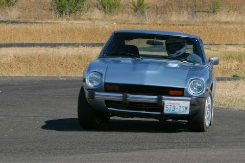

Bartman Posted June 26, 2007 Author Share Posted June 26, 2007 Here's a pic from last weekend: I am not crossed up in this picture and it's from the front. You can see I'm still leaning quite a bit. So here's my plans so far: I have the sway bars on order through Summit (they're on backorder though) I'm in the process of getting wider rims and stickier rubber. I'm going to install Bad Dog Framerails (I've already received them). After I get everything done above I need to adjust some toe in and camber on the rear. I think I already have what I need to do that with adjustable lower control arms and eccentric bushing already installed. I also need to get some camber plates for the front to allow adjustment on the front as well. Does it sound like I have the bases covered? Edit: One more thing; Im thinking of moving the 225 lb. springs from the back to the front and installing 250 lb. springs on the back. Quote Link to comment Share on other sites More sharing options...
Clifton Posted June 26, 2007 Share Posted June 26, 2007 I would try the bars first before swapping springs. I would then only swap the springs around if it has too much push, assuming the camber is set were it needs to be for optimum traction. Quote Link to comment Share on other sites More sharing options...
tube80z Posted June 27, 2007 Share Posted June 27, 2007 Bartman said: Here's a pic from last weekend: I am not crossed up in this picture and it's from the front. You can see I'm still leaning quite a bit. Here's a pic from a friends car. It has a one inch front swaybar and is at maximum turn-in. Based on this I'd say go for swaybars first then see what it looks like. He's running stock springs BTW. Why are you trying to climb into the passenger seat C Quote Link to comment Share on other sites More sharing options...
