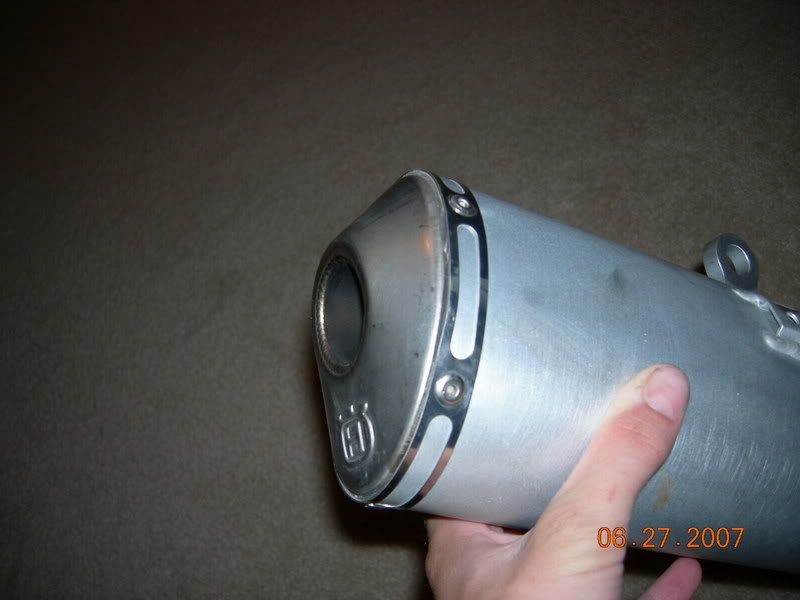

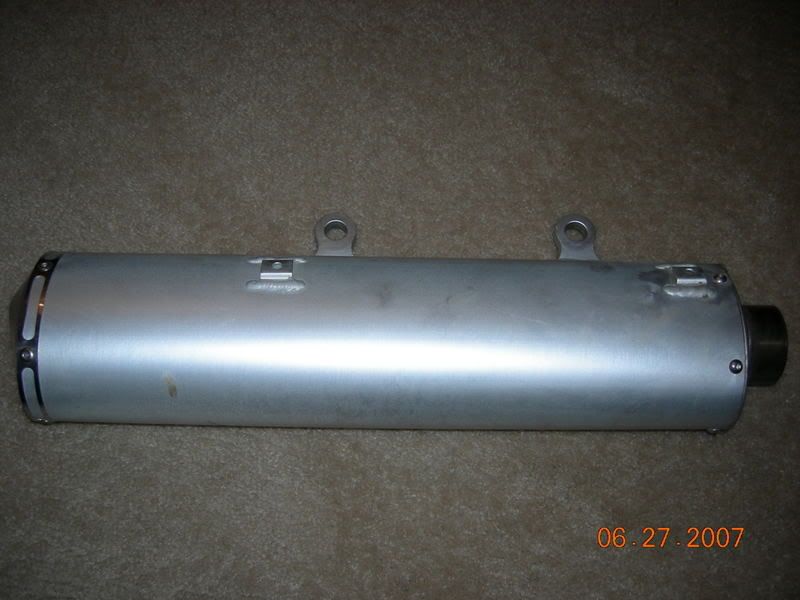

Jeremy82zx Posted June 28, 2007 Share Posted June 28, 2007 It is the quiet exhaust off of a 2004 husqvarna tc450 dirtbike. Since i have the loud exhaust on my bike, I plan on putting this on my 280zx tommorrow just to see how it sounds. Has anyone else tried this? Quote Link to comment Share on other sites More sharing options...

Jeremy82zx Posted June 28, 2007 Author Share Posted June 28, 2007 oh ya its a 2 inch inlet and about 1 1/4 inch out Quote Link to comment Share on other sites More sharing options...
