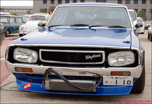

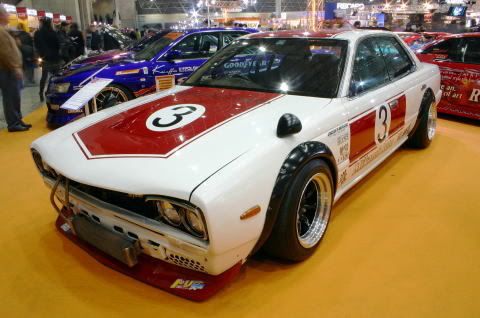

Guest 280ZForce Posted October 14, 2007 Share Posted October 14, 2007 you know Yasin we could always go jdm style racing on this thought... But tidier and better looking than this... Quote Link to comment Share on other sites More sharing options...

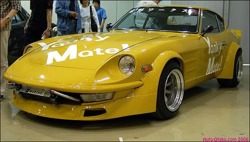

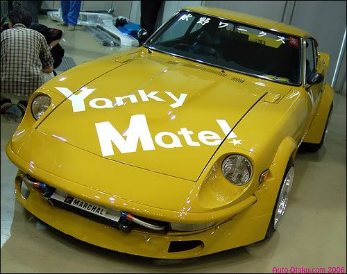

Guest 280ZForce Posted October 14, 2007 Share Posted October 14, 2007 Or even though we don't have a gnose, maybe something like this... Quote Link to comment Share on other sites More sharing options...

slownrusty Posted October 15, 2007 Author Share Posted October 15, 2007 Justin - Yup you are right...not much room to work with....I like Helix's solution too....mounting the oil cooler outside of the car is not overly appealing but definitely classik ole skool JDM look! Yasin Quote Link to comment Share on other sites More sharing options...
