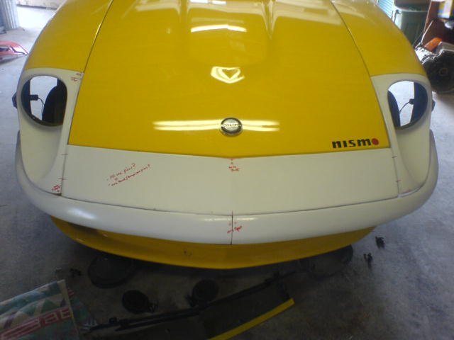

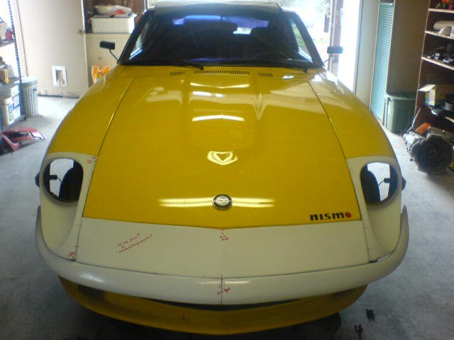

I plan on running #3 with Paulo's lower air dam. It doesn't look too great in that picture, is it possible to Photoshop the #3 option onto the head on photo like the first example (I am not PS savy)? After looking at my Gnose upper and Paulo's lower I think I can make it work just fine, if I remember correctly though the valance mount points do not match up flawlessly though.
Well I like the #1 edit the best... It just looks warped because of it being photoshopped.. i think if it was on a car it would look alot different. #3 would be better if it didnt have the liscense plate holder and had a bigger opening for an intercooler... #2.. ahhh dont really like this one in any way..
Its basically want kind of style you like... #1-more of a modern super gt look.. #3-more of a retro look... dont know what to say about #2

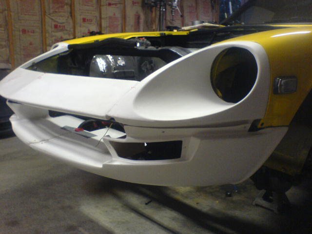

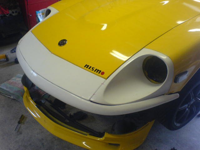

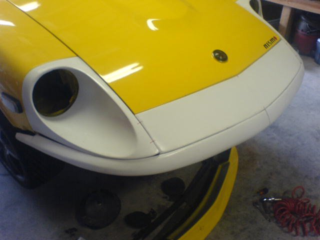

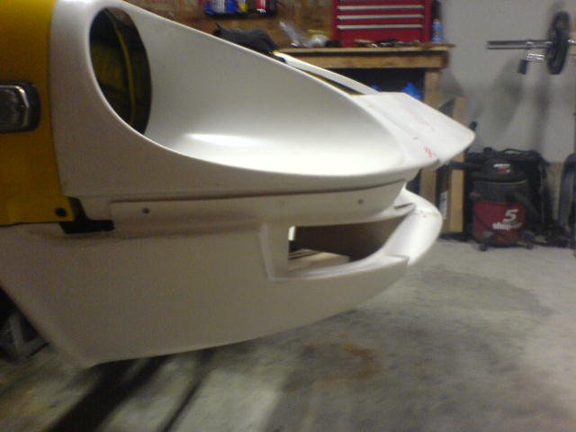

Well, since i had my motor out of my car and some time, I started going over the kit and install. I did find a few things i'm going to change on fitting.

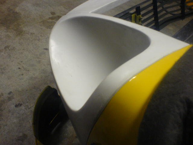

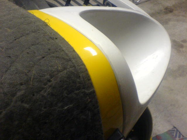

I did notice these changes I'm going to make:
  • the inner mounting flanges on the light buckets required trimming to clear the back frame where the light bolt up. I'll have the flange molded slightly shortler and rounded.
  • The inner flange that sits in the engine bay side needs to be slightly longer.
Otherwise so far, the fit is surprisingly nice!
I've attached photo's.
  • 2 weeks later...
Looks OK, but does not flow with the rest of the design as others have mentioned. The bottom two photo look great. The bottom one looks like it flows the best with the rest of the G-nose design.

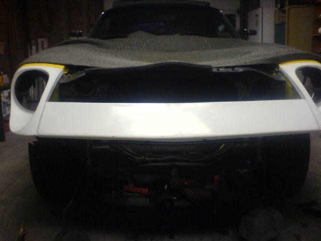

Well, I'm very excited after meeting with my composite's design guytoday. He too was loving the kit, and is excited to make it happen!!
So what we came up with is the following:
Hand laid production from a mold ( of course ) will be the easiest. We are going to use cross weave layer's unlike the original, which is just liad mat, single direction. This will result in a much stronger product while keeping the weight down.

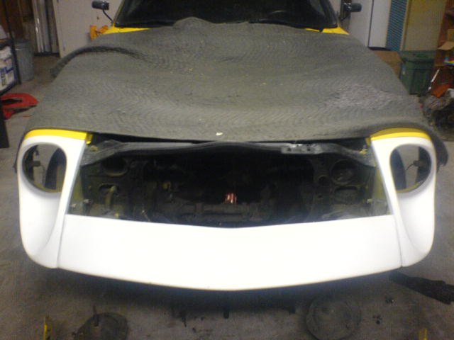

The hardest part in fitting the kit has been getting the bumper to fit correctly around the headlight bezels. To rectify this, we are going to make two parts to the kit... A top half and a bottom half. This will allow for a much better, NO HASSLE fitment of the top section. Once we have the top section completed, we will be test fitting. It will be a much stiffer and waAAYYY easier mounting process.
NOW>> for the big new's.. the bottom half is going to get MODIFEID!! We are going to basicly make the #3 picture of the airdam that everyone likes so much, come to be!!:mrgreen:
It should be awesome when finished... I'm hoping to have the top section complete in the next 2-3 weeks.

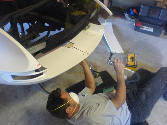

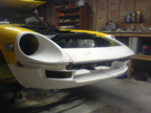

So the lower chin is on the car as well.. Actually the most work was with the upper sections. The bottom went on and looks very good with little work.
As for the composite company.....First composite company I looked at turned out to be a bunch of flakes. So after doing some further inquiring, I had another company come out and take a look at the project.
I've decided to make the first molds of the stock kit w/ no mods. I've had alot of people inquire about the kit as is. Once I have the initial kit out, I'll work on making a different chin spoiler for it.
I hope to have work biggining this next week. As I get further progress I'll post updates. I plan on taking photo's the whole of the process, so it should be really cool to see it take shape.

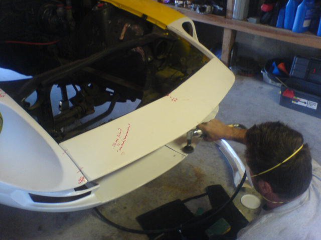

Update on the Gnose:
Made allot of headway on the plug today for the mold. The composites company showed up early, and we trimmed and glassed a few things into position. We should begin mold construction by next week. I'm hoping that I will have our first production part made by early next month. Once all fitments and quality is checked and approved, I'll be taking deposits for orders.
The kit will be available in both CF and FG............. Soon after if response is good with the kit, I plan on making a more aggressive "bolt-on" front air-dam, and maybe a version with a variance to the upper nose.
I'll be keeping you informed, so stay tuned!!!
