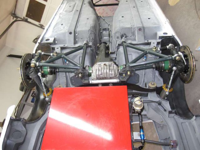

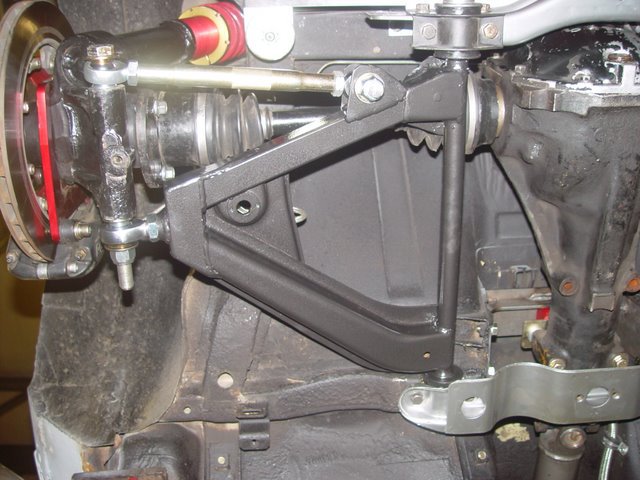

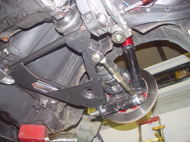

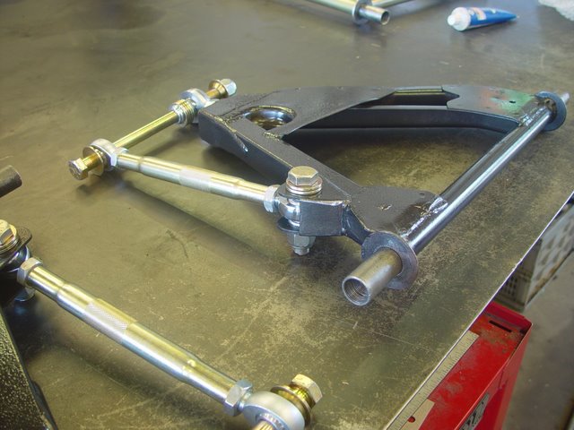

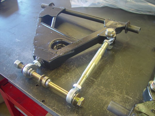

Attached are some pics or our interpretation of the new rear control arm. These were built out pf parts recycled from the previous control arm thread that Jon started where rod ends replaced the outer rubber bushings.
Two things were immediately apparent when putting these on. It was much easier to get them bolted up and the strut aligned with the camber plate with no fuss. It was one of those why didn't we do this a long time ago moments. And I should also mention that aligning for rear toe is now very simple.
These are mounted on the back of Dave Kipperman's LS2 powered autox car. We gave them a bunch of abuse this past weekend with no issues attributed to the arms. We had a record heat wave move through our area so any plans for a back to back comparison were thrown out and at this point we're probably not motivated enough to revisit.
Cary
NOW you've hit the mark! My biggest concern in the current aftermarket designs (and even my own work) is the issue of maintaining an EXACT spacing between fixed heim joints. This design eliminates preloading on a spherical bearing that may be only a few thousanths off the dimension of the spindle pin boss. Kills me that such a simple concept evaded me.
