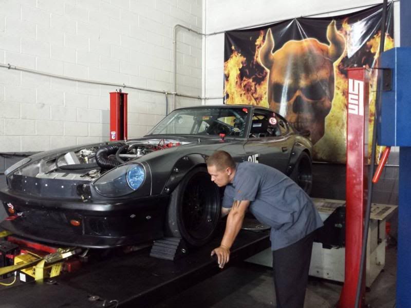

Mikelly Posted June 30, 2013 Author Share Posted June 30, 2013 Few pics from yesterday at the dyno. This was before we did a baseline with the low profile carb hat on the motor. This is one of their customer's cars. Headlight/electrical issue. Other than the rear deck spoiler, the car was bone stock and had a recent respray... still had that "old gas" smell... Great shape for a 78! Quote Link to comment Share on other sites More sharing options...
RebekahsZ Posted June 30, 2013 Share Posted June 30, 2013 Could that scary poster behind your car be one of the "gremlins" you have been fighting? Glad you have that behind you! Quote Link to comment Share on other sites More sharing options...

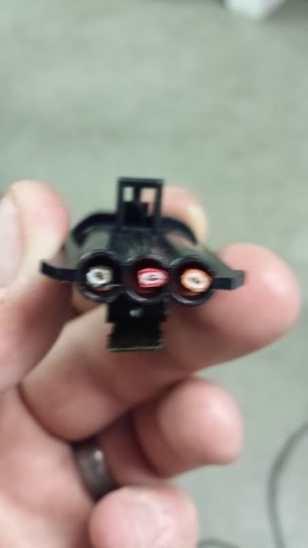

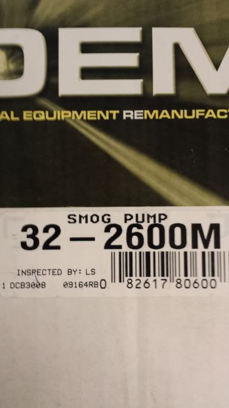

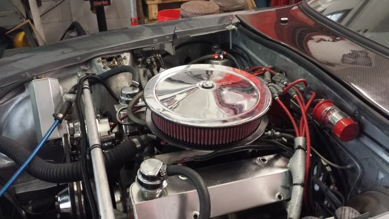

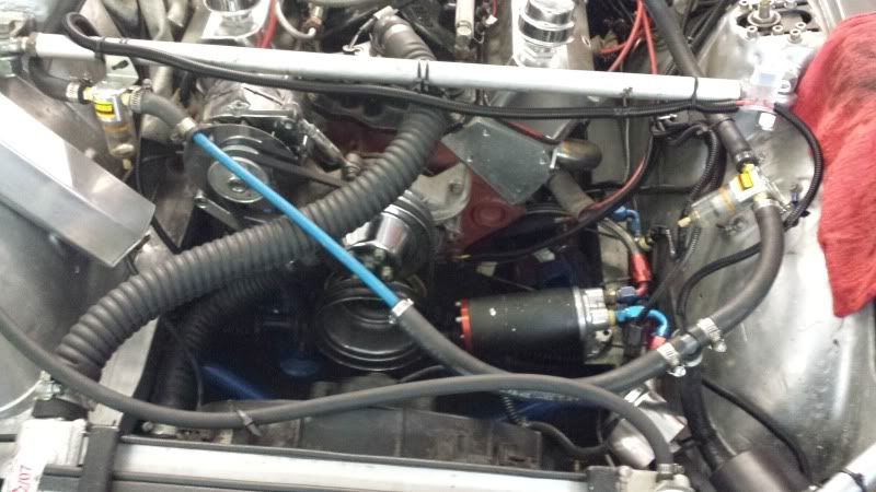

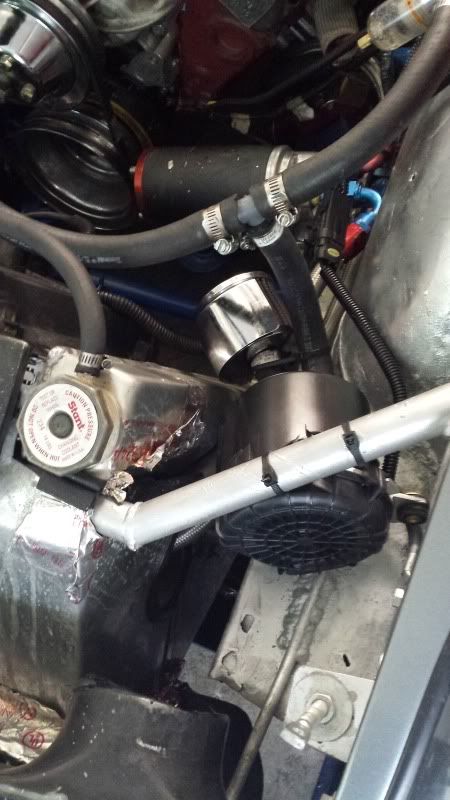

Mikelly Posted June 30, 2013 Author Share Posted June 30, 2013 (edited) So here is what I did to resolve the issues with air cleaner and crank pressure when we decided to ditch the setup I had. First I bought this part number which is a smog air pump for a 1998 LS1 Camaro: Next I checked the wiring and found one ground (black), one wire to open the suction port (red), and one to spin the blower up (Orange): Then I soldered, shrinkwrapped, and made a harness with a 15 amp inline fuse for the setup. I plumbed the air-oil separators to the unit and the unit vents with a K&N breather filter: I also installed the air cleaner base/filter/top: I will get to try it all out this coming week at VIR with Chin Motorsports! Edited June 30, 2013 by Mikelly Quote Link to comment Share on other sites More sharing options...

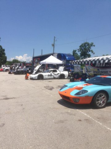

Mikelly Posted July 3, 2013 Author Share Posted July 3, 2013 Low low turnout so far... Less than 50 cars total, but of those, 2 Ferrari 458 racecars. Matt, We met up with the guys from Canada. I volunteered to do ride-alongs tomorrow. So I am on the phone with Matt, Driving 55 mph in my diesel rig hauling my trailer in the heaviest rain I have seen in a while... I see out of the corner of my eye a tree falling, I am talking at that moment with Matt about the sad footnote of another tree falling, that tree being OAKTREE at T12 VIR. The tree I am worried about falls down an embankment and somehow my trailer and truck miss it as it falls into the highway behind me, somewhere on the Rt29 bipass around LInchburg, Va. Sorry to those following in the blinding rain, because someone probably hit that tree behind me... Going to be an interesting two days. My student has an S2000, and My car has only slicks and no wiper assembly. I hope like hell it dries out!!! Mike Quote Link to comment Share on other sites More sharing options...
cobramatt Posted July 3, 2013 Share Posted July 3, 2013 Mike, If one of those 458 Challenge cars is white and a husband and wife team driving it.......................Beautiful car (and trailer and toter) just make sure to flash your lights when your on their bumper as none of their mirrors seem to work. My Canadian friends are very nice and good drivers. I was hoping that Mike in his red 86 would somehow get you as an instructor and he could make headway getting your input, like we did at RA, over his compadres that thought an instructor was not needed. Please be sure to tell them hello from me. I checked the forecast and it looks like all you really need to watch out for is falling trees. Quote Link to comment Share on other sites More sharing options...

Mikelly Posted July 3, 2013 Author Share Posted July 3, 2013 (edited) Sidelined, yet again. Crank case pump blew a fuse pushing oil out of the motor, filling it with smoke and something associated with the starter quit working. Car had to be towed in. Frustration is an understatement. Goddamn I miss my Porsche. Mike Edited July 3, 2013 by Mikelly Quote Link to comment Share on other sites More sharing options...
ZT-R Posted July 4, 2013 Share Posted July 4, 2013 Its always something my friend. Quote Link to comment Share on other sites More sharing options...
pparaska Posted July 4, 2013 Share Posted July 4, 2013 Really sorry to hear that. Electrical gremlins ugh. Double down on the wiring. Was that a new pump a new piece? Quote Link to comment Share on other sites More sharing options...
Mikelly Posted July 4, 2013 Author Share Posted July 4, 2013 Brand new everything. Two wire, one to ground, one to power with an inline fuse. Nothing sophisticated. I am beginning to think it is time to cut bate. This "rod" doesn't want to fish, it seems. Actively shopping track cars right now. Quote Link to comment Share on other sites More sharing options...
