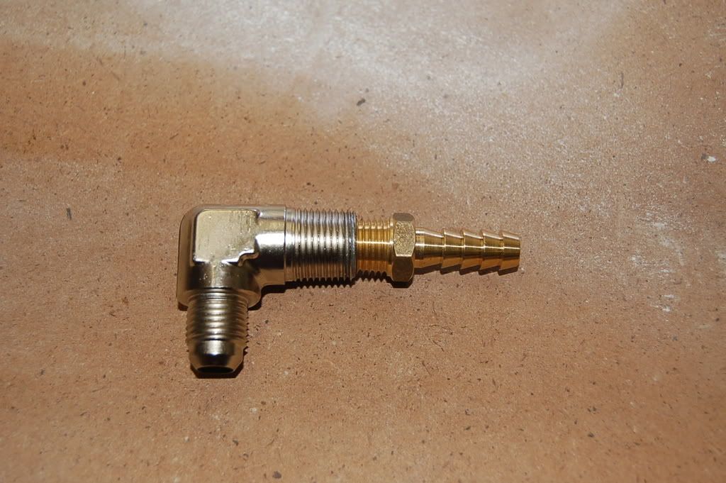

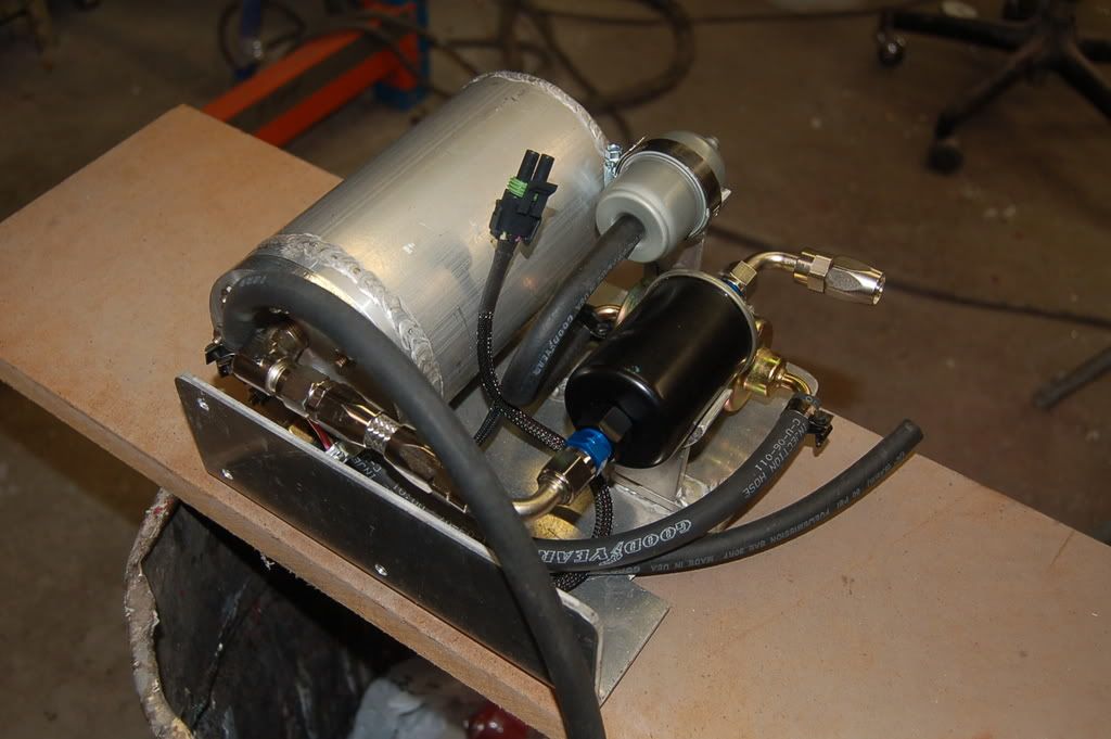

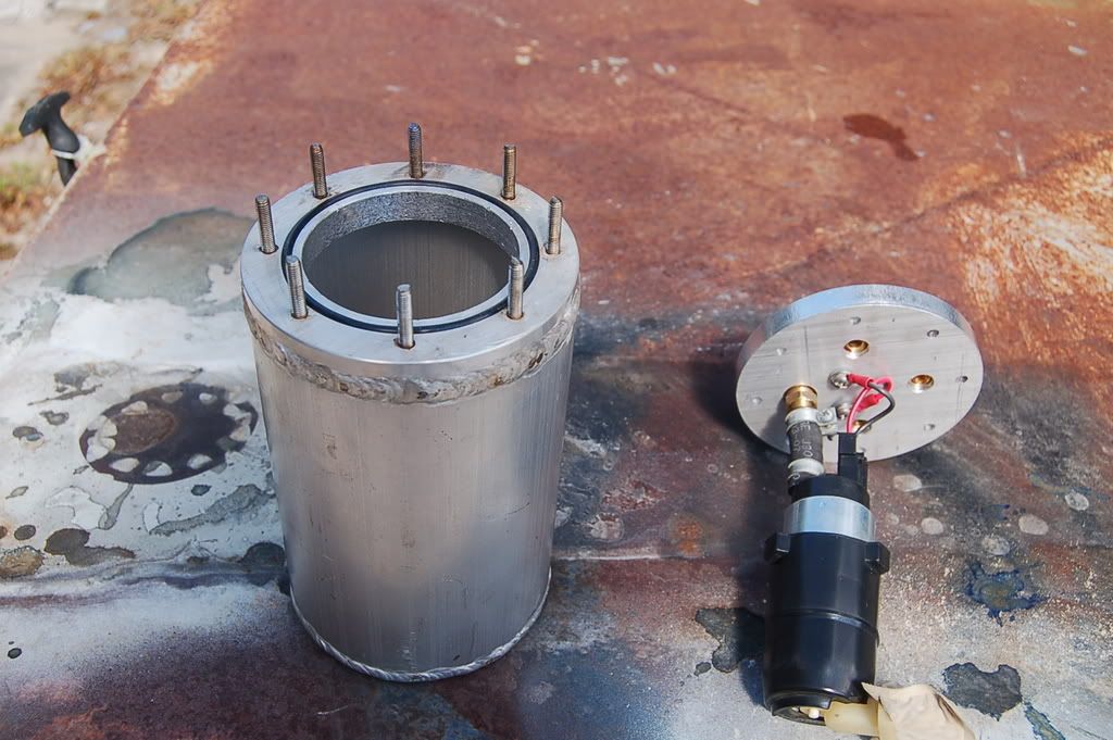

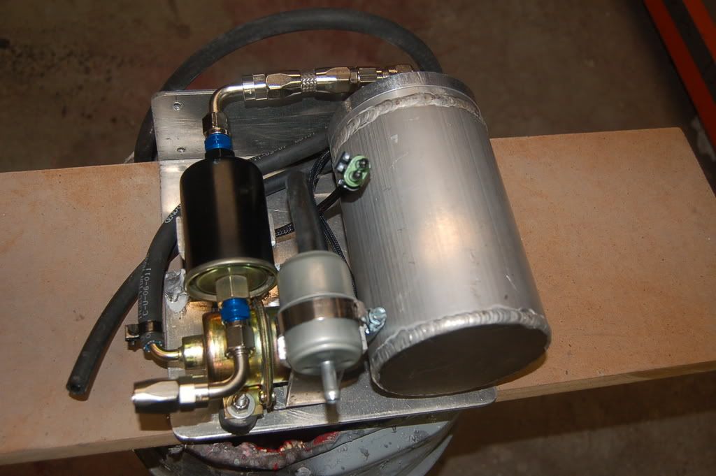

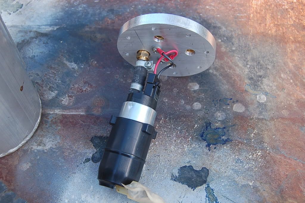

Derek Posted February 12, 2009 Author Share Posted February 12, 2009 I have to install the bulkhead and then the tank and high pressure filter so I'm missing some clamps. RX7 lift pump into tank with Walbro in tank pump. Ok the welds could be a little better but I haven't done any serious tig welding in a year or more. No leaks though! I made a hybrid fitting for the high pressure side. I took a 6AN elbow and drilled and taped it to 1/4 pipe. This makes for a nice connection in the surge tank. Yes the terminal screws are insulated. Believe it or not it all fits back there. Derek Quote Link to comment Share on other sites More sharing options...

Pharaohabq Posted February 12, 2009 Share Posted February 12, 2009 Oh wow it's tomorrow already. Did you take today off to work on it? I've been waiting long hours for this day. How long has it been since you started? It's very impressive when you think about the amount of work you've actually accomplished. That Surge tank looks awesome, Are you expecting someone to be shooting at it? It looks like it's bulletproof. n your welds, well they're a lot better than mine so don't worry about it. Very nice work as usual. We're all waiting for you to turn the key... Oh, we could see those girls really dug you, you're That Horney Z Guy. Good luck, here's hoping for a smooth startup and operation. I'm sure Daeron didn't mean anything by posting APOLLO 13!!!!?!?! Phar Quote Link to comment Share on other sites More sharing options...
