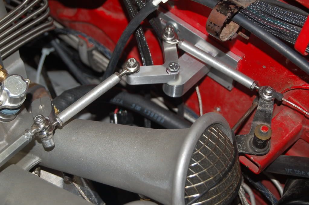

Well I had a break in my "limited" action today so I decided to take a stab at redoing my linkage. When I did the conversion I ended up using a cable. I really wanted to use rods and continue them from the existing bell crank to the manifold but time issues forced me to use the cable. The cable sucked. It was like a leg press getting it off idle and then it was normal the rest of the way. It was really hard to drive that way.
Here's what I ended up with.
DSC_0012.jpg?t=1237578566
Smooth as buttah!
What a difference. I ran out of hex stock so I'm temporarily using round. The cable on the factory bell crank goes to the cruise control. The bracket on the firewall bolts into the two holes from the pivot on the carbs.
I know I should be driving it from the center linkage instead of #6 and I still might when I redo the rods but I'm going to run it like this for while and see how it goes.

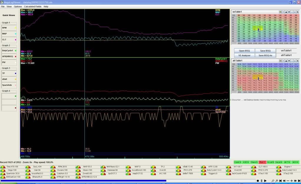

Derek, just a suggestion on tuning MS, turn off AE, Over-run fuel cut, MAT correction, etc when you do your datalogging. Even though Megalogviewer ignores records where those are active, you'll see artifacts show up on the edges of those settings, especially since MLV only works with a single fixed delay for the O2 sensor. In other words, it isn't always ingnoring the records that it needs to ignore.
If you turn those off and do a variety of driving (get data all over the map), you'll be pleasantly surprised with how well MLV will tune it. Once you're happy, then turn all the other gizmos back on. You'll find that you need very little AE too.
BTW, if you want to really fine tune, try using MLV in 2 passes. Here's a thread where we're discussing that with the developer: http://www.msefi.com/viewtopic.php?f=25&t=26021&sid=552c2dcfce598cd233369af0d77bfd92&p=212159#p212159

New linkage looks good. Pretty cool doing it w/ no cable. I guess that's one more bug worked out. Yah, I guess a longer hex tube to the middle would work better, but I think what you've got is fine, especially if there's no slop in the linkage.

Hi Daniel.
I was actually combing through your msq when you posted this.
I'm getting a much better handle on everything. I'm finding that it likes to be around 13.8 or richer when I'm cruising around. Any leaner and it just feels a little erratic. I can see where turning off the gizmos is helping. As I got my VE closer the AE suddenly became way too rich.
Making it run wide open is no problem. It's making it run while your lugging along in 3rd gear in traffic is the tough part! I went in and redid all my BINS to give me better resolution in the around town cruise areas.
Here's a screen shot of me in 4th gear at 2600 RPM. The MAP has some pulsing in it. I'm not sure if this is normal or not. Also you can see the injectors and voltage pulse right along with it. It's running rich.

Thanks Phar. It is so much nicer to drive as well. Also if I go into production it's a simple bolt on affair.
