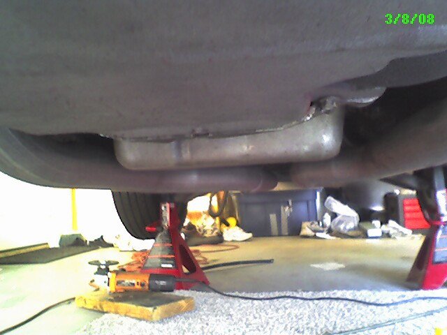

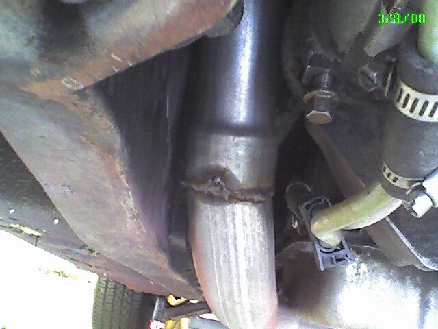

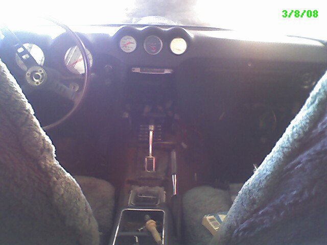

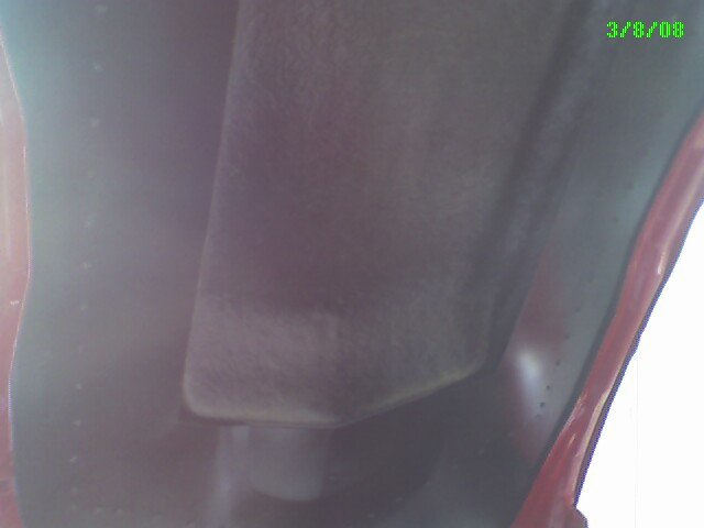

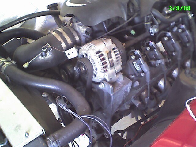

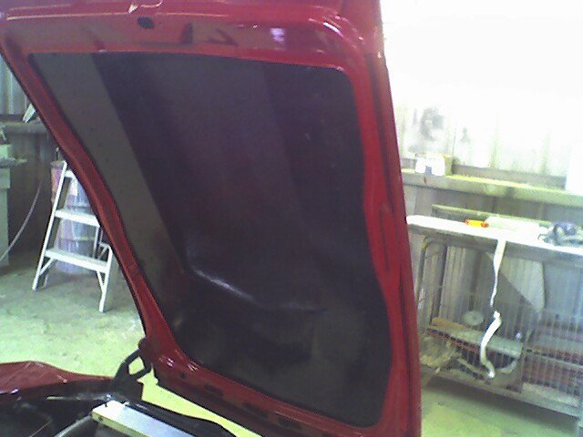

milesz Posted March 8, 2008 Share Posted March 8, 2008 As promised, I have included some pictures of the exhaust intake, mod transmission cooler, the Datsun 240z floor shifter and some others. Tell me what you think. This may not be the best way to go but its a way to go. Quote Link to comment Share on other sites More sharing options...

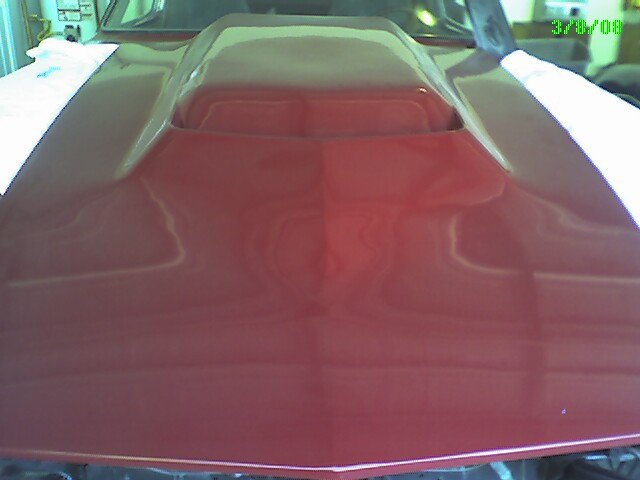

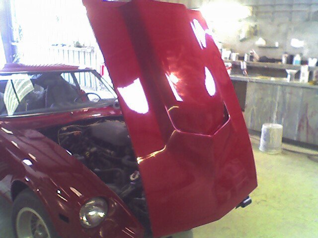

rytherwr Posted March 8, 2008 Share Posted March 8, 2008 That's great job, Miles, especially on the L88 type hood install. I know how hard that is because I did the same thing with some mods to clear the turbo's. Your project is an inspiration! Wayne Quote Link to comment Share on other sites More sharing options...

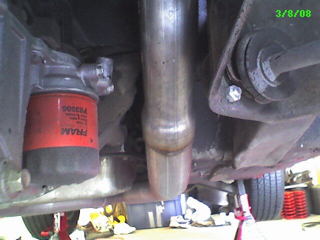

Pete84 Posted March 9, 2008 Share Posted March 9, 2008 Wow, that looks very clean! What all fit stock with the motor? Looks like the alternator fit in well enough. Looks like headers, did you try and see how the stock manifolds fit? Quote Link to comment Share on other sites More sharing options...
milesz Posted March 9, 2008 Author Share Posted March 9, 2008 That looks awesome, where in AZ do you live? when I get mine done, we definitely should cruise em' around together haha I live in Wickenburg and please send me some pictures of yours. Quote Link to comment Share on other sites More sharing options...
m1noel Posted March 11, 2008 Share Posted March 11, 2008 Miles, Very nice job on the swap, and the hood. I like it a lot. Mike Quote Link to comment Share on other sites More sharing options...
wrxand280z Posted March 12, 2008 Share Posted March 12, 2008 Great job getting the hood to work. Not my style but I give you Kudos. Also it looks like a starter bolt is loose. Quote Link to comment Share on other sites More sharing options...

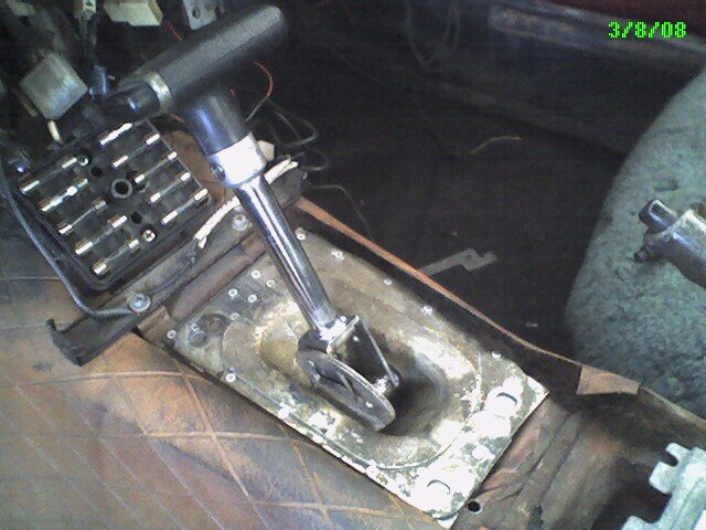

zgeezer Posted March 12, 2008 Share Posted March 12, 2008 Miles, What connection did you use between the Datsun Shifter and the A/T? I've moved the long lever under the car to the driver's side of the tunnel and am now considering connecting it to the stock a/t cable or fabricating a lever to engage the a/t. What did you do? Any other photos of under the car? g Quote Link to comment Share on other sites More sharing options...
milesz Posted March 12, 2008 Author Share Posted March 12, 2008 I did the same thing. I went to the local junkyard and got the linkage of an old Maxima. I will take a picture and post it. I wish the rod was a little longer but so far it seems to work. I will position the level on the transmission on top to make sure my gears are correct. After done I plan to post pictures of that too. Quote Link to comment Share on other sites More sharing options...
ZoomZoom Posted March 27, 2008 Share Posted March 27, 2008 Miles, props on the 5.3L swap! I'm assuming you're running a factory ECM... what did you do about getting rid of VATS? Did you buy a harness or modify a stock one? I may have found a deal on a 5.3/4l60e combo complete so we may have another 530Z here very soon Oh, and did I hear you say you used factory camaro exhaust manifolds instead of block hugger headers? Have any pics of how you modded them? Quote Link to comment Share on other sites More sharing options...
deja Posted March 27, 2008 Share Posted March 27, 2008 Very nice. Awesome job on the hood. I used the Z28 shifter on my LT1/4L60E swap. I cut out part of the tunnel to lower it some and am using the Z28 cable instead of using rods. Works great and only a tiny hole through the floor for the cable is needed. Quote Link to comment Share on other sites More sharing options...
milesz Posted March 28, 2008 Author Share Posted March 28, 2008 Miles, props on the 5.3L swap! I'm assuming you're running a factory ECM... what did you do about getting rid of VATS? Did you buy a harness or modify a stock one? I may have found a deal on a 5.3/4l60e combo complete so we may have another 530Z here very soon Oh, and did I hear you say you used factory camaro exhaust manifolds instead of block hugger headers? Have any pics of how you modded them? I sent the harness to then, LT1 Wiring now Engine Wiring but had to send it back and should be getting it soon. Tom seems to be a nice guy at Engine Wiring and know what he is doing; so send him you business if you need their services. They reprogramed the computer and mod the harness. Quote Link to comment Share on other sites More sharing options...
