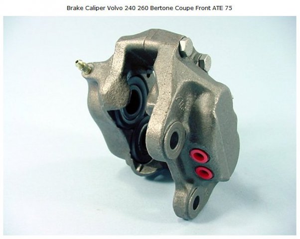

col Posted May 30, 2008 Share Posted May 30, 2008 Hi I'm thinking of fitting the volvo calipers that will bolt on.(260 2 seater) My question do the ones for the vented discs work and if so what disc do you use? Quote Link to comment Share on other sites More sharing options...

col Posted May 31, 2008 Author Share Posted May 31, 2008 No I haven't , I was down the wreckers to find the calipers, and found that there were both calipers for vented, and non vented discs. As people have said on the forum that the volvo calipers are bolt on , most people must use the non vented type. My Question was, do the vented type fit with a disc off something else? I have searched the forum and found nothing , but maby I am serching with the wrong titles. Is it a problem getting good pads for them? Thanks Col Quote Link to comment Share on other sites More sharing options...

col Posted June 4, 2008 Author Share Posted June 4, 2008 Thanks for the reply. I have found the volvo swap to be a comon swap for rally cars from 1600 ,right through to 240z. It is a money thing as there are better brakes.( really only the weight, as they are cast). But from what I can find . The non vented caliper has a bolt space of 76mm, same as a 1600 to 180b. With this strut you put the 280zx vented disc on, and the vented volvo caliper bolts straight up , easy 4 spot vented upgrade. Not so easy if you have the 90mm spacing, unless you are willing to go back and find 1600-180b struts to bolt in. I have been told some early 240z have the 76mm gap. Also if you don't wan't vented .There are non vented volvo calipers that just bolt on with standard non vented disc.(76mm) Quote Link to comment Share on other sites More sharing options...
col Posted June 6, 2008 Author Share Posted June 6, 2008 The volvo caliper fits on the 180b strut:) the caliper does not line up with a 280zx disc:sad: So I'm looking for a disc that has about 10-12mm less offset from the mounting bracket to the inner side of the disc. Quote Link to comment Share on other sites More sharing options...

col Posted June 6, 2008 Author Share Posted June 6, 2008 Ok then Richard what options are you talking about? I dont know of any other 4 spot calipers that bolt on except the hilux, and they are much more weight. Quote Link to comment Share on other sites More sharing options...
zcarnut Posted June 6, 2008 Share Posted June 6, 2008 I’ve looked into using the Volvo calipers on the S30 but the “dual feed†brake line requirement makes it more of a hassle than the Toyota calipers. But the Datsun Roadster guys are using them: http://www.311s.org/pmwiki-311/pmwiki.php?n=TechSection.VolvoCalipers Here in the USA, the Toyota calipers are just more common in the junk yards as well. Quote Link to comment Share on other sites More sharing options...

col Posted June 7, 2008 Author Share Posted June 7, 2008 Ok guys ,the caliper is heavy compared to alloy ones. The volvo is much more compact and lighter than the hilux. As far as the Technology in the new calipers, please let me know what you are talking about. A caliper that does not flex ,and has pistons and pads equal to another ,will slow the car exactly the same. The only technology, is in reducing weight and not getting too much flex. I do believe weight reduction especially unsprung, is important. But at the moment I would rather have better stoping power ,at the expense of handling. In the future I hope to get a set of brand name light calipers , just not now. To solve my problem at this moment is to find the disc with the least modification possible.So far the 280zx vented caliper with a spacer to push it back towards the strut or Magna verada, and get it machined.Possibly another disc. Thanks Quote Link to comment Share on other sites More sharing options...
