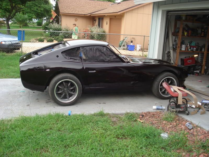

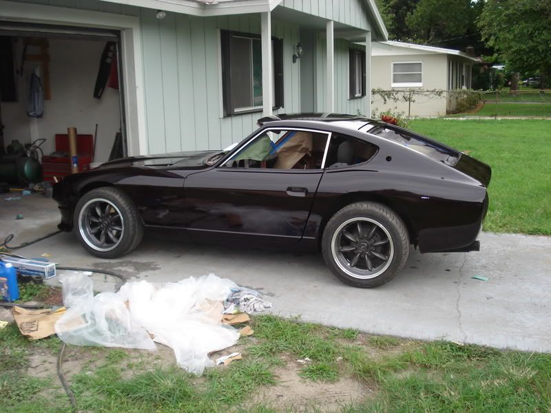

Well I got her painted today. Im decently pleased with how it came out considering its the first time ive shot a whole car.
Well Is got a big of debree in it. So it needs a wetsand and buff really bad. But ill have to do that later after i move. Well let me know what you think.

Yeah I know i have alot of work ahead of me but still glad i got it done. It wont be a show car its just my DD. Yes the flares and fender mirrors are going to be painted body color.
Yes Calgary280zt that is the same car that was painted in rustoleum. But i took the car down to metal so im not sure how much help i would be to ya unless you did the same.

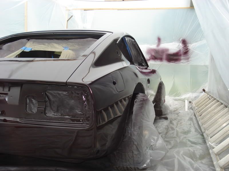

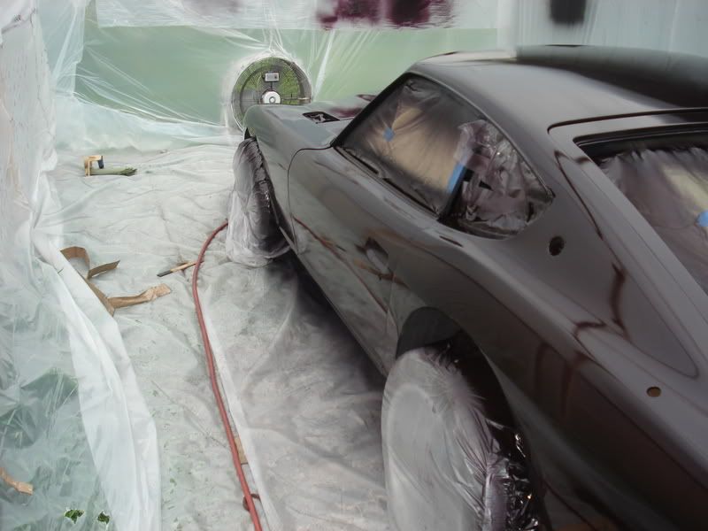

Yes that was an exhaust fan that honestly worked to well. When i completely closed up the booth it would suck the whole thing in. and that was with 4 huge filters on the back wall. So i had to keep the back wall open a bit so it would work and thats why i got so much debree on my paint. Wish i could of made it better but since a hurricane is going to come today i had to get it done. If your going to make one.
A) only buy the really thick plastic thats 6mil i think.
B) Make sure you put all your plastic on the outside of your frame. I tried to put some of it on the inside and then staple it and that didnt work.
Oh well live and learn and then learn to never do your own body work lol.
