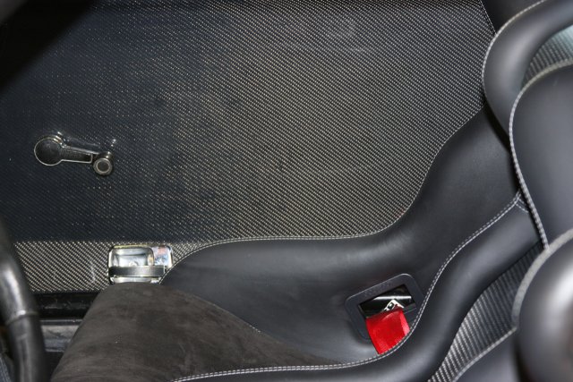

As I look at the panels, I see that these are really setup for more of a race-prepped interior. There are no provisions for the door handle or window crank. I am assuming that you've removed these on your car?
Tsk Tsk Tsk! Nothing a little work with a drill or RotoZip wouldn't solve.
Frankly, I like the "Blank" nature of the panels, because as someone with BOTH RHD and LHD vehicles, and knowing the panels are different between the two it would be nice to 'trim to fit as needed' a universal door panel, and not have tobodge together a patch for holes that are there that aren't used on one application or the other.
No, the picture is from the first set we created. We had not yet drilled for the door latch, window crank, and door handle. Those are just holes to drill. You can attach the stock parts just fine. I'll post a pic later of the parts installed.

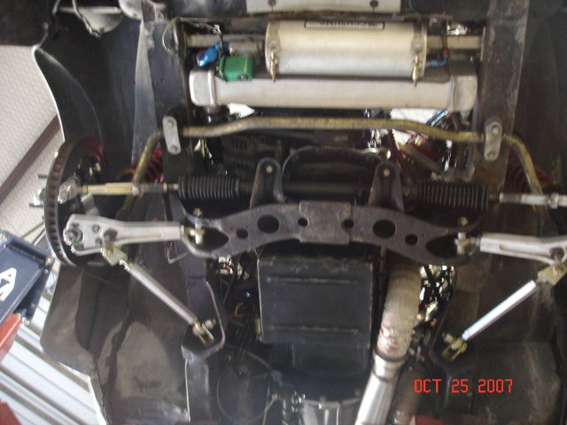

Can you take some photos of where you have your Accusump? I havent yet mounted mine, and would be interested in how you have done it.
thanks & regards
essentially it's mounted just under the intercooler which is normally where the radiator would be. The radiator sits just behind that. Not a great location but it works.
Hi Mark thanks for that.
Where did you plumb the accusump in? Between one of the lines that goes to the oil cooler or somewhere else? Does yours have the electric valve or manual?
