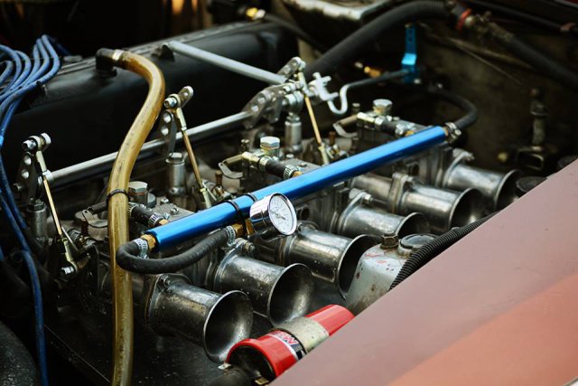

ryant67 Posted August 23, 2015 Share Posted August 23, 2015 Time to update, new engine in! Quote Link to comment Share on other sites More sharing options...
madkaw Posted August 24, 2015 Share Posted August 24, 2015 Very nice Ryan. With regards to the fuel routing subject- I am trying to figure yours out? Quote Link to comment Share on other sites More sharing options...
ryant67 Posted August 24, 2015 Share Posted August 24, 2015 On 8/24/2015 at 3:35 AM, madkaw said: Very nice Ryan. With regards to the fuel routing subject- I am trying to figure yours out? Oh, it's a mess... comes out at the stock location, runs up through the Holley regulator, through the system 1 fuel filter, then back along the frame rail to the fire wall, and up over the transmission to the carbs. One big old tour of the engine bay... That's a project for another day though, just happy to have the car back on the road after three months of no engine. Quote Link to comment Share on other sites More sharing options...
310z Posted August 25, 2015 Share Posted August 25, 2015 This might be easier, at least from the stock location across the fire wall. Quote Link to comment Share on other sites More sharing options...
