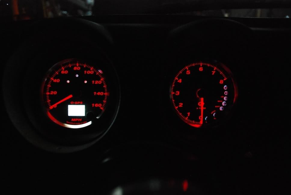

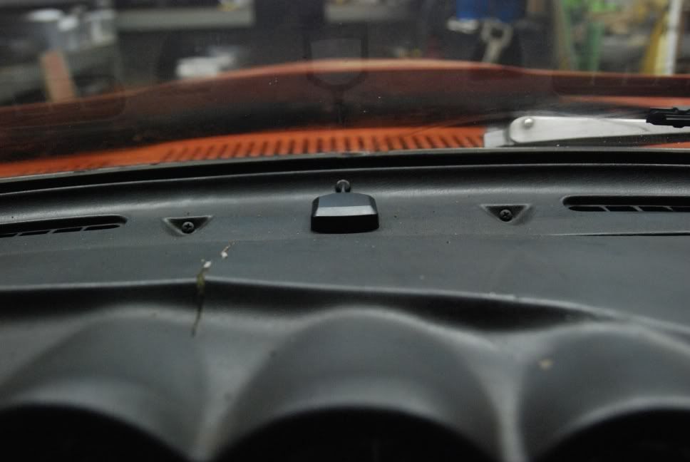

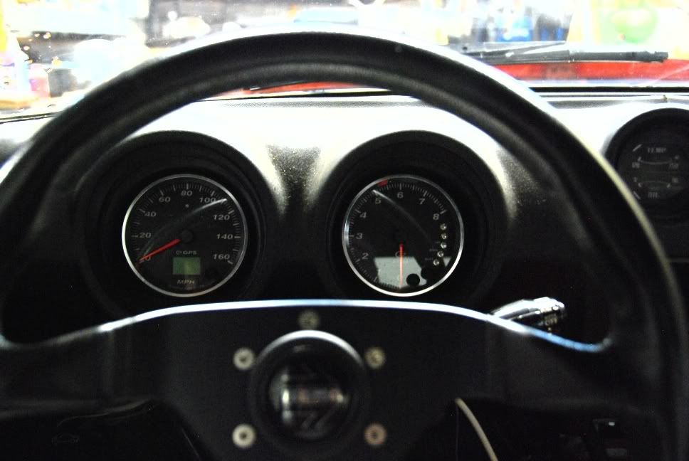

My stock tachometer had become sticky on the top end and the stock speedometer isn't readily adaptable to this conversion. Time for new gauges. I liked what I was seeing from Speedhut, so I rolled the dice. Conveniently, they build a GPS speedometer. Since there are no speed outputs on the ZF transmission (electric or mechanical), this made things easy...
GPS antenna...
Drove the car into town and ran a few errands. The speedo worked beautifully. Time will tell how well it works in more challenging conditions.

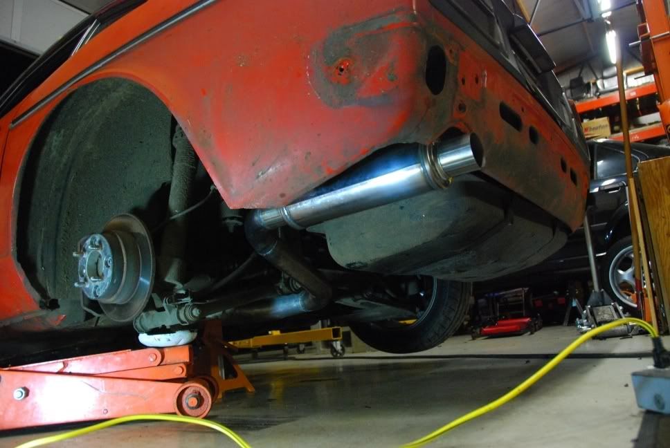

Finally wrapped up the exhaust. I added one more Magnaflow (2.5") in the stock location. This helped greatly with the resonances, but it's still too loud for my tastes. Great for a track car, but a little extreme for a daily driver. Excuse the filthy car. I'm guessing it's been over 2 years since it's been washed :oops:...
I took the car out for its first lengthy trip, 70 miles, highway and city, mountainous and flat. Not a single hiccup or fuss...

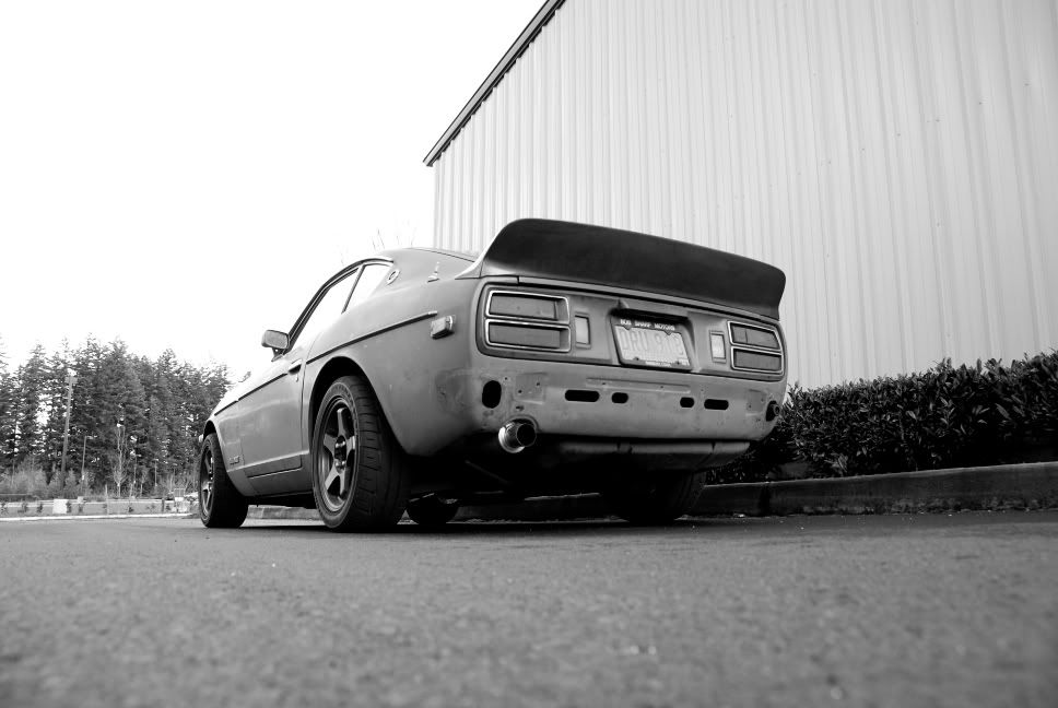

Lastly, Brian of Z Car Customs sent me one of his early ZG-R CF rear spoilers. It was a blem and priced accordingly, but it still looks pretty decent as-is. I'm not a huge fan of raw CF appendages on street cars, so the plan has always been to paint it. I'm very pleased with what I got. Thanks Brian!

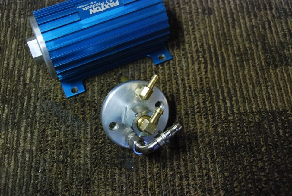

Speaking of which, I wasn't planning on posting anything until I had it fully wrapped it up, but we're here so...

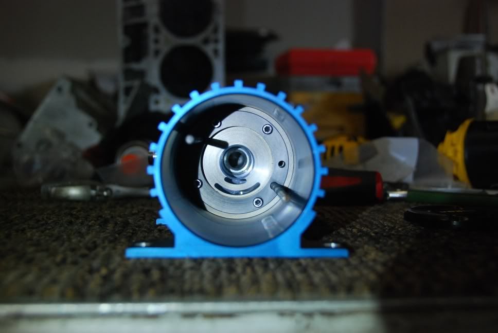

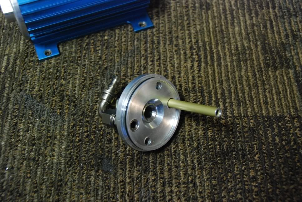

I've had this Paxton pump sitting on my shelf since '98 or '99. I was tempted to implement The Beast, but I needed to make sure it was still serviceable. I lubed it generously and fired it up... no go. Motor spun at a snails pace. Because I'm still twelve at heart, I decided it was of dire importance to dismantle. Lying on the bench in many piece's (beer in hand), it dawned on me that the housing was very usable as a surge tank. Without the motor and pump, it was still a fully sealed and maintenance friendly part. Slightly heavy, but... um.... free (I think :hs:). A little machining and a trip to Oil Filter Service of Portland, and...
It's tough to see in the last picture, but the plate at the bottom, is not actually the bottom. The large central hole drops down into another cavity about 1 1/2" tall.
Internal volume is approx. 1.25 pints. A Datsun pump will feed the 'Paxton' surge tank and a Bosch 044 pump will pull from the surge tank and pass the fuel to a C5 filter/regulator at 4 bar.
