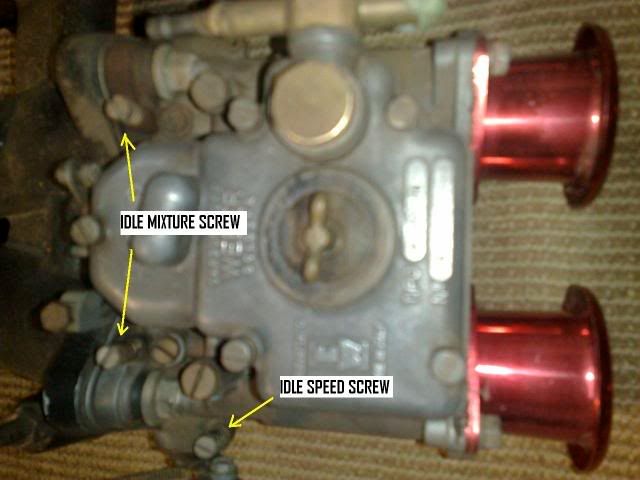

Ditch the uni-synch and get a real dial indicating synchrometer such as recommended and sold by Weber.
It doesn't restrict the flow to lift a piston, it uses an internal fan that rotates to move a dial and give you a reading on airflow.
You can leave it in place forever and the idle is not changed one bit. Can't do that with a uni-syn!
Idle synch is accomplished with the idle stop screws, and then linkage adjustment takes care of off-idle synchronisation. THEY ARE TWO DIFFERENT THINGS!
Gene Berg has a good article on bench-synching carbs for VW's, and since that was the way I was trained, that's the way I started. It really saves time when you start from scratch (like bying a set in a basket and have to assemble everything...)
Linkages are disconnected for idle synch. Then off idle synch is checked (hard as hell with a UNi-Synch, but child's play with the Weber Tool). Last check is to disconnect linkages individually while at idle to see if anythign changes.
