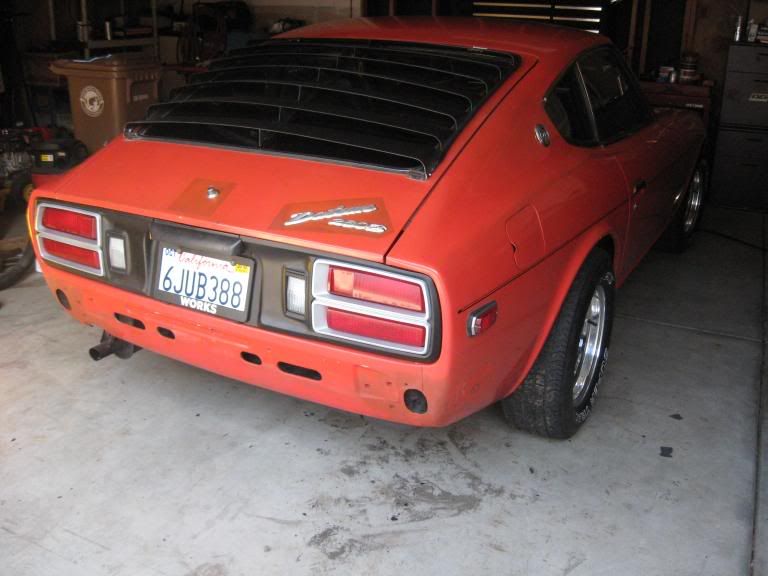

Here is a picture of the bumper support gone. You'll also notice the areas of rust removal and primer

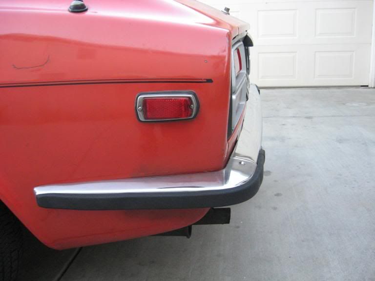

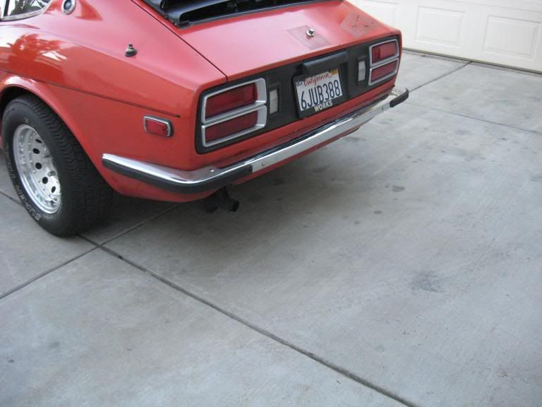

Rear bumper is on. Made some simple brackets - looks nice!

Here is something interesting for those suffering from bad exhaust smells:
Driving around with stock bumpers (75) I noticed some smell, not too bad.
With NO rear bumper I noticed LESS smell - hardly any.
With the thin (240z) bumpers and no spoiler I noticed TERRIBLE exhaust smell at about 35-40mph... it was bad!
After I added the spoiler the smell was greatly reduced again. About the same as no bumper or spoiler - not so bad at all for a catless car.
