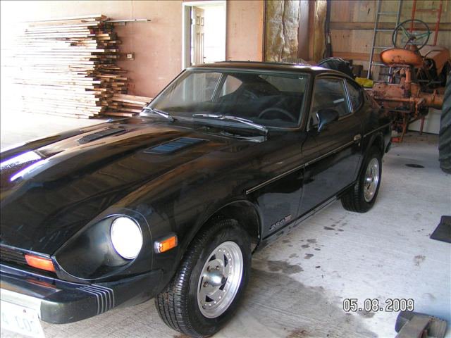

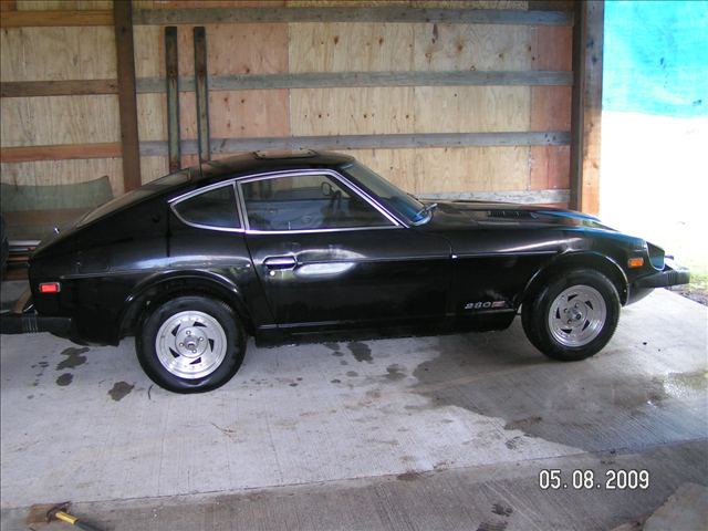

Okay so im going to go check out a 280z that has sat undercover for ten years. The guys says it has no rust although it was in a flood. he claims th insurance company totaled the car because of the flood.(went to bottom of doors) What does the salvaged title do? and can i knock the price down because of it. Also it has a dealer sunroof in itwhich looks good. Also what should i look for when i go look at it. where do sunroofs normally leak?

Well if it is just salvaged because of water damage then there no real problem with the car. It's not like the car was in a crash where it could have really messed the frame and chassis up. So I would say your good on this one, although, I would still really look well for rust. You should really inspect the rear hatch, floors, under the battery tray, and the frame rails for any sign of rust. Any rust can be fixed though, its just a matter of how far you will go in caring for it. You might be able to knock off some bones on the car because it does have a salvaged title on it. Like I mentioned, as long as there is no physical damage to the chassis you should be home free, it'll be a little more difficult to sell though. Not sure how insurance works with salvaged titles. As far as the sunroof, I'm not sure I can help you on that one, but see if there is any rust around it. And if it does leak, a little weather stripping should solve that.
EDIT: If the water just went to the bottom of the doors, you might want to replace the carpets because mold and mildew linger deep in the fabric. Ask him if it was drivable after the flood too, that could help a lot.

Insurance companies will cover the car. 280Z's did not come from the factory with sunroofs; yours must be aftermarket, and it decreases the value of the car to have it.

Flood cars typically have lots of wiring/electrical problems and tend to have more rust problems. Wheel bearings, hubs, transmissions, differentials, and steering racks can also be damaged.

That's what I was going to say, the car sat in water like that. It's gonna be rusty on the inside first and work its way out. get the carpet up a little if the owner will let you and look into the holes on the inside of the rockers. Flash lights in the fender areas. Stuff I wished I had done! It will most likely be an electrical nightmare.
