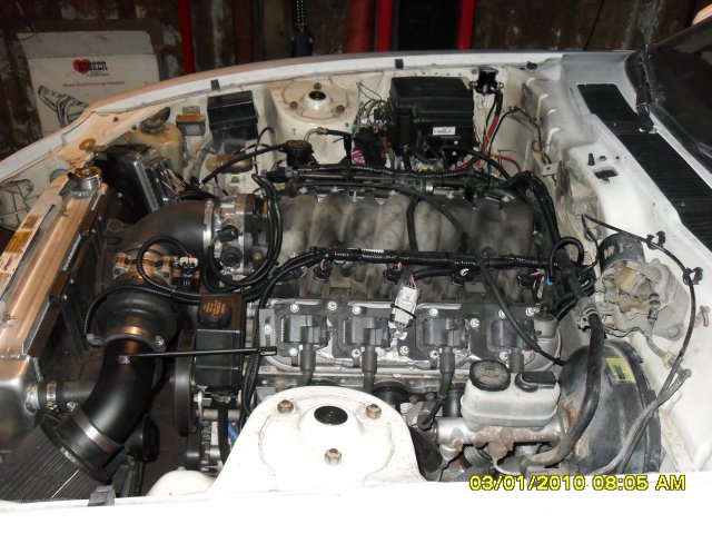

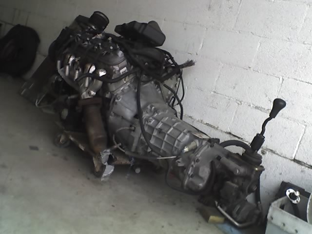

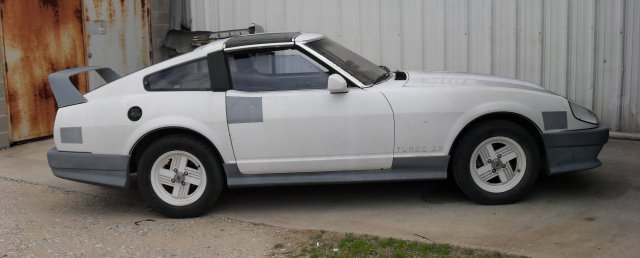

Domzs Posted May 6, 2010 Share Posted May 6, 2010 hi , my name is Dom , and kinda new to this . here are some pictures of my 83 turbo converted to ls1 with 6 spd. trans. and she is a on going project . Quote Link to comment Share on other sites More sharing options...
PurePontiacKid Posted May 6, 2010 Share Posted May 6, 2010 What kind of headers/exhaust manifolds are you running? Any clearance issues at all? a friend of mine wants to do the same swap in his car, so it's cool to know someone has knowledge of the swap Quote Link to comment Share on other sites More sharing options...
Domzs Posted May 6, 2010 Author Share Posted May 6, 2010 What kind of headers/exhaust manifolds are you running? Any clearance issues at all? a friend of mine wants to do the same swap in his car, so it's cool to know someone has knowledge of the swap it s not a fun project . i used blockhugger on pass. side and trans am shorty on driver side . mod. steering shaft . Quote Link to comment Share on other sites More sharing options...

260DET Posted May 7, 2010 Share Posted May 7, 2010 Want to resize the pics, big, eyes hurt That looks like a great fit, engine sits so low, what sump/pan are you using? For some reason or other I reckon thats the perfect engine for a S130, well done. Quote Link to comment Share on other sites More sharing options...
frank280zx Posted May 7, 2010 Share Posted May 7, 2010 Want to resize the pics, big, eyes hurt That looks like a great fit, engine sits so low, what sump/pan are you using? For some reason or other I reckon thats the perfect engine for a S130, well done. Looking foreward to see a vid of that ! Great build!! Quote Link to comment Share on other sites More sharing options...
Domzs Posted May 7, 2010 Author Share Posted May 7, 2010 (edited) I like the swap good luck on getting your project finished love to see it running when your done. got her running and street legal last month . she is a beast . i mod. trans am oil pan to clear the rack-n-pinion . engine and trans. fit perfect and the shifter sticks out at fact. location . Edited May 7, 2010 by Domzs Quote Link to comment Share on other sites More sharing options...

borini63 Posted May 8, 2010 Share Posted May 8, 2010 Did You used the same rear end? Quote Link to comment Share on other sites More sharing options...
Domzs Posted May 8, 2010 Author Share Posted May 8, 2010 (edited) Did You used the same rear end? yes . have enough z's ? never too many , right ? here is my other z , also have 84 300 zx turbo Edited May 8, 2010 by Domzs Quote Link to comment Share on other sites More sharing options...
kelltainer Posted May 10, 2010 Share Posted May 10, 2010 what are you going to do with your turbo engine and tranny? Quote Link to comment Share on other sites More sharing options...
Domzs Posted May 10, 2010 Author Share Posted May 10, 2010 what are you going to do with your turbo engine and tranny? dont know yet . thinking about buying another 280zx and use the trans. , it's a bw t5 . either sell the whole motor or part it out . Quote Link to comment Share on other sites More sharing options...
