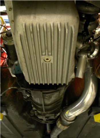

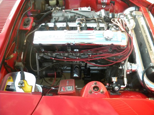

Ok so i had some time at work to gather a more pressent and accurate build sheet.
Power Fab Automotive
Performance-Fabraction-Matinance-Supply
Engine and Transmission:
- Carb Motor swapped with a 280zx Turbo FI motor (L28ET)
- New ARP Head studs
- New HKS Head gasket
- Holset HY-35 Turbocharger
- Megasquirt ECU Kit In custom panel in glovebox
- Greddy ProFect B II boost controller
- High Performance FPR
- New plugs and MSD performance wires
- MSD ignition
- Custom intercooler
- Custom Radiator
- Custom Fuel cell
- Custom cold air intake from turbo
- Custom 4 inch downpipe
- Many Chrome Engine Parts
- 300zx 5 speed transmission
- ACT 6 puck race clutch
- Optima Yellow Top Battery
- Tial BOV
- Tial Wastegate
Rollers, suspension, and brakes:
- 15×7 authentic Panasport Racing Wheels
- 225/60/15 Falken Tires (new)
- Wilwood 4 piston brakes (front and rear)
- Tokico Illumina Adjustable Shocks
- Eibach Lowering Springs
- Cusco Front Strut Bar
- All bushings replaced with polyurethane
- Susspension Techniquies Sways bar kit
- Z car custom JDM tow bars {installed today}
Interior:
- Autometer gauges everywhere (Tach, RPM, Fuel, Water Temp, Oil Press, Clock, Boost, etc, etc)
- Series 1 originel dash
- Nardi Leather 330mm Deepcorn Steering Wheel
- Momo Hub
- New Seat upholstry kit to original
- New roof liner
- New carpet
- New floormats
- Top Secret Shifter
Coming Soon:
-Takata racing harness's
-Cusco rear strut bar
-2400 polished vavle cover

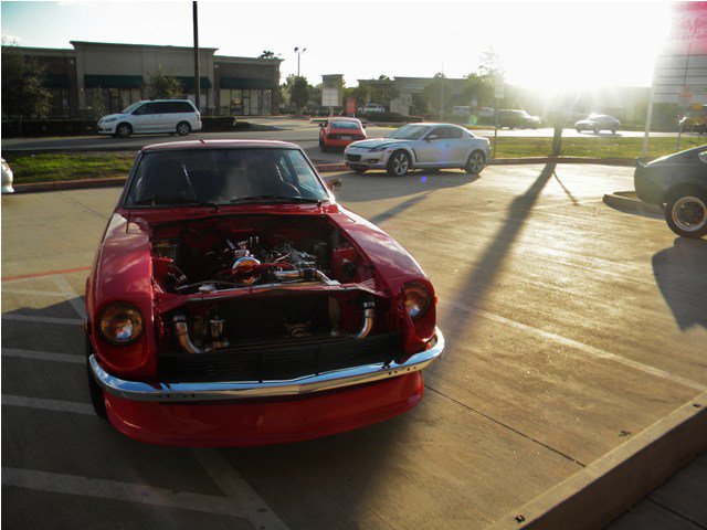

Well my dad and power fab have decided that the 240z could use a new and better motor.
So we are swapping the stock L28 turbo motor out for a 3.1 Stoker witch will be turbocharged.
The motor is ready for install and things should Begin to move along next week.
Along with this swap there will be different clutch used.
Bigger FMIC
Turbo shafts.
Quafie rear end.
And 750cc injectors.
I will take many photos and post.
