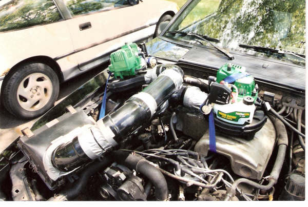

xShodaimex Posted August 14, 2010 Share Posted August 14, 2010 (edited) Hey guys.. I had an idea about using a few air compressors and shootin it through the intake. Not sure if anyone has tried it but I was wondering what you guys think about it. I know it may sound stupid but I just wanna know if you guys think it will work or not. Thanks. I also included a picture! hahaha The levers will be somewhere near the driver and the tanks secured safely elsewhere. This is like a one time thing since you will run out of air, but its air. Was readin book Maximum boost by corky bell and this idea came up. Edited August 14, 2010 by xShodaimex Quote Link to comment Share on other sites More sharing options...
stprasinz Posted August 14, 2010 Share Posted August 14, 2010 far from haveing enough air... the tank would have to be huge!!! think of the size of the charge piping alone.. its charged at say factory 7 psi(approx) that piping would be pretty close to the equavelient of one tank.. but the air is only there for a amazingly short time... so if you charge 4 pretty good sized air tanks with say 150psi... if you found a way to discharge them in say 5 seconds it might reash 2-3 psi.... which with the added weight of the tanks etc.... you would have what you had before, without the tanks in the car... for about 5 seconds..... so in short.. it wouldn't work..... now nitrous on the other hand.. comes compressed in a bottle, and could be purchased with everything needed to install for ah say... 300$ thats new, but budget, and decent product.... now thats a tank worth filling!!!! 75 hp on tap.... good luck, keep thinking Quote Link to comment Share on other sites More sharing options...

Administrators RTz Posted August 14, 2010 Administrators Share Posted August 14, 2010 On 8/14/2010 at 12:52 AM, xShodaimex said: but I just wanna know if you guys think it will work or not. Absolutely positively unreservedly not. Quote Link to comment Share on other sites More sharing options...
Tony D Posted August 14, 2010 Share Posted August 14, 2010 (SIGH) This is a doable idea, and the concept is proven. Using 'amplifiers' --- volume enhancing devices for compressed air --- it IS possible to give the engine several PSI of boost for limited periods of time (we are talking seconds here). It's a lot of work for a very short duration boost of power. Passing, drag racing cheater system, etc. With the use of SCUBA-style tanks, the boost can be higher and longer making prodigious jumps of power. stpracinz is nowhere close in his calculations, mainly becasue it won't work at all without the amplifiers. Otherwise, you have to get a fueling system which will accomodate it, more cost on something you want on a budget I'm guessing. The guy in Florida that wrote the book about using the Magnesium Replacement Impellers for Toro Leaf Blowers as belt-driven superchargers for small engines (below 3 liters) has another book on making the air amplifiers, as well as some stuff using CO2 bottles similarly. I didn't read into the CO2 stuff. Generally the Compressed Air stuff is for street racers who will claim to be N/A and have no NOS...but still have something up their sleeve. Everybody has air bags today right? Explains the big tank in the trunk! Can't use levers, need to use fast reacting solenoids and ASCO or Aquamatic Valves. Like you got on the Air Bag "Jumper Set" cars with the weeping women murals and 45 degree mudflaps with 13" wide whitewalls... Don't read too much Corky. It leads you down a paradigmed path which is damned boring! Quote Link to comment Share on other sites More sharing options...

proxlamus© Posted August 14, 2010 Share Posted August 14, 2010 lets use this as an example.. I have a 60 gallon 1/2 horsepower compressor that maybe flows 90psi at 10 CFM. A descent 3.0L engine with 100% volumetric efficiency can pull up to 1,300 CFM Its not possible to have any beneficial gains with a small compressor. Now recycling exhaust gases to generate positive pressure in the engine is free power.. turbochargers are awesome. Quote Link to comment Share on other sites More sharing options...
