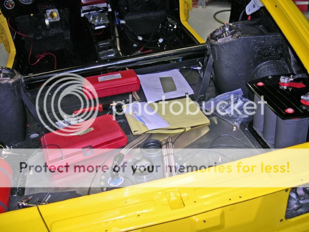

Taz240Z.V-8 Posted March 20, 2011 Share Posted March 20, 2011 Here's how mine was done to make it safer.... Quote Link to comment Share on other sites More sharing options...
Tony D Posted March 20, 2011 Share Posted March 20, 2011 No, you don't have to cut anything. There are 'spare tire cels' that go in there and you put the sheetmetal cover over them... Now, on that 'Third Degree Burns Hurt'...technically the nerve damage prevents the burn itself from hurting (so I'm told, they always were painful to me...) Apparently it's the healing and restoration of the nerves (or overstimulation during the debreeding) that hurts like hell! Let's change the subject now, shall we? Quote Link to comment Share on other sites More sharing options...
