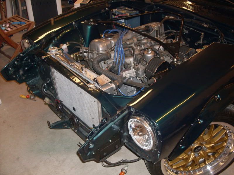

ROVdriver Posted January 11, 2011 Share Posted January 11, 2011 Have noticed there's already a few others in here doing the Lexus conversion into their Z-car. I have planned to do this for a couple of years now, and have finally started the conversion. Here is my car: It has been restored since 2005, and has been used on the street for a little more than a year with the original L24 inside. So, when the winter knocked on the door, the Z was put in the garage and the project started. Quote Link to comment Share on other sites More sharing options...

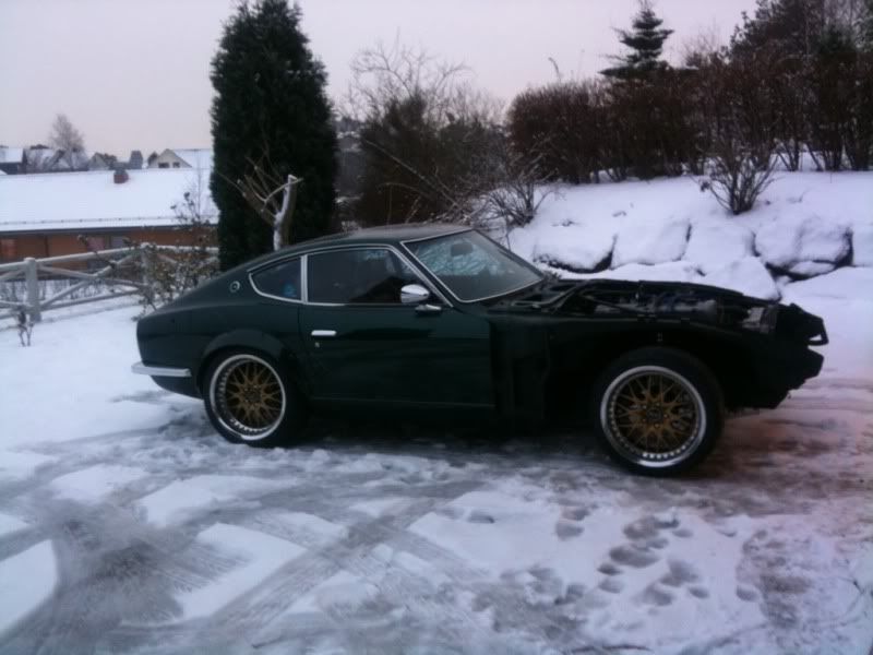

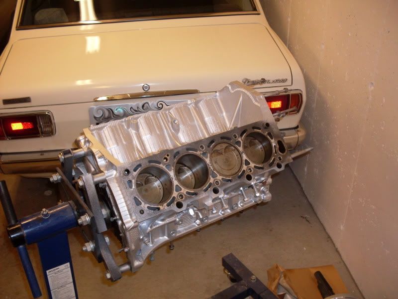

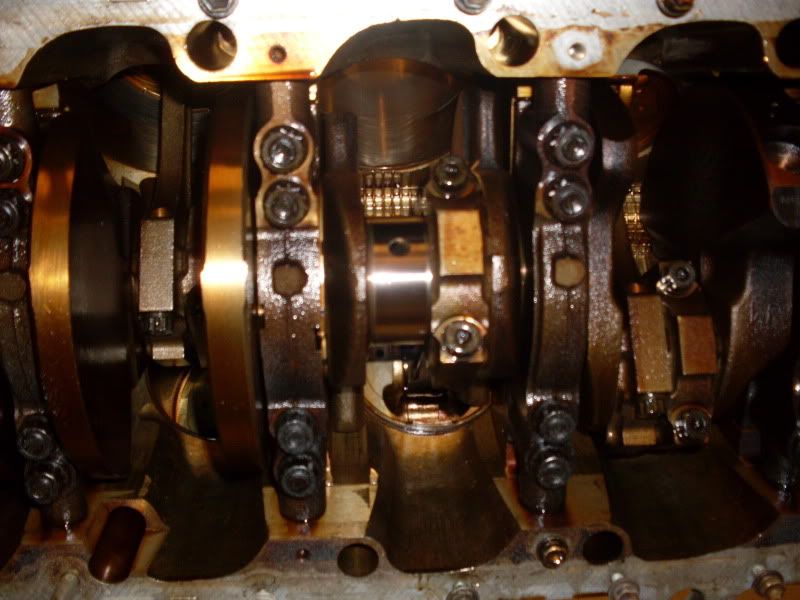

ROVdriver Posted January 11, 2011 Author Share Posted January 11, 2011 I had the UZ apart to make sure it's in good condition. Had to back the car out of the garage to turn it after the snow came, and was barely able to get it back in:) -Very slippery! Quote Link to comment Share on other sites More sharing options...

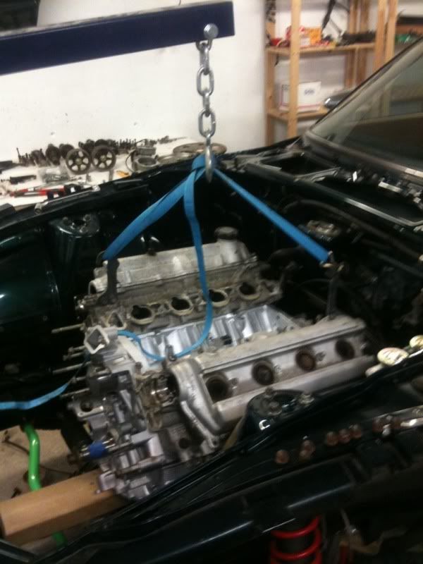

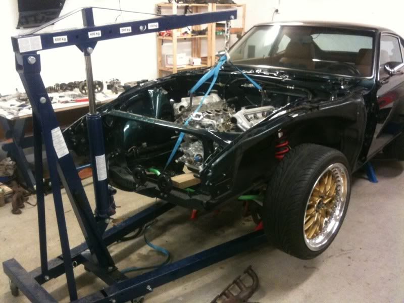

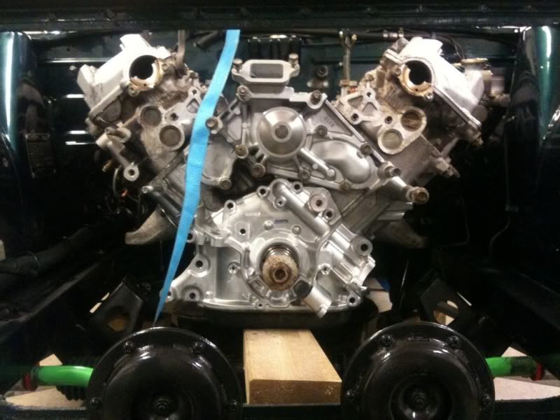

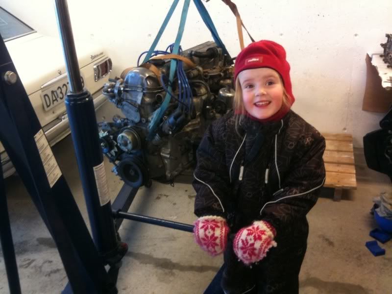

ROVdriver Posted January 11, 2011 Author Share Posted January 11, 2011 And then, with some good help from my daughter, the L24 went out... ...and the UZ were joined with the transmission and lifted into the car. So then I have to spend some time to measure and align everything, before I start fabricate engine and transmission mounts.... Quote Link to comment Share on other sites More sharing options...

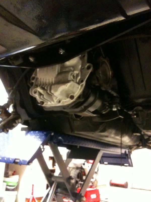

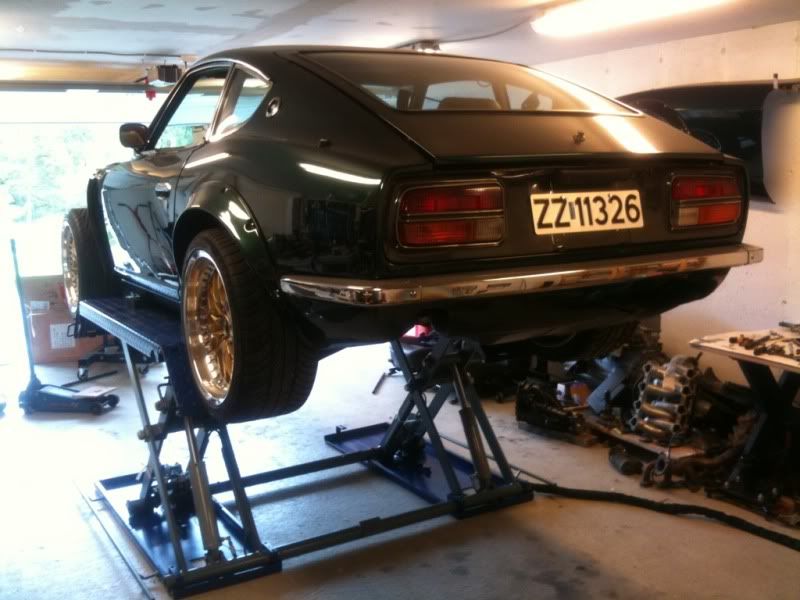

ROVdriver Posted October 22, 2011 Author Share Posted October 22, 2011 In the progress of mounting diff(r230) using modern motorsports kit. Have also bought a car lift, that was a bit improvement for the working conditions:) Quote Link to comment Share on other sites More sharing options...
