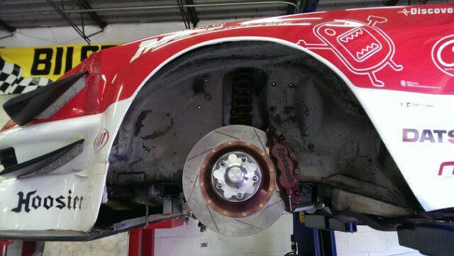

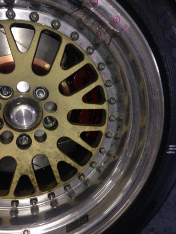

The one VERY bright spot to my weekend was the new MTI Designed AP Racing brakes that we custom made the brackets and hats to adapt to my AZC stuff that came with the wilwood 6 piston brakes. The rotors and calipers compared to the Wilwood stuff makes them look as if they came off a lawn tractor. I have been able to do fairly well with the old setup and have a ton of real data to compare the new set up to the old set up. The track this past weekend was around 2 seconds off of its normal times due to it being August and hot as hell and slippery. That was the consensus from some other seasoned drivers times. The new setup allowed me to be .3 seconds off of my all time low time. This is very encouraging and I am looking to try and find a 1:26 before its all over or I kill myself trying.
I would never suggest someone testing a completely new brake set up that doesn't even exist on another car at Road Atlanta in a NASA SE Thunder race. It seemed like a good idea at the time for some reason........
I would love to know if anyone would be interested in this AP Racing big brake set up for their car?
I have 17" CCW Classic race stepped lip wheels and their is still 1/4 inch of clearance on the barrel.
The reason I went with the AP Racing package is because it is the same exact one on my Corvette. Now I have the same set up and pads on both cars. For the record they are CarboTech XP-20's.

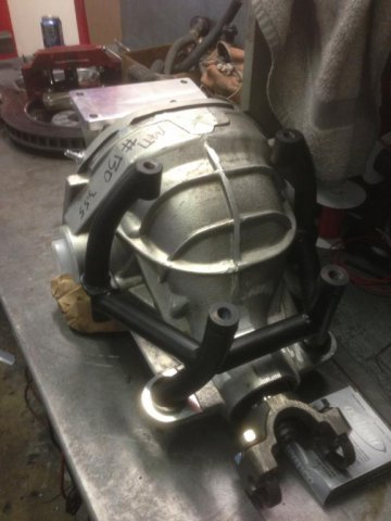

We have reached a solution to the ring and pinion / diff failure issues.
We are installing an MTI Racing built Ford Motorsports 8.8 Differential. MTI Machine will be fabricating all the new mounts and structures.
Here is a picture of one that was being shipped out today to be installed on a GTO.
I haven't decided on the gears as we need to look at the data and see if we can improve by making a few changes there. I'll keep you posted.
We all know that nothing is bullet proof.........However this is a whole lot more to work with. Strangely, it is larger than my Q45 pumpkin but weighs less due to it being all aluminum and not steel. The cost to keep replacing and repairing the one I have is just not paying off. I think it still is the best option for most HybridZ builds and track cars but I seem to be a little harder on mine than usual.
Its hard to say that its money well spent after all we all can relate to spending stupid amounts of money on these builds but this is money well spent. I have proven that the amount of torque I am putting to the wheels will cut the shelf life of my present setup considerably. For the record my setup was the Q-45 pumpkin and the carbonetic diff with the custom AZC axels. The only axel failures I've experienced have been in the boots leaking or flying off at high speed, so no broken axels.
Here is also a shot of the new brake set up behind the wheel.

Matt, Sorry to hear about the failure, but I guess it's also progress.  Now you know you have a weak link and have developed a plan to improve it.
If anyone is interested in this Differential setup for their car please let me know...............
I'm interested.
When balancing weight, cost, and parts availability the 8.8 wins hands down.  It still makes no sense for 99.99999% of the Datsun owners out there who don't destroy r200's.  I'm glad their are guys like Matt out there who will thrash everything, and come back and tell us all exactly the way it went down.  The elusive 1.26 is there.  For your sanity and your wallets sake, I hope the list of sacrificial parts is near complete.  I can't wait to find out.
