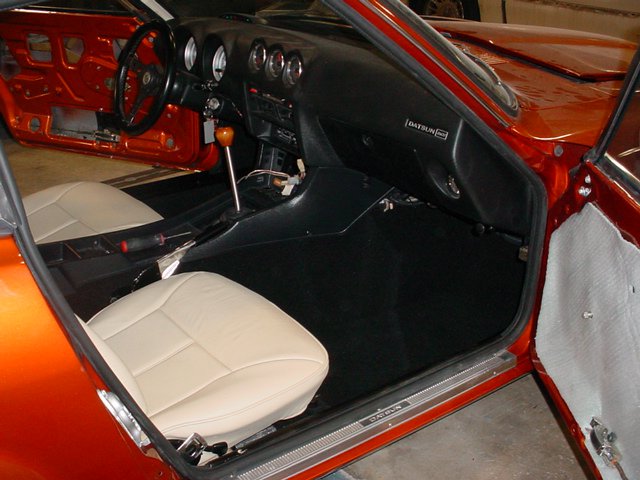

Posted 13 November 2009 - 06:15 AM
2003 Cavalier
More pics at picasa link below signature.
