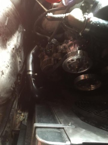

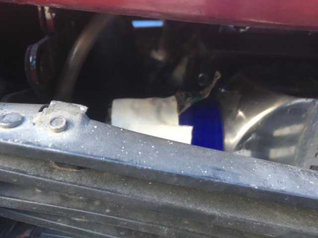

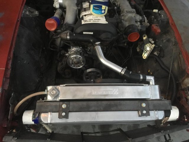

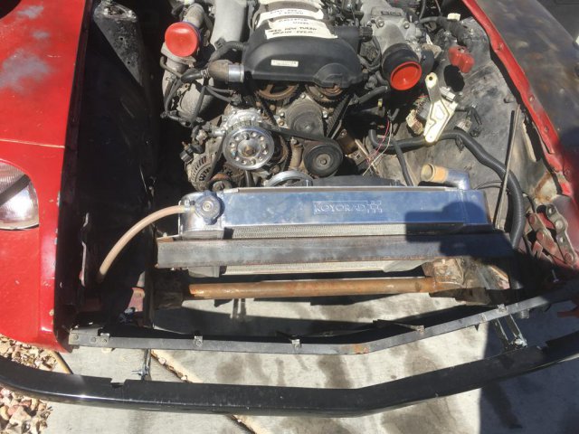

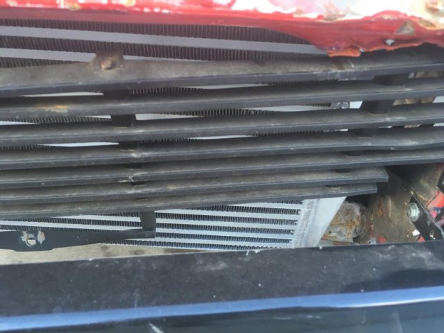

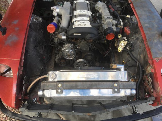

Update.
So I tackled a few things on my list. I don't know about you guys but when I do something new like make something, I end up running back and forth to the parts store.
Luckily I live 2 minutes away from multiple auto parts stores, and a Mcfaddendales.
Today wasn't so bad in that sense

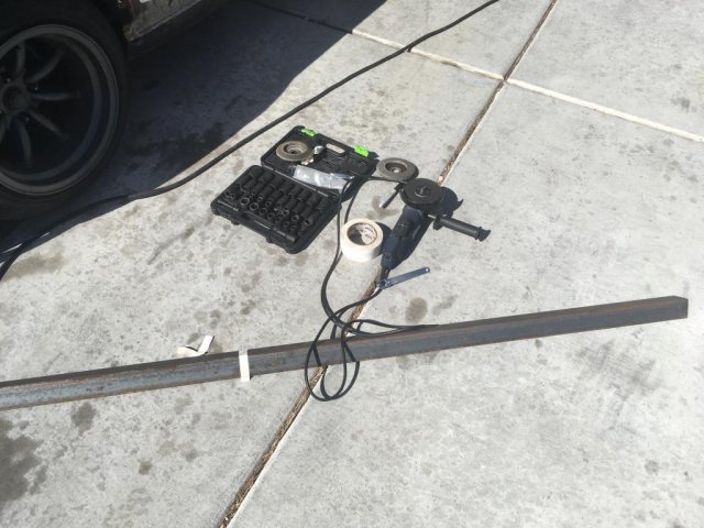

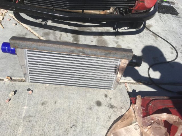

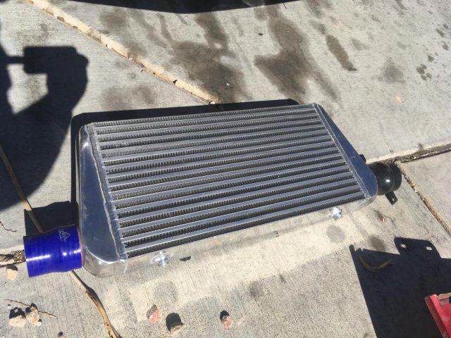

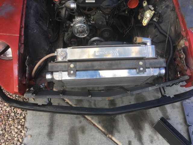

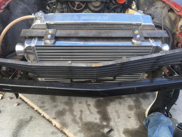

Intercooler brackets.
So I ran to Home Depot, and stood there pondering how I would tackle this.
My main focus was trying to keep the slant of the radiator, yet keeping it inside of a 28" x 14" measurement.
After going over multiple options in my head, I went with an easy L bracket 72" x 6" x 3".
I measured the slant of the radiator and the intercooler itself. seems to be about right.
Attached File  IMG_5573.jpg   155.24KB   0 downloads
Attached File  IMG_5574.jpg   115.97KB   0 downloads
I trimmed down the L bracket to the size of the intercooler.
Then I made small brackets to bolt on the radiator to the intercooler. (I should've just welded this, but it works lol). I measured where the intercooler would sit compared to hood latches, and clearance.
I did have it just a hair too high so I brought it down about a half inch to get it to clear the hood.
Attached File  IMG_5575.jpg   144.63KB   0 downloads
Attached File  IMG_5576.jpg   129.05KB   0 downloads
Attached File  IMG_5578.jpg   115.35KB   0 downloads
Attached File  IMG_5579.jpg   114.82KB   0 downloads
Attached File  IMG_5581.jpg   133.54KB   0 downloads
Attached File  IMG_5586.jpg   86.69KB   0 downloads
Attached File  IMG_5587.jpg   61.24KB   0 downloads
Attached File  IMG_5585.jpg   106.29KB   0 downloads

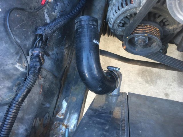

My idea here is, run two 90 degree couplers to clear the hood latches and side rails.
This should put me in the right position for my piping, which I am waiting for.
Next I started doing the radiator piping.
If I've learned anything from doing swaps its all about saving all parts and bolts of whatever you use or have used.
In this situation the hoses I had used on the L26 set up worked for the top.
Attached File  IMG_5588.jpg   89.57KB   0 downloads
As for the bottom the water neck and the stock radiator feed to water neck is a bit tricky.
So I need to order some aluminum piping and a few couplers. I will also buy a overflow reservoir.
Attached File  IMG_5583.jpg   108.04KB   0 downloads
Attached File  IMG_5584.jpg   76.76KB   0 downloads

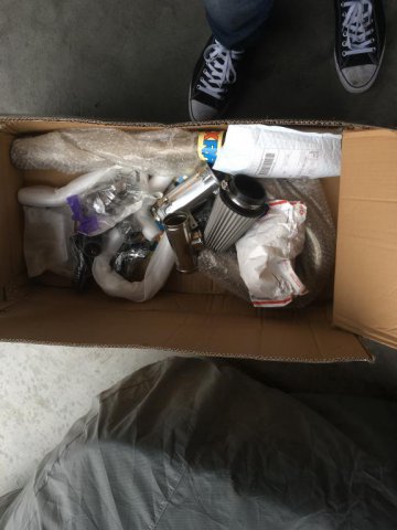

UPDATE
Well small update.
So I've gotten miscellaneous parts in finally.
Attached File  IMG_5670.jpg   52.29KB   1 downloads

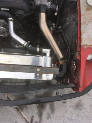

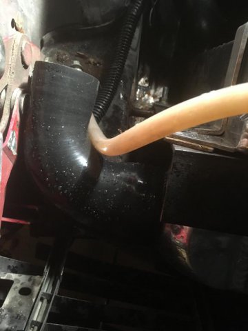

I decided to start with finishing my coolant hoses, but since it would be in the way before I could finish that I needed to finish my turbo drain feed. Lol not going to say its ugly but its super ghetto looking. Since my feed smacked right into my passenger side motor mount I had to use brass piping to make a 90 degree lol.
Anyways I finished the Oil Drain feed and did the hoses. I bought FB3s Rx7 radiator components (aluminum piping, misc. couplers and an overflow reservoir ). It worked well, I did minimal cutting on one of the aluminum pipes to make this work. I think i am going to make a bracket for the Overflow Reservoir that comes off of the Rad/Intercooler bracket. I don't want to do this until I finish doing my IC piping, since i don't want to make unwanted issues or make things harder.
I snapped a quick picture, its been raining out here inconsistently so I really didn't finish much.
Attached File  IMG_5682.jpg   39.79KB   0 downloads
Attached File  IMG_5683.jpg   38.74KB   0 downloads

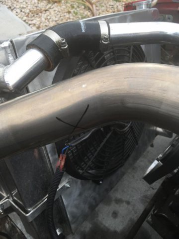

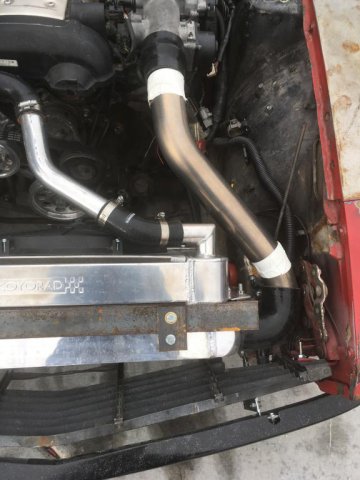

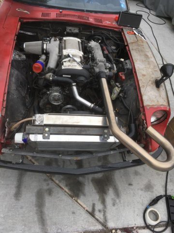

The next thing was starting to mock up my IC piping. I went with Stainless steel since i don't have a TIG. I got two mandrel bent pipes x1 2.25" for hot side, and x1 2.5" for cold side. Im still waiting on the 2.25" mandrel bent pipe but I finished my cold side. On the cold side is where I will mount my BOV. I will weld everything at the same time once I get the pipe for the Hot side. Hopefully I will get this in today.
Attached File  IMG_5671.jpg   73.91KB   0 downloads
Attached File  IMG_5698.jpg   56.99KB   0 downloads
Attached File  IMG_5699.jpg   62.64KB   0 downloads
Attached File  IMG_5700.jpg   46.41KB   0 downloads

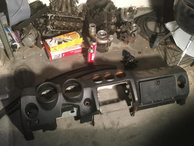

I bought some Speedhut gauges, 4" Tach/Speedo. Which are being made and need 15-20 days to be finished?
I also bought auto meter 2 5/8" Oil, Coolant, Fuel gauges as well.

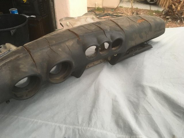

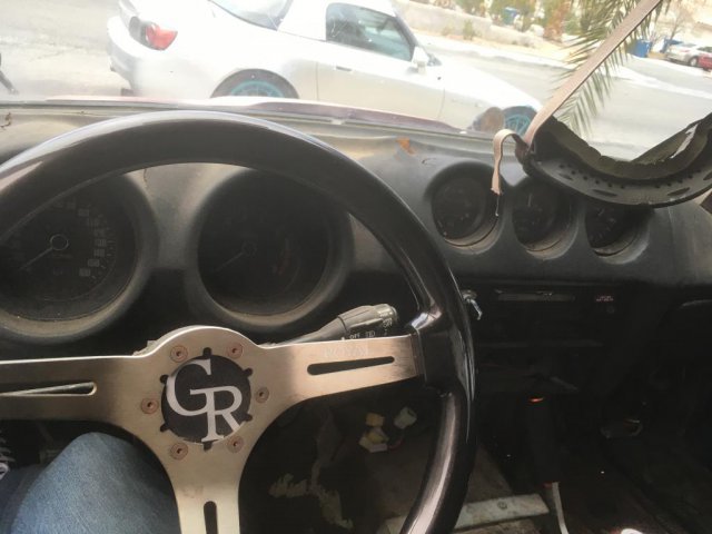

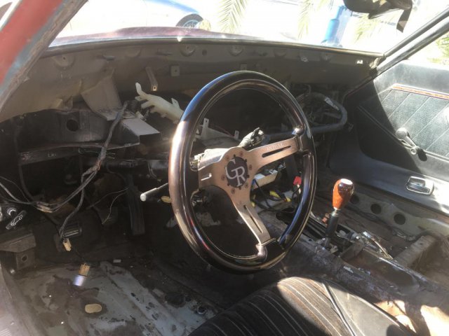

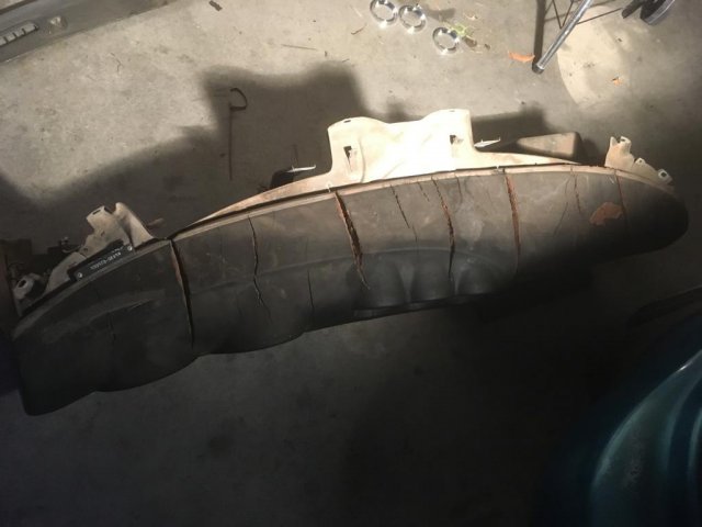

Figured since I need to wait so many days, i might as well do a Dash Resoration lol.
So I removed my dash, lol it wasn't so bad. I thought it were going to be a lot worse TBH.
I guess some guys have to drill out their last screw, but luckily I didn't have to. Looking at my interior with the dash removed makes the car look weird lol. As you can see my dash is going to need a lot of TLC.
Attached File  IMG_5701.jpg   73.2KB   0 downloads
Attached File  IMG_5704.jpg   70.05KB   0 downloads
Attached File  IMG_5705.jpg   100.8KB   0 downloads
Attached File  IMG_5706.jpg   56.28KB   0 downloads
Attached File  IMG_5709.jpg   95.76KB   0 downloads
Looking over a couple of the Dash resto's Hybridz has, I think I like this one the best.
http://forums.hybrid...ion-new-gauges/
Its funny when you start doing swaps. When I started this I told myself I would keep the r180 diff and not do anything interior, but i guess once you get the ball rolling its easy to say fuggit lets do it lol.
Hopefully by end of the week I can get that other IC pipe done and everything welded.
I ground out the dash cuts, used epoxy and mat underneath to reinforce, used great stuff foam to fill in the cracks, SEM bumper repair for covering the cracks, SEM flexible bumper glaze for smoothing out the dash then texture coating and paint.
Turned out really good!

UPDATE*
So i've been doing a few things here and there but haven't really posted. I figured me posting a bulk of the things I did over the past week, compared to me posting daily would make more sense. That way you guys could see more of things finished, over things that were still in the works. Maybe less of me talking and just letting the pictures do it for me? lol Don't want to seem longwinded.
Lets start with the piping. I got that done and welded about a week ago, just had been waiting on the Tbolt clamps. This is self explanatory, I later ended up seeing what clamps would give me hood clearance issues. See below.
Attached File  IMG_5717.jpg   87.12KB   0 downloads
Attached File  IMG_5726.jpg   34.71KB   0 downloads
Attached File  IMG_5737.jpg   86.45KB   0 downloads
Attached File  IMG_5739.jpg   69.81KB   0 downloads
Might do a bracket for the Overflow Reservoir, might not. Lol we shall see, ill come back to this later.

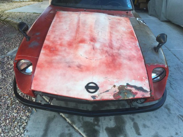

Next I ended up getting the ZL1 camaro hood scoop (I just had too it looks so good lol) Got it, Riveted it on, cut accordingly, and of course still clearance issues. The white tape again of course lol. I had to cut a little bit, which sucks but looks cool. I will get hood pins instead of use the stock one. Was thinking about doing a Hydraulic mechanism for the hood hinges, but X'd that idea. Looked around a bit online for someone who might have done it before, still no one?
Attached File  IMG_5788.jpg   75.07KB   0 downloads
Attached File  IMG_5789.jpg   55.71KB   0 downloads
Attached File  IMG_5794.jpg   36.94KB   0 downloads
Attached File  IMG_5797.jpg   68.45KB   0 downloads
Attached File  IMG_5798.jpg   69.41KB   0 downloads
Attached File  IMG_5799.jpg   57.44KB   0 downloads
Attached File  IMG_5801.jpg   103.99KB   0 downloads
Attached File  IMG_5803.jpg   40.05KB   0 downloads
Attached File  IMG_5802.jpg   77.26KB   0 downloads
On to the dash, this has been an on-going project for me lol. Its a little bit more involved, which I don't mind because its taking forever for the speed hut gauges. Just want to make it look right, I think if i don't get this right this time I will bondo the whole entire dash. I think i can do it without doing that but we shall see.
Attached File  IMG_5712.jpg   88.39KB   0 downloads
Attached File  IMG_5713.jpg   79.65KB   0 downloads
Attached File  IMG_5718.jpg   96.67KB   0 downloads
Attached File  IMG_5725.jpg   65.29KB   0 downloads
Attached File  IMG_5734.jpg   48.1KB   0 downloads
Attached File  IMG_5735.jpg   96.33KB   0 downloads
Attached File  IMG_5740.jpg   72.13KB   0 downloads
Attached File  IMG_5741.jpg   132.83KB   0 downloads
At this point, i am on my 3rd time bondoing and mostly working on the dash for now. Trying to get it as perfect as I can since this will be the focal point of my attention while driving the car lol.
