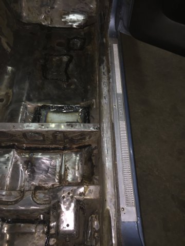

Okay, back! I figured tonight I would add in some pictures so you nice people could have some visuals.

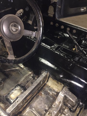

Okay, so, frame rails are welded in. Everything on the bottom of the car is looking damn good. Now I realize it's time to start dealing with the inside of the tub. Oh god it was a mess in there. Horribly gross. I started with scraping that weird rubber undercoating off the bottom of the tub. I did not touch the trunkspace, just the little front compartment of the car. I scraped and scraped and then came across lots of fiberglass! Turns out the past owner glued lots of fiberglass paneling to the driver's side footwell. I guess he was trying to cover the rust spots! Anyways, I ripped that shhhh right out. Now we have an even uglier tub and at this point I'm thinking hmm, yeah this tub is never gonna look good again. I took a whirlie bird and some used about 47 freaking cookies getting my tub down to bare metal. I'm not gonna lie though, this was definitely a fun time. I did enjoy using that little tool and it was cool to see all that black stuff on my floor vanish beneath swirl of my green cookie.

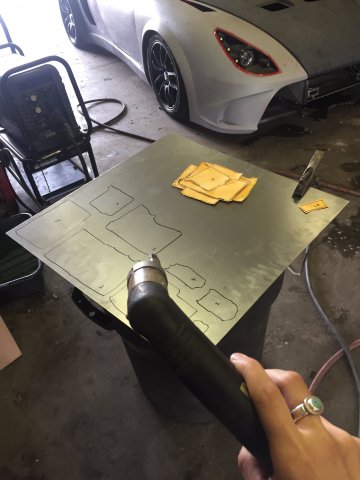

At this point at least all the rust in the tub was visible. We took a plasma cutter and cut out any sign of rust we saw! That thing is scary but also like a giant lightsaber so after a couple times using it, it was not just scary, but scary and cool! SO, rust is out, ten giant holes in my floor. Next, I went to home depot and purchased a large sheet of, I think it was 16 gauge steel? I remember it being either 16 or 18 gauge but I'm pretty sure it was 16. Anyways! So I made little tracers on thick paper of what the holes in my floor looked like. Hm, maybe if I was little less shaky with that damn plasma cutter my cutouts wouldn't have been so misshaped.
I took my cutouts and traced them onto the large steel sheet and then had those cut as well! To my surprise those little shits did not fit perfectly A couple mm's off in this corner, two cm's off in this corner, wow a whole inch off in this corner? Who let me use a plasma cutter jesus christ. Anyways, they were close enough but they didn't fit like damn puzzle pieces into my tub and so that was not good enough! Naturally, I spent the next two days of my life grinding, grinding, grinding down those metal pieces till they fit like they were born to be welded into the currently mangled state of my floor. But damn, I had metal flakes in my skin, in my shoes, little cuts on my neck, basically microscopic metal pieces in my soul now from grinding those pieces so much. Alas, I had some good pieces and they got welded into the floor within the next couple days.
Now I have a goooood ass looking floor. Wow, such bare metal. I seam sealed the welds and took the next couple days and two quarts of SEM Rust Preventative paint and painted both the underneath of the car and the inside of the tub with it. Dirty D was starting to look presentable again. I was surprised, honestly didn't think I could've painted that car so well but damn. Damn is right, my car was looking good. And yes, the smell of that black paint stayed in my nose for about a week. Yup.
Edited by juliarosario
Share this post
Let me get some pictures for you guys. okay.

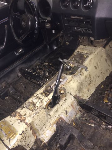

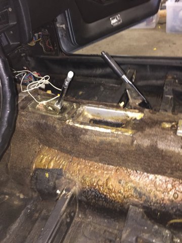

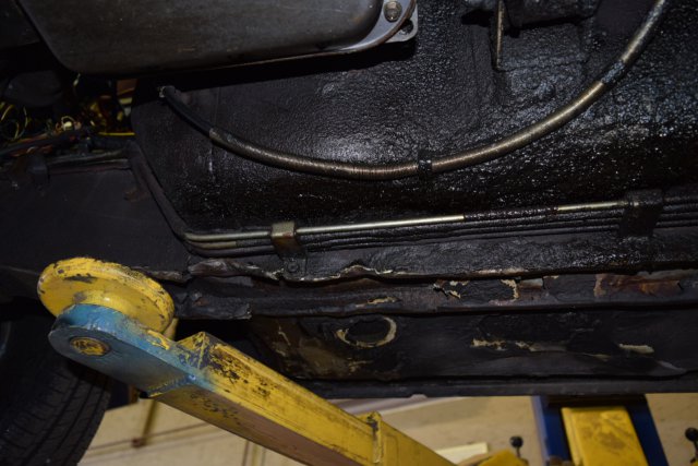

That first picture is of that messed up frame rail and that gross ass undercoating.

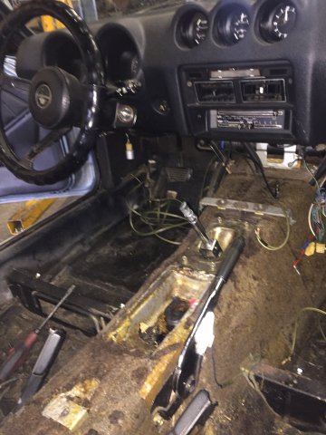

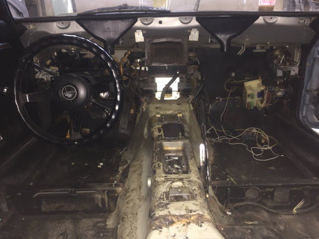

Next, we have a picture of what my interior looked like. Look at all that brown fuzzy stuff. Reaaaally gross, I don't know. It made me itch.
Look at all that bubbly gunk. I remember scraping that deadening off piece by piece and each chunk that came off felt AMAZING. Ugh, so gratifying when a giant chunk would come off. Getting too excited thinking about it, must move on.
Forth picture, we have no sound deadening, just that black coating. It was so sticky. Why was it so sticky..

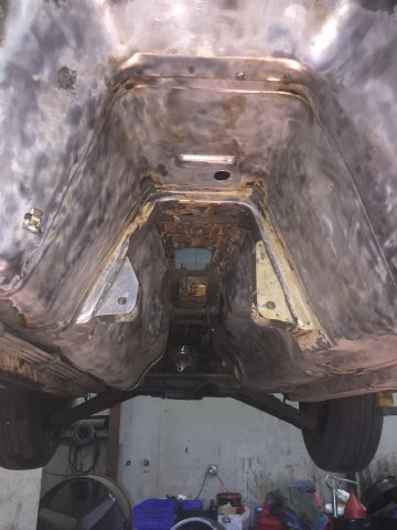

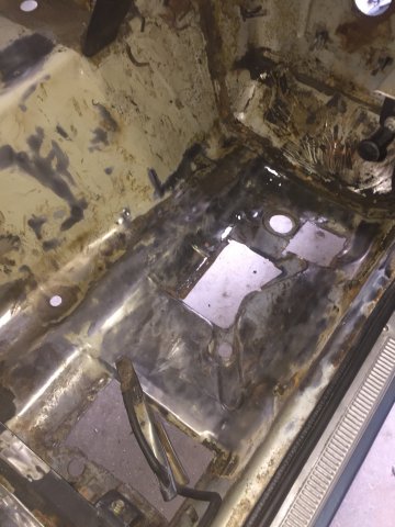

Next, we have my beautifully bare undercarriage. LOOOK at it.
Okay okay, next, you're looking at some damn nice, unevenly proportioned holes that were "professionally" cut out of the floor.
And then we have me holding that lightsaber thing with my cute little cutouts.
NExt, the welded floor with my metal pieces all in. Yes, I know those metal pieces fit like puzzle pieces?? Wow.

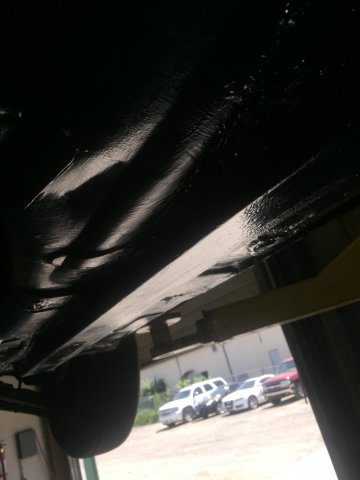

Next, you're looking at an empty can of paint. How did I get so much paint on the outside of the can?? Also definitely remember getting that paint in my hair. Can confirm, not a fun time.
Okay, after. This is halfway through painting the tub. I think I took a break because I was feeling lightheaded because of all the paint fumes?? Hmm, don't really remember tbh.

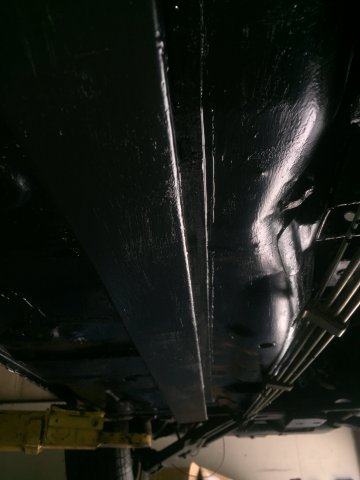

The last two pictures are of the underneath of the car. The frame rails look brand new. I wish I had better pictures but the car was up on the lift and my head was tilted in a weird way. But believe me, it looks awesome!! Very clean.

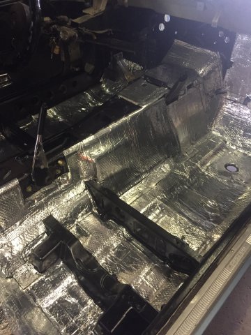

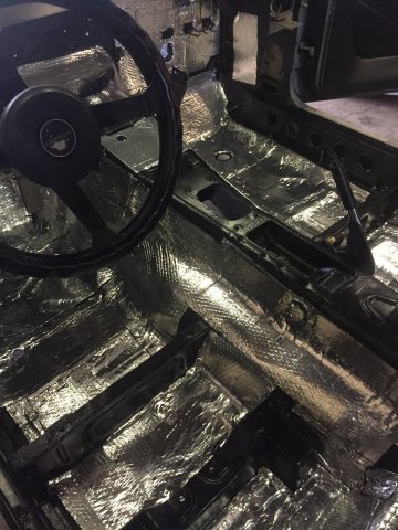

Okay Okay. SO now the floor is painted, underneath is done, for now. I'm thinking, it's time for some sound deadening. I went to amazon and purchased 35 feet of NOICO brand sound deadening. I read some great reviews about it and it looks super clean.
I went to a paint store and got myself a little hard roller, and some razor blades, went back to the shop and got to work! I would say it took me about two to three hours to do the passenger side of the car. I measured everything and took my time precisely cutting. Kaitlin, my best friend who is usually around the shop working on her racecar offered to help and did the driver's side while I did my side. Ugh and after we were so damn impressed with ourselves. We had little cuts all over our hands and we did not care one bit because the inside looked so good and we also may have then been on our way to taco bell.

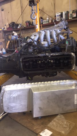

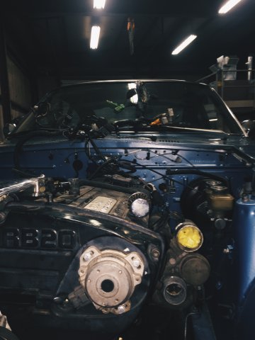

Now that the inside and outside tub was finished I knew it was time to drop that RB in! This was what I was waiting for all summer. In my head I thought, once the engine is in, I'll be driving it around, ripping some burnies the next week. LOL. How naive.

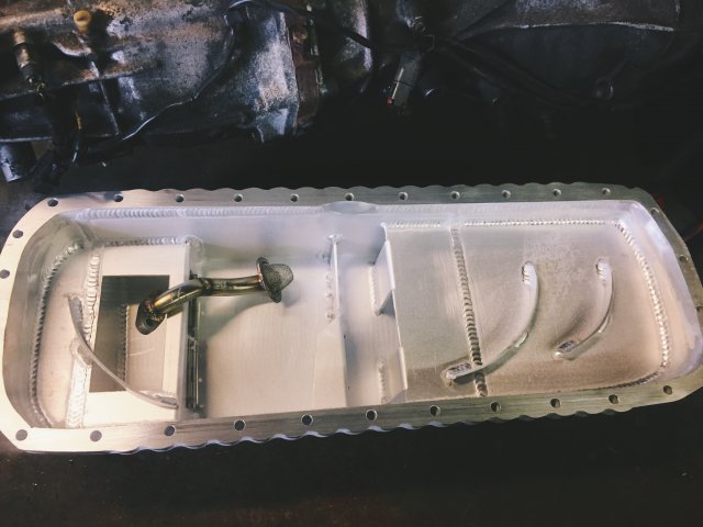

I knew I had to order a rear sump pan for the engine so I did that and I waited. In the meantime, I swapped the intake manifold to a different intake manifold. Basically to delete the need to use the crossover pipe and so I didn't have to route the intercooler piping in that freaky way. I do have future plans to replace the intake manifold once again, I know redundant right??, but to a nice expensive one with nice runners and wow, so fancy, much power. But not now. This setup was temporary!
The oil pan finally came, and we swapped it right onto my engine. The fit was beautiful! The only issue we ran into was that we had to relocate the dipstick and run to napa for some longer bolts because man, the new oil pan had a thick ass flange.
And then the greatest thing happened. All the guys in the shop came over and helped me drop my rb20 into the car. I swear, I was so happy I was gonna cry. The whole time I was thinking, this is too good to be true, too good to be true, something has to go wrong this won't fit, this won't drop it!!      It dropped in just fine.
The only issue we had is that the shifter did not perfectly align with the precut hole in my tunnel, the engine was definitely sitting with a tilt (which yes, I know, I read, this is a thing), and that it sat weirdly high. It was that damn oil pan! It was so thick and so big, the slightest edge of it sat on my crossmember, which made the whole engine sit a little high, and not fall just right into place ontop of one of the mounts. We notched the shit out of my crossmember, as gracefully and skillfully as we could do, really like an eighth of an inch, and watched the engine fall into place.
We then trimmed the shifter hole in my tunnel just a little bit so the shifter could clear freely.
Look how beautiful she is with her engine inside. Wow.

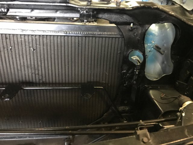

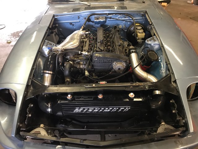

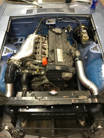

After all that fun stuff was done we turned back to my project! It was time to start fitting my intercooler. We had to cut a ton brackets off the inside of my engine bay. We touched up the paint from wherever we cut with a color as close to that blue as we could find but we didn't really fuss about it. When the car gets painted, hopefully next summer, the engine bay will get all refinished anyway so all this paint is just temporary!
Anyways, yes we cut a lot of brackets off and enlarged one of the holes on the front bracket as well, just so the intercooler piping could clear. We mocked up some set ups and then put the hood back on just to make sure everything would clear.
The first picture is where we were happy mounting the intercooler, give or take some spots. We fit the hood and everything cleared beautifully!
However, the intercooler we ordered did not come with any mounting hardware. Definitely wouldn't have been a problem unless the bolts were some freaky size and length, WHICH THEY WERE. No hardware store around us had them! I ended up ordering them online. I think the size was M12 x 1.25 but like shorter than an inch long. When the bolts came in we finished mocking this up.
We ended up welding three metal plates, about an inch and a half wide, maybe two inches long to the top bracket in the front of my car. We had to take a thin metal rod, heat it up and bend it in place to hold the intercooler up, connecting to the bottom bracket of my car. We welded three plates to that rod as well. We had already drilled holes in those plates for the bolts for the intercooler. We fit the intercooler again one last time to make sure and everything lined up amazing! We painted everything in that front area black again, to hide any grinding or holes we made and it looked very clean! (You can peep where we had to respray in the engine bay from removing those damn brackets).
We bolted everything in and clamped everything down for good. I think all I'm gonna do next is replace those washers on the intercooler to red I think (ricey I know, i love it), but I am in no rush for all that aesthetic stuff yet, I JUST WANT AN  EXCEPTIONAL, OKAY LOOKING, VERY RUNNING CAR).
Also, that last picture was taken last week, so don't look at that nice shiny looking wiring harness yet. We are not there yet, you don't know how that went YET! But this was my only good picture of the finished intercooler set up!

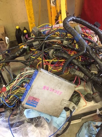

So here is the wiring harness that came with the car. The seller of the engine included the ecu, engine, and harness but not the fusebox. After lots of texts about the fusebox he never got back to me, so we decided we could temporarily muddle something up to get the car running without it.
Up until this point, I had never heard the engine crank over before. For all I knew this engine was gonna start knocking and then I would've also started knocking (my head into the wall).
Okay, so we're connecting alligator clamps to this, that, that wire, getting this wire clamped, probably about a thousand clamps in various pieces but this engine WAS GONNA RUN. We were all so determined to get this engine running!
Everything was set up with the wire we had, but the further we got into plugging things in, the more we noticed this harness was beat to hell. I mean, really mangled!!
 Look at it!
After about a half of day of changing wires around, grounding this, googling that, we realized this harness was too far gone to even try to get it to work. I mean half the wires were missing, we were missing a lot of plugs, and me too, losing all hope.
