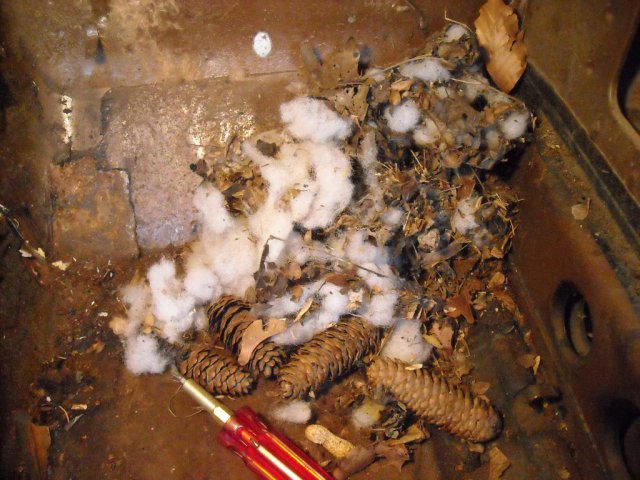

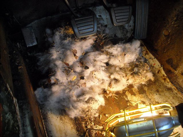

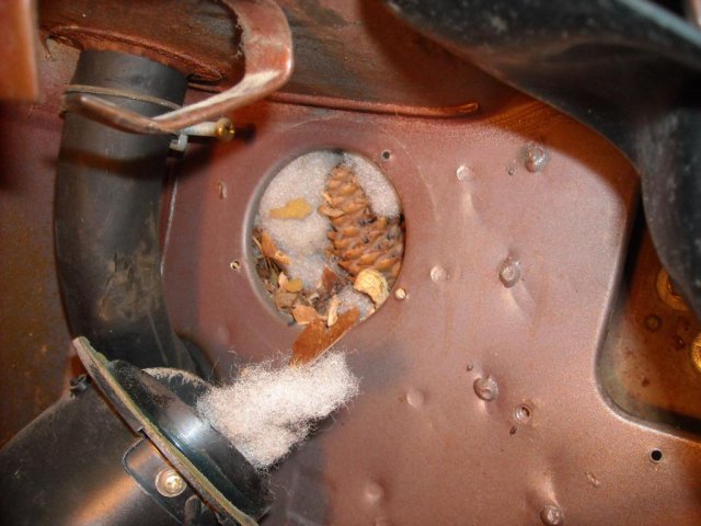

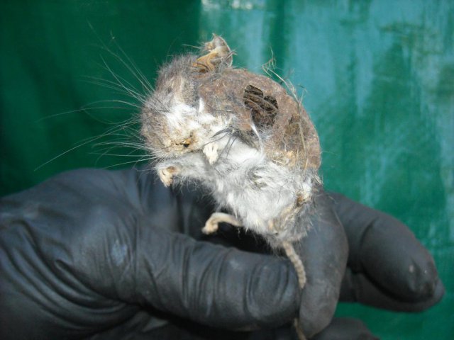

I had multiple generations of the little buggars living in my Z, you could smell from 10ft away, I had the shell of the car acid dipped, installed a restored dash from another Z, stripped all the paint off of the heater box and re painted and cleaned everything with Lye based soap. Now that the car is completely restored when I turn on the heater/blower there is still the faint wiff of mouse pee, it's in the plastic of the vents. Powerful stuff.

Wow grannyknot, that's impressive, my guys were much further decomposed than that. I was not hoping to go to such great lengths as having the car acid dipped, but I did gut the interior scrubbed all the surfaces and today while I was at the parts store I asked if they have anything. They gave me this meguires re-fresher. It's almost like a bug bomb. You set it off in the car with the doors shut and it is supposed to deodorize the smell. It was 5bucks so I said might as well try it. I'll let it soak in overnight and see how it does. The garage is starting to smell fresh as a side effect.
