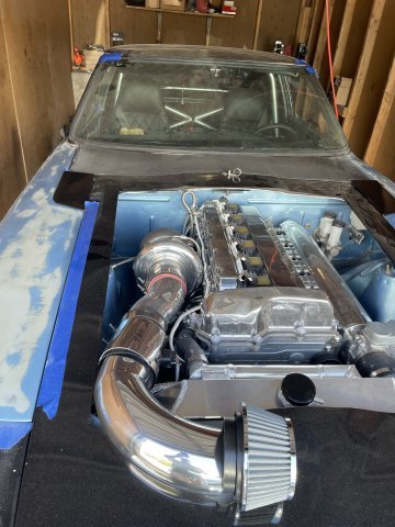

07-09-2026 ATLAS Z UPDATE: Installed the intake piping. You can see the inspection door covers on the car from ZOCIETY, still just laying there I haven't bonded them down yet. Time to finish caulking in the carbon panels and then clear coat over the blue patina paint. PICS:

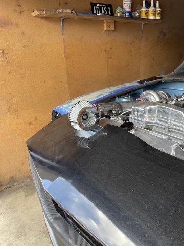

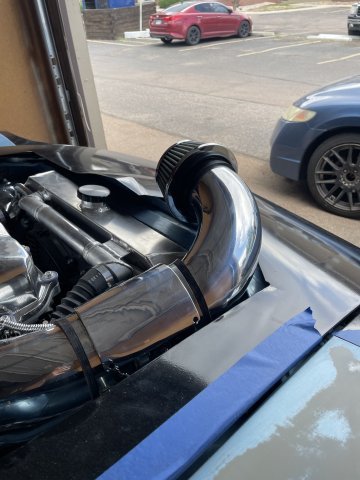

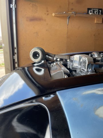

07-08-2026 ATLAS Z UPDATE. I picked up my intake pipe and MAF Meter cover plate from my polisher, J&S Polishing here in Colorado Springs today. int he pics, I just laid it in place, not installed yet. His ability to take my cobbled together crap and make it look fantastic is true magic. PICS:

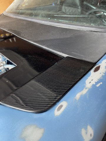

07-07-2026 ATLAS Z UPDATE: I picked up a set of carbon fiber covers for the hood inspection doors from ZOCIETY. Many ways to attach them, I will try silicone first. Since my inspection doors are powder coated, I will do a light scuff and then bond them on with pure silicone, taped down overnight. By the way, they are TOP QUALITY. $360 bucks.

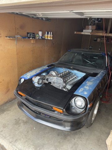

07-05-2026 ATLAS Z UPDATE: I finished feathering out the remaining blue paint, got it nice and smooth, then blew the car off and taped up the front fender and went ahead and caulked the seams. 260Z Fender Badge placement on the fenders looks good. Poppy's Patina Gloss arrives tomorrow, so we continue on! PICS:
07-04-2026 ATLAS Z UPDATE. HAPPY 4TH OF JULY! I removed the front bumper and traced out and cut some spots in the carbon fiber to allow it to fit properly and re-installed the bumper. The edges will be hidden under a thin line of black silicone caulk. I also cut some aluminum stock I had and placed it under the intercooler and Tek screwed it down. it is basically just helping to support the weight. The 260Z fender emblems are on, taped to sit overnight and let the silicone cure. The rest of the day was spent fixing the other Z car I have. PICS:
