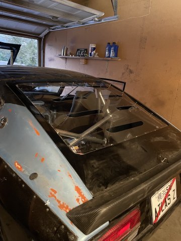

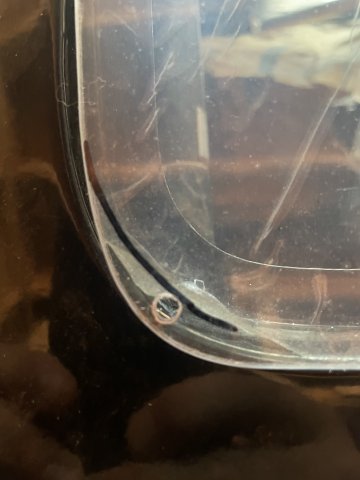

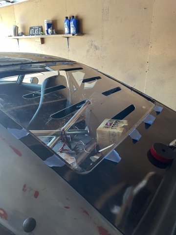

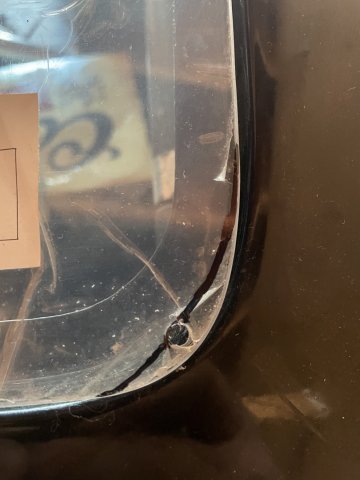

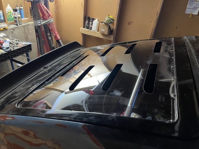

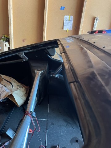

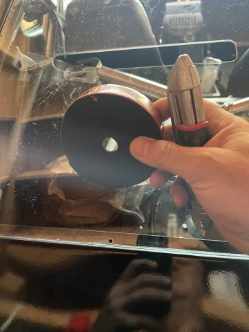

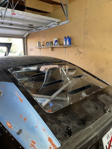

09-19-2026 ATLAS Z UPDATE: I had to replace the O ring around the thermostat, so I got that fixed and got the antifreeze poured back in. Then I did some preliminary electrical checks. a few little things not quite working, so I have to work my way through connections, but 90% is working!! Charging the battery back up to 100% and will try for a start tomorrow hopefully. Then I worked on installing my rear polycarbonate wear "window". I had to trim here and there, and then by trial and error had to keep playing with it and modding here and there but got in finished. in the pics, you can see the small pieces of rubber I installed as a cushion for the window. I got the rubber from Amazon....I can provide a link if you want, jsut ask. God willing I can get out there tomorrow and do some more. PICS

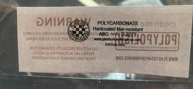

Yep, same place. Thanks for finding them, was wondering where to buy some. Here is the warning label.

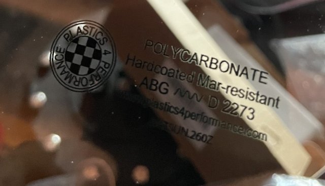

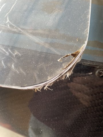

09-08-2026 ATLAS Z UPDATE: My rear hatch "glass" (polycarbonate) ordered from Plastics4Performance in England arrived today. As I have mentioned I had them use their template for Ferrari 458 rear window vents. Why? I like the look. Great for flow through ventilation. This is an open air Z anyway. No side windows, and mostly stripped out. I got the 3mm thick one, so thin, and VERY light. It looks cloudy as I haven't peeled off the protective layer of plastic yet. Now, as they told me, some sanding and fitting will be necessary, but I am happy to report it made it across the pond and to my garage! PICS:
