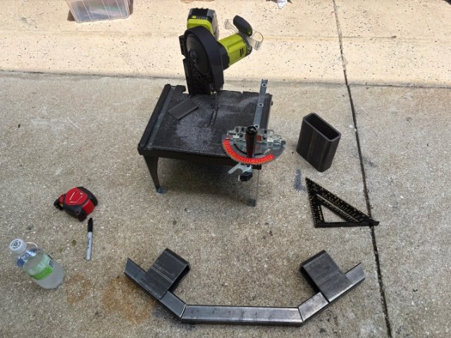

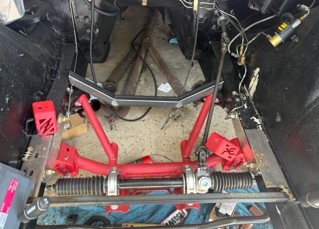

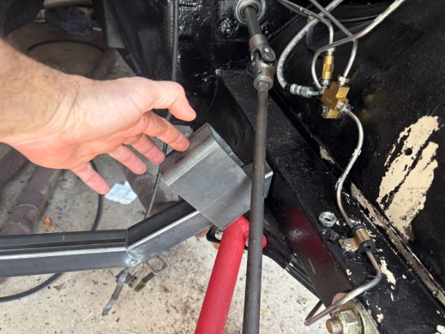

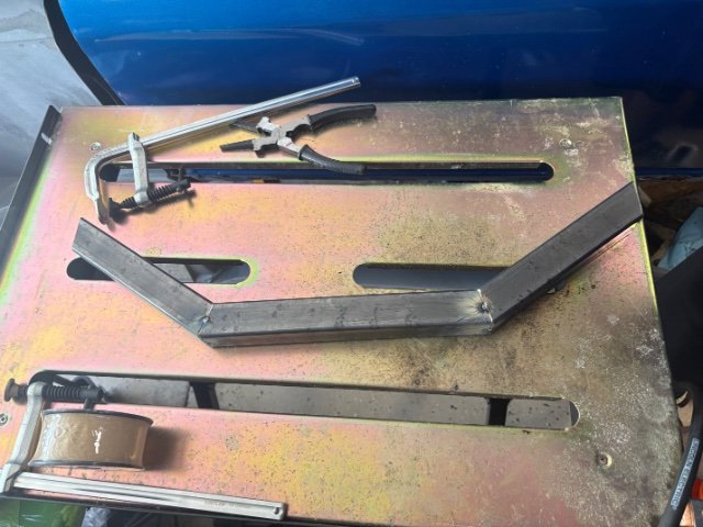

Started working on the cradle this weekend. Laine’s design was a good starting point, had to change some of the angles to work around the apex subframe bracing, but it looks like the 1-1/2” square tubing will work. I’ve got it tacked together now to test fit. I need to do some more measurements and figure out the where to put the vertical part and the correct angle. Hopefully get it wrapped up next weekend and then test fit the motor the following weekend. - Today

how much of a "notch" would your cradle need to sit down? maybe notch it and attach it to the those apex supports aswell as the frame? -
Well bit of a bummer this weekend, I made a mock up of the engine cradle out of cardboard and it doesn’t fit, the extra bracing on the Apex track attack kit interferes. I made a mock up using 1-1/2” instead of 2” and it might work, still a little tight. I’m going to try and make it with the 1-1/2” and change the geometry a little, hopefully it’ll work. Since no fab/metal shops were open over the weekend to get the 1-1/2” tubing I decided to make a bracket to mount my clearview remote filter. I’ll get it painted and re-mount it. Not sure this will be its final location, but I’m happy the way it came out. -
