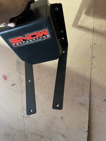

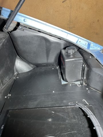

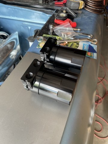

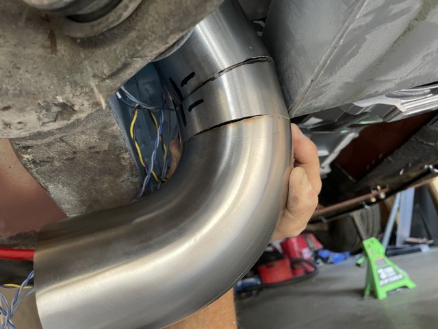

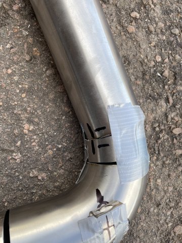

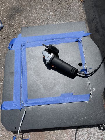

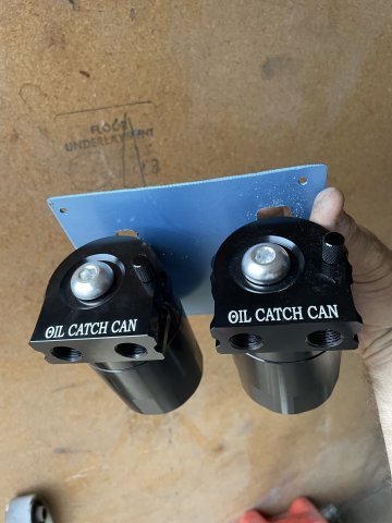

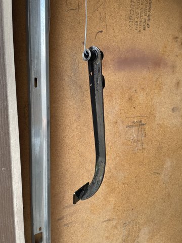

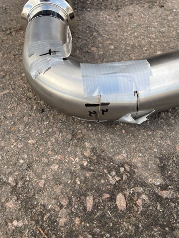

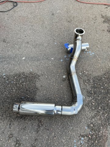

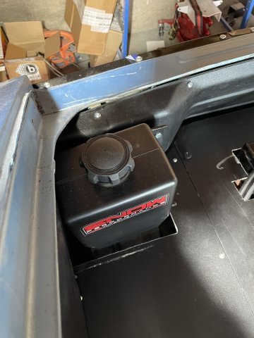

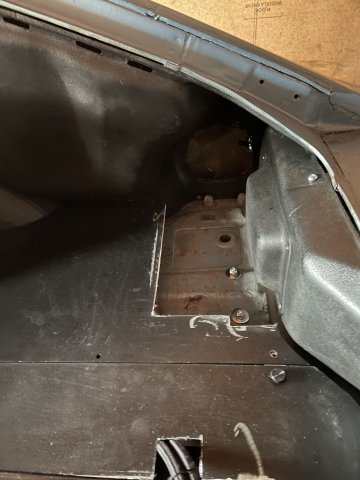

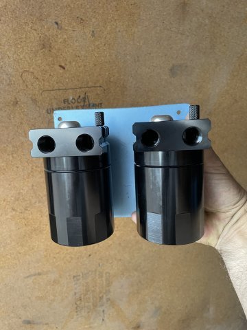

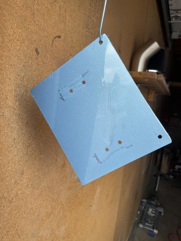

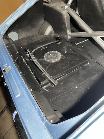

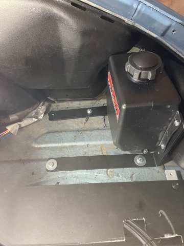

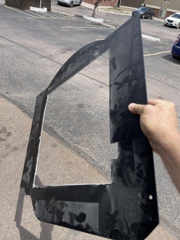

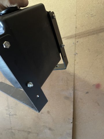

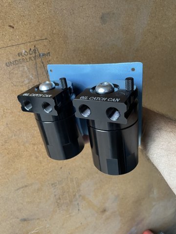

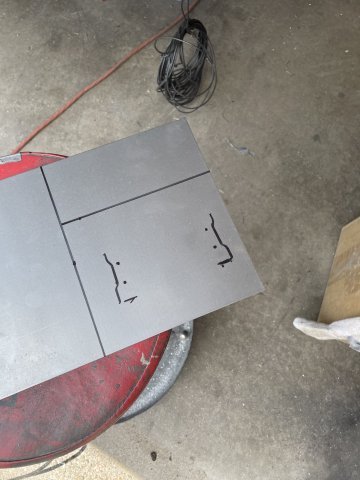

05-16-2026 ATLAS Z UPDATE: good work day got quite a bit done. I started with cutting out the center of the tire cover panel portion of my Skillard rear floor, and then did the same with the area for my Snow Performance Water Methanol Stage 1 Braided kit. I used some shelf brackets I got off of Amazon, and bolted the tank to them and then bolted the tank to the rear floor with the spigot and hose attached. Then I worked on my dual catch can setup. I used some 16 ga. steel and lined out a good size for both of them, and then drilled the holes for mounting them, and painted it in body color and mounted the catch cans up. I will mount it later inn the future, and moved on to pulling the brake pedal, which i mistakenly mounted as the clutch pedal....so while out I moved the hole for the brake cylinder rod up 1 inch for more leverage, since I eliminated the brake booster, and then wire wheeled it up and painted it. Last for the day was the exhaust. I was able to cut a piece that made the bottom pipe a straight and level cut to the floor, then cut the 90 down and did the measuring and cuts so now it can be welded and polished. Oh, I also cut a piece out of scrap pipe, drilled a hole in it and bent it wo where I wanted it and it will be welded on for a hanger to help support the pipe down low. PICS:

05-13-2026 ATLAS Z UPGRADE: I picked up my intercooler piping from the fab shop and dropped off at J&S Polishing to be all done up except the exhaust.....I have to finish the other half of it. The welds really look nice. My Braille Battery arrived to go with the Skillard battery hold down bracket. I went ahead and mounted the battery and the disconnect switch behind the passenger seat. I took the time to paint the areas in the foot well behind the seat, and painted the sides of the passenger seat and began putting things together for good. Pretty good for just a 3-4 hour break in the garage. PICS:

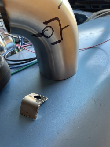

It’s been a long week where in a lot happened, including me getting engaged to my beautiful girlfriend last week! But personal stuff aside we are here for the Z. The body shop couldn’t wait any longer and with my permission they ended up modifying the passenger side frame rail to fit. All in all they did a great job and the end product looked great and above all was very strong. As an added bonus they even gave the frame rails a new coat of underbody spray and drilled two holes in each rail to coat the inside with wax and prevent condensation buildup. This meant I could finally pick the car up last Friday after being over 4 weeks stuck in the shop. By coincidence I was free from work that day so I even got to start the reassembly of the interior starting with the dashboard. And I also quickly strayed the Apex fender braces silver to match the rest of the car. I finished reassembling the dashboard during which I had a little bracket left over. I have studied every possible parts diagram and video but I can’t seen to find where this bracket came from. It was stashed together with all the dashboard parts and bolts but unfortunately I wasn’t smart enough to take pictures of the disassembly. Does anybody know where this little bracket belongs? Anyway I decided to continue the reassembly of the dashboard and reinstall the dashboard into the car. This went rather smoothly even though installing the dashboard all by yourself is a bit of a pain. I immediately tested all the electrical components to see if all the light (which I replaced with LED’s) and gauges still worked. Everything fortunately worked except the tachometer backlight which turned out to just be a reversed polarity, which isn’t an issue for halogen bulbs but is for LED’s. This was easy enough to fix by switching two pins inside the tachometer connector. I’m now at a point where the dashboard is complete and the carpet is mainly in. Because of a national holiday I will have a four day weekend starting this Thursday. This means I can finish the interior of the car and start installing the Apex front and rear control arms, steering knuckles and front crossmember. I really hope these don’t contain manufacturing faults or else they own me a really big apology. -

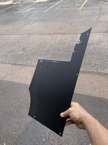

05-11-2026 ATLAS Z UPDATE. So I had a little time tonight before the sun set so I went out and taped the edges of the carboard I cut out in the pattern of the real cover (with the center cut out larger than the hole needed) and then cut cardboard into pieces and pushed it up to the fuel cell and taped them down all the way around. Then, by lifting carefully I was able to remove the whole thing, and....after putting blue tape on the aluminum cover, I used a Sharpie and drew the outline. Now I just have to cut it out and clean file/touch up here and there and it should drop right on!

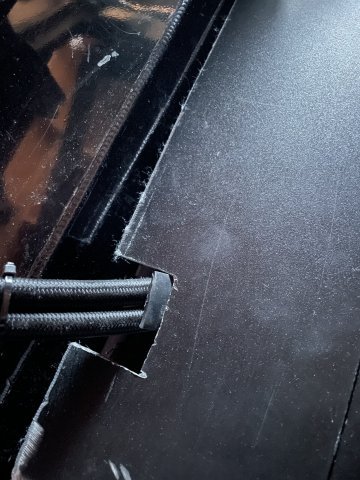

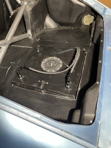

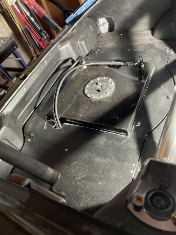

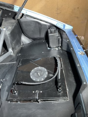

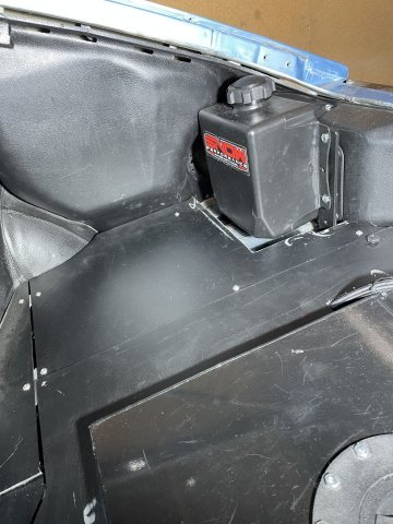

05-09-2026 ATLAS Z UPDATE: I finished installing the Apex Engineered rear strut bar and then went about cutting the floor pieces from my skilard floor and got it to fit all back together. Then I installed my rear license plate light and got everything all wired in at the rear of the car, and finished running the fuel cell breather hose down and cleaned the whole area up. Then I started on the venter of the console. I used some thin gauge aluminum plate....making templates out of cereal box cardboard and then cutting the aluminum to fit. Then I drilled holes and mounted the 2 pieces for today, masked it off and painted it in matching Rustoleum glossy black hammertone....matching the dashboard. I took some cardboard I had left over and made 2 templates of the rear cover plate, and then cut the center out of the first one, so I can begin the process of taping in pieces to get the hole cut out just right, then I can cover the aluminum skillard cover with blue tape and draw out the pattern and cut it out. I am also going to be installing the Snow Performance Stage 1 braided water ethanol 3 quart tank back there, but I haven't decided on the spot I want yet. All teh wiring is now ran up and down to the floor behind the passenger seat. PICS:

05-08-2026 ATLAS Z UPDATE. My Snow Performance Stage 1 Water-Methanol kit with braided lines arrived and I have started the layout of it.
