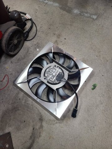

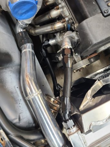

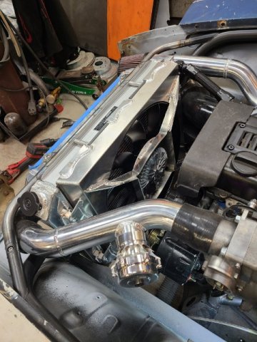

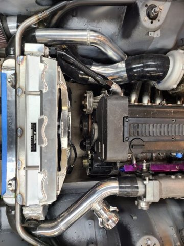

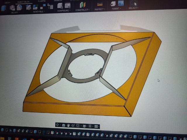

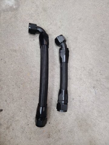

Next order of business was electric fan and shroud, and radiator hoses. I chose the 2016-2019 Camaro single SPAL 18" fan. it will be PWM controlled and is a very popular choice according to the internet as it can flow 5000CFM. Although I cut up the factory shroud to "work" I felt like I needed something fancier. modeled up a base to start working from and had my friends at laserbros in NC laser cut and bend it up. Should have gone one or two AWG thicker so added some bracing as well as some mounts and very happy with the final product. Cut down the radiator and inlets and outlets on the engine and welded on some -16an bungs, made up a couple hoses. in the last photo of the "hose installed" you can see the end of the pipe for the intake I welded into the chassis I mentioned in the previous post. Also decided to move the alternator to the other side of the engine to get it away from the heat. When i pull the engine to paint the bay i'll design and make a bracket to permanently mount it over there. -

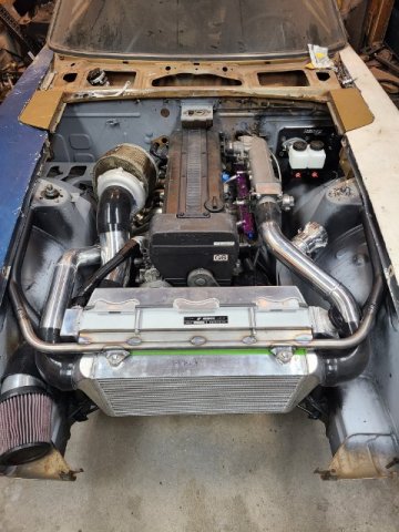

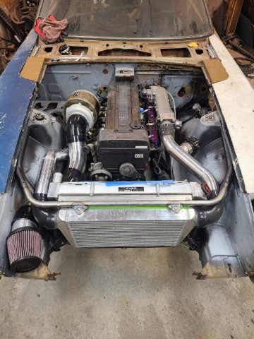

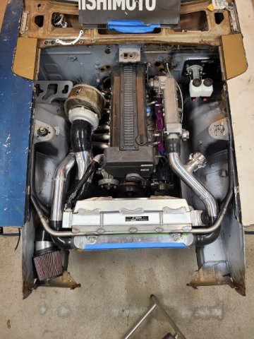

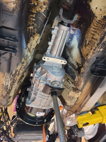

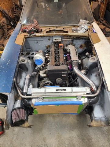

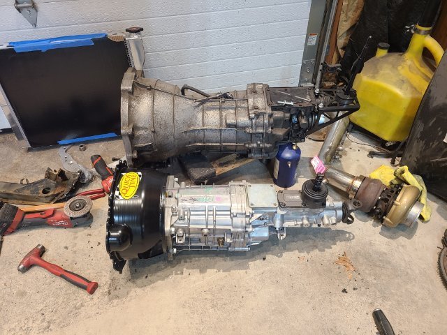

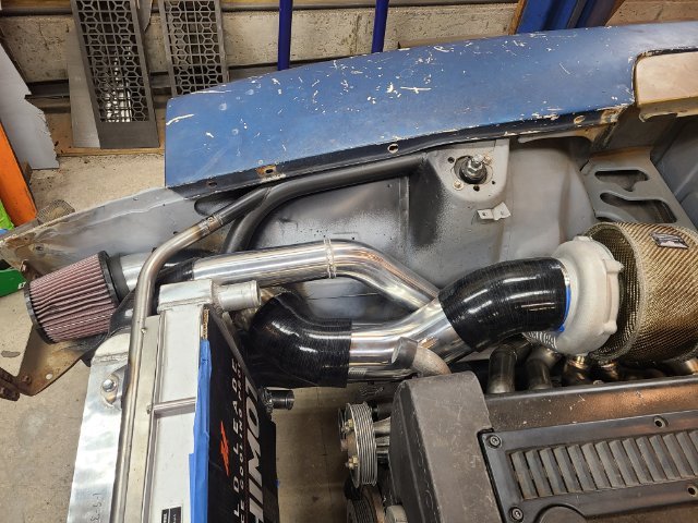

over the christmas break I got the rest of the turbo hot side plumbed. the manifold is like 3/4 welded up. My purge bottle was getting real low so instead of risking it i held off and started working on the rest. Notched a hole in the "wheel well" to go around the new added strut support bar I did that allowed me to run the 4" intake tube thru the front end and put the filter out in fresh air. Just made a piece out of 4" stainless exhaust, notched and welded it into the chassis. welded an elbow to the turbo. simple intercooler pipe made up. tial BOV on the throttle body side. have the downpipe fitted and tacked together back to about the bellhousing. Forgot to note. ditched the 350z trans for a tremec TKX. The size, weight, and gearing of the 350z transmission were all turnoffs to me. having run the tremecs in other cars i knew it was a good choice for this build. Much smaller. better gearing and options for a saftey blow shield made it my first choice. The car already had the factory trans mount cut out (poorly) so i cleaned it up and added a new mount system off the full frame rail pieces. that were also "added" They are so poorly welded that i used "added". I'll finish welding them in. -
