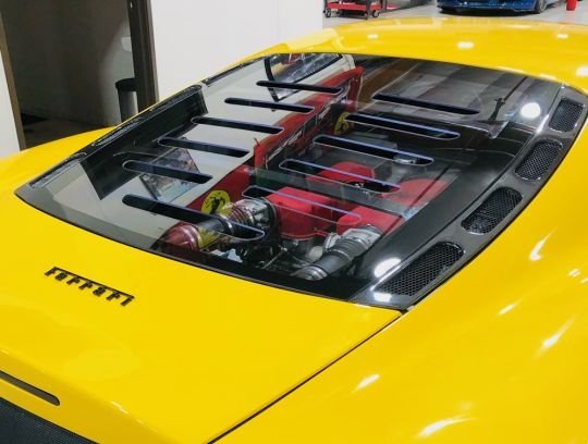

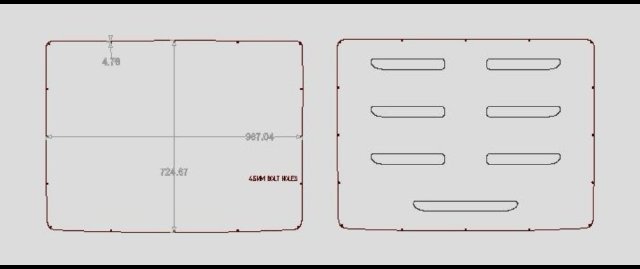

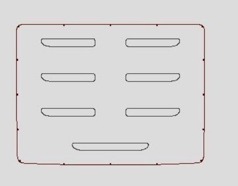

08-14-2026 ATLAS Z UPDATE/. Plastics 4 Performance has sent the final draft for my polycarbonate rear hatch "glass" for my approval. It is ready for production! The vents are to give the car an even more open air feel, which is what I want with this build. should look pretty cool. 8/32 bolts will be around the edge with a thin rubber layer between it and the lip on the hatch. Ferrari uses the vents for engine heat.....I used them because I like the look and as I said the open air feel.......no glass at all looks too unfinished to my eye. PICS:
