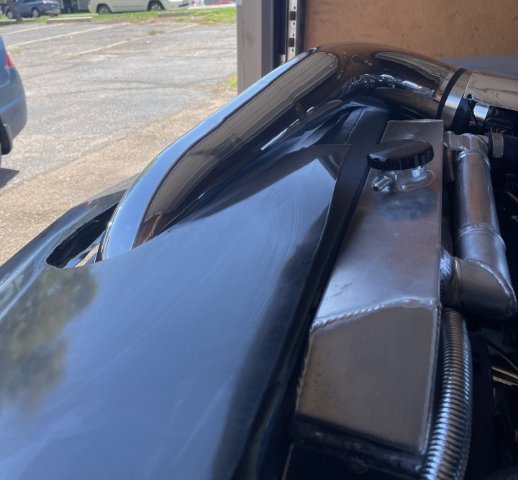

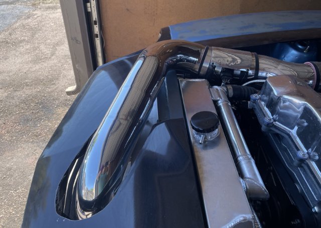

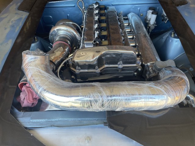

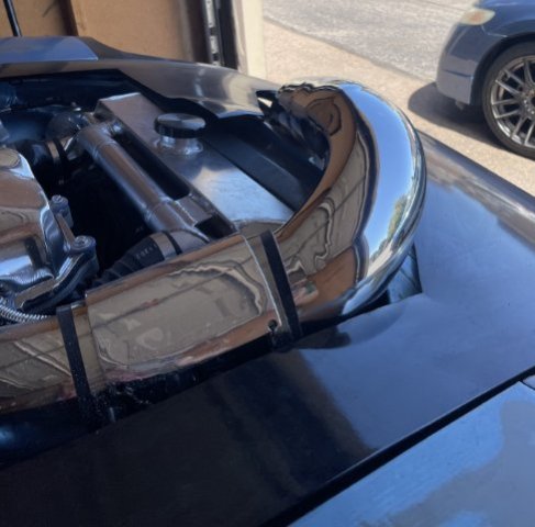

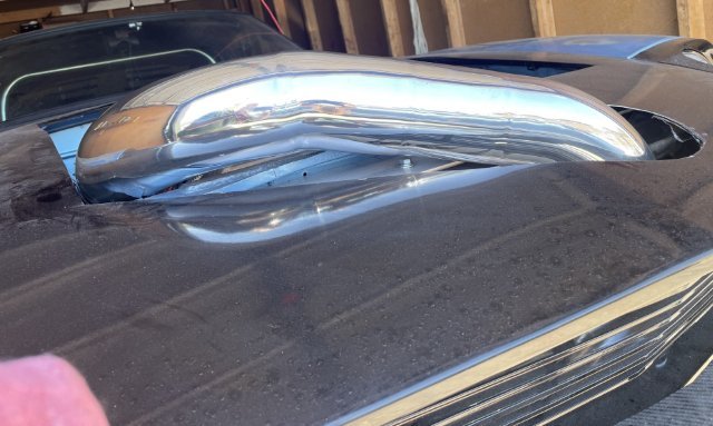

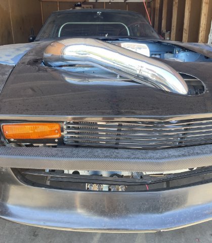

I didn't like where the intake was sitting so I did what I wanted with it. It's not for cold air, my intercooler and water/methanol injection provide plenty of cool. The entire build is done the way I want it......no thought has gone into doing what other guys would do honestly. If someone wants me to do something a certain way, that can be done, via monetary donation.
Whats with the cold air intake? You already have a giant hole in the hood all around the turbo
