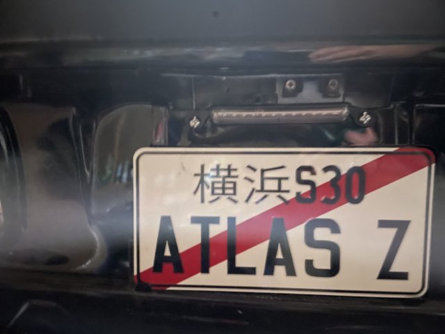

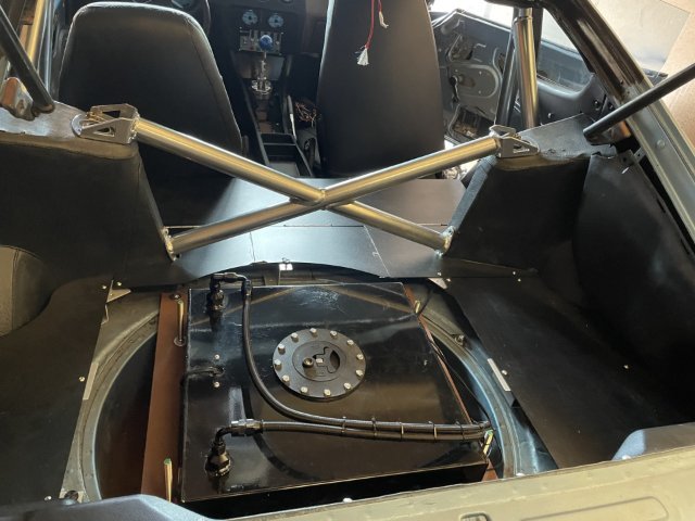

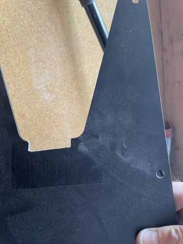

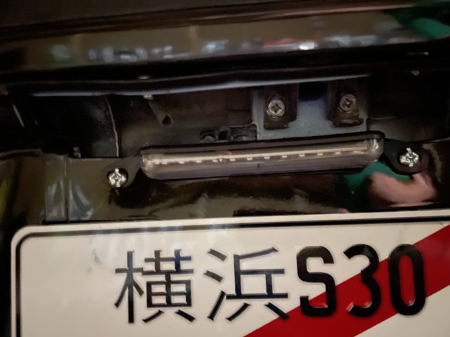

05-09-2026 ATLAS Z UPDATE: I finished installing the Apex Engineered rear strut bar and then went about cutting the floor pieces from my skilard floor and got it to fit all back together. Then I installed my rear license plate light and got everything all wired in at the rear of the car, and finished running the fuel cell breather hose down and cleaned the whole area up. Then I started on the venter of the console. I used some thin gauge aluminum plate....making templates out of cereal box cardboard and then cutting the aluminum to fit. Then I drilled holes and mounted the 2 pieces for today, masked it off and painted it in matching Rustoleum glossy black hammertone....matching the dashboard. I took some cardboard I had left over and made 2 templates of the rear cover plate, and then cut the center out of the first one, so I can begin the process of taping in pieces to get the hole cut out just right, then I can cover the aluminum skillard cover with blue tape and draw out the pattern and cut it out. I am also going to be installing the Snow Performance Stage 1 braided water ethanol 3 quart tank back there, but I haven't decided on the spot I want yet. All teh wiring is now ran up and down to the floor behind the passenger seat. PICS:
