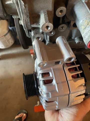

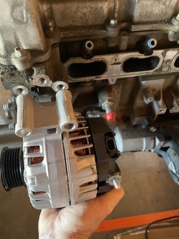

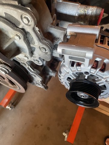

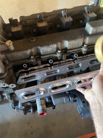

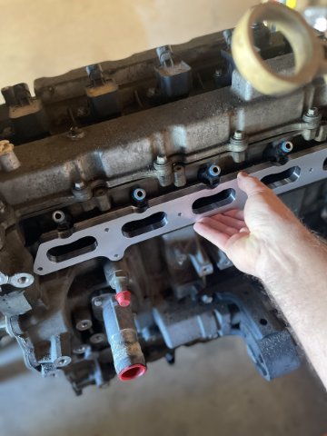

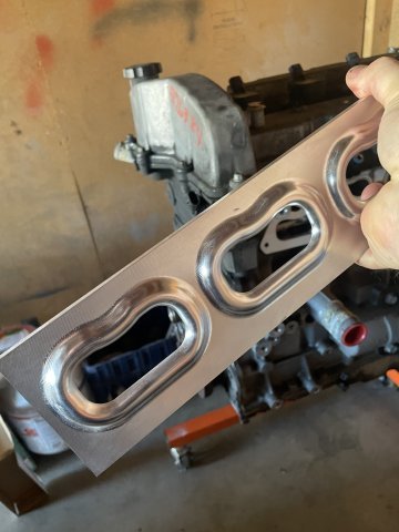

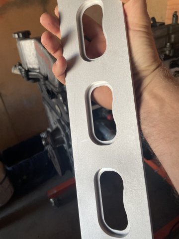

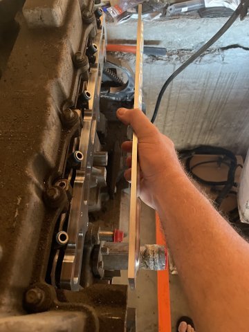

10-07-2026. I had a few moments today, So I took some measurements to get started on the DMZ intake DIY kit. Because of the intake, the original alternator location won't work, So I will make my own bracket and move it down to about the halfway mark. Plate steel or plate aluminum, M10X1.5 all thread screwed in to the threaded holes there, and start drilling holes and get it on there, and then slot holes as necessary to get belt alignment just right. PICS: - Last week
