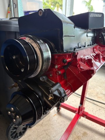

On my car, I am using the SN95 timing chain cover, water pump, and pulleys. By doing so. I have a couple of extra inches of space at the front of the engine. -

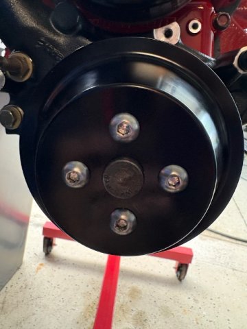

bolt pattern looks too small to. maybe just the photo? - Yesterday
Snugged up harmonic balancer and installed pulley. Water pump pulley doesn’t fit, hole in center needs to be slightly bigger, about the size of that indentation. I’ll get that on another day. -
