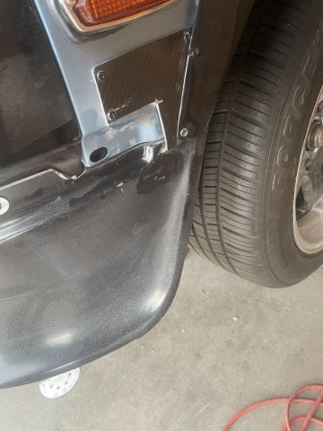

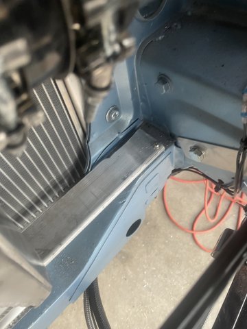

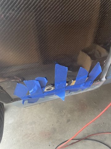

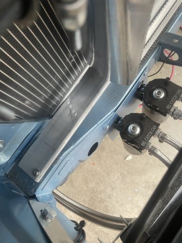

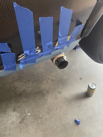

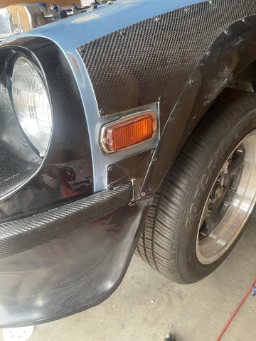

07-04-2026 ATLAS Z UPDATE. HAPPY 4TH OF JULY! I removed the front bumper and traced out and cut some spots in the carbon fiber to allow it to fit properly and re-installed the bumper. The edges will be hidden under a thin line of black silicone caulk. I also cut some aluminum stock I had and placed it under the intercooler and Tek screwed it down. it is basically just helping to support the weight. The 260Z fender emblems are on, taped to sit overnight and let the silicone cure. The rest of the day was spent fixing the other Z car I have. PICS:
