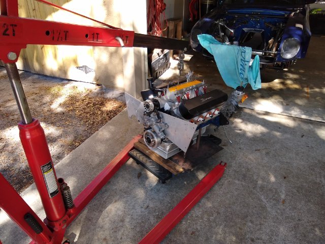

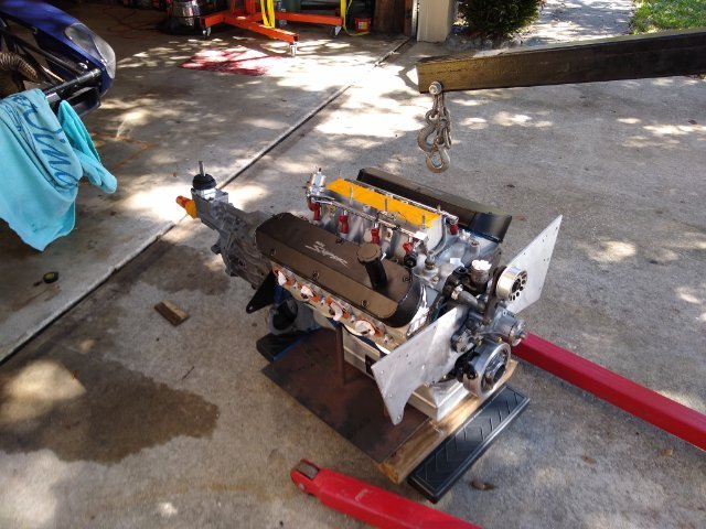

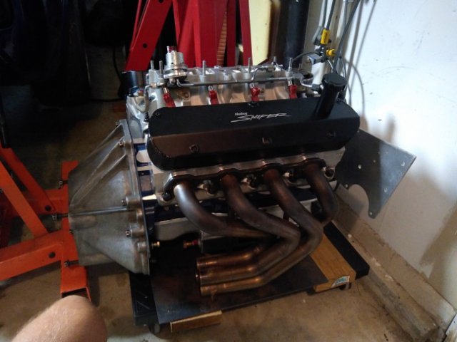

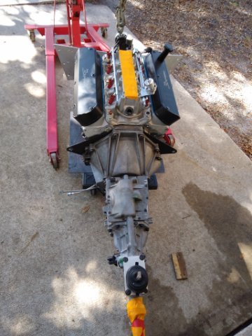

The front plate mid plate set-up was way easier than regular motor mounts. I originally used stock mounts, but switched to the motor plates when I decided to make it purely a track car. The front plate is 1/4" aluminum and sandwiches between the water pump and timing cover. The rear plate is .090" steel and sandwiches between the block and bell housing. The front plate on mine attached to tabs welded to tubes at the front strut towers. The mid plate is attached to two tabs welded to the frame. I use a regular rubber transmission mount. You can buy front and mid plates for the SBF that have the water pump and bell housing bolt patterns already machined. The plates come with a lot of extra material that allow you to trim to fit about anything. -
I’m not too familiar with plate mounts, I looked it up a few months ago after looking at your engine bay pics and wondering what that plate was for 😆. Was it easy to attach to the frame? I’d have to take my accessories off, but it’s a good option if I can’t make the cradle work. Thanks. -
Thats a good idea, I have some rectangular tubing I could cut into c-channel and weld into the notch. I’ll explore that option this weekend, thanks. -

I love my front plate/mid plate mounts. It opens up lots of room under the engine and stiffens the front structure. The downside is that you hear and feel everything from the drive line. -

how much of a "notch" would your cradle need to sit down? maybe notch it and attach it to the those apex supports aswell as the frame? -
Well bit of a bummer this weekend, I made a mock up of the engine cradle out of cardboard and it doesn’t fit, the extra bracing on the Apex track attack kit interferes. I made a mock up using 1-1/2” instead of 2” and it might work, still a little tight. I’m going to try and make it with the 1-1/2” and change the geometry a little, hopefully it’ll work. Since no fab/metal shops were open over the weekend to get the 1-1/2” tubing I decided to make a bracket to mount my clearview remote filter. I’ll get it painted and re-mount it. Not sure this will be its final location, but I’m happy the way it came out. -

Painted the bracket and snugged it up, happy with the way it fits. I’ll add a few more bolts but waiting to incorporate the bolts into a bracket I’ll make for the oil cooler when it comes in. I really need to get this engine back in, so I picked up some steel today, going to try and fab an engine cradle following the specs Brian Laine has posted online. Hopefully I’ll get some time this weekend to start on it. - Earlier
