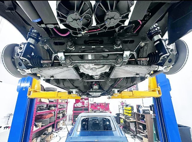

2016 camaro front struts from Strange were adapted to fit Justin Gilberts 1,xxxx hp build for maximum adjustment 2 way.- 282 replies

Unless somebody has a faster timeslip, fastest IRS s30 (barely) so far is Terry Garmon with 8.42 @ 166 mph in the 1/4 mile. Also included is a picture of Rick dunns 700hp car with the newest version of the rear swap, and a picture of all the components laid out, including the axles. The setup has evolved over the years, but even the earliest versions are out there putting down thousands of miles with all kinds of high and medium hp levels.- 282 replies

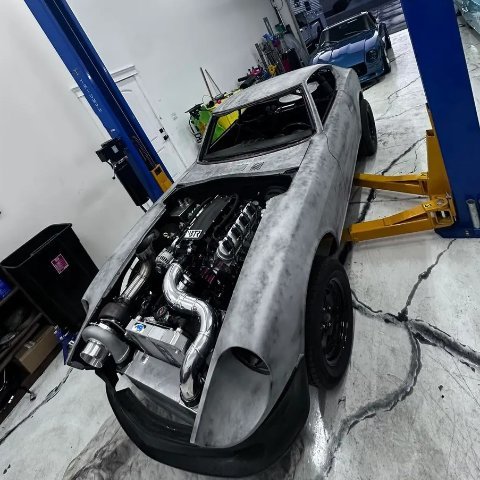

over the christmas break I got the rest of the turbo hot side plumbed. the manifold is like 3/4 welded up. My purge bottle was getting real low so instead of risking it i held off and started working on the rest. Notched a hole in the "wheel well" to go around the new added strut support bar I did that allowed me to run the 4" intake tube thru the front end and put the filter out in fresh air. Just made a piece out of 4" stainless exhaust, notched and welded it into the chassis. welded an elbow to the turbo. simple intercooler pipe made up. tial BOV on the throttle body side. have the downpipe fitted and tacked together back to about the bellhousing. Forgot to note. ditched the 350z trans for a tremec TKX. The size, weight, and gearing of the 350z transmission were all turnoffs to me. having run the tremecs in other cars i knew it was a good choice for this build. Much smaller. better gearing and options for a saftey blow shield made it my first choice. The car already had the factory trans mount cut out (poorly) so i cleaned it up and added a new mount system off the full frame rail pieces. that were also "added" They are so poorly welded that i used "added". I'll finish welding them in. -

started tackling the turbo system. designed and machined a stainless exhaust flange because I couldn't find one I liked. 304ss that seamlessly transitions the oval port to round so i can use sch 10 stainless. Went with a billet turbo flange from elmer racing. I make these kind of things but no way I could have made one for what they charge. beautiful piece. I ordered 321 sch10 stainless weld els to make the rest. after a little "writers block" i finally got a decent layout for a turbo manifold. The car came with a precision turbo but unknowing the condition and the size wasn't ideal i ended up going with a garrett gtx3076r with a v band inlet. -

Next order of business was to get the 1j sitting in there. It came with some cx racing motor mount kit but I really didn't like them so decided to make my own to put the engine where i wanted it. Apparently i only took 1 photo. but just imagine a second one of these mounts. once the engine was sitting where i wanted it i decided to cut the factory radiator support out and make something removable to make service easier.
