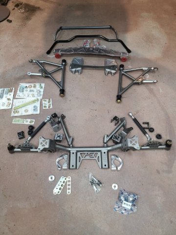

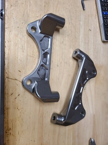

Got all the suspension bits unboxed and layed out. Have a combination of APEX and techno toys. Choose parts based on what I liked the designs features of and the car came with most of the techno rear bits. I am currently working with APEX to find out why the mounting points on the rear control arms are 1/2" shorter than the stock ones so they aren't a bolt in deal with the techno drop brackets. I actually don't think they would work with a stock setup either so assuming there is a defect so well see what they say. I can modify them if needed but for $500 id rather not have to so well see. Machined a ridiculous set of caliper brackets. I was talking with a local motorcycle racer and he said hed had some large pieces of titanium hed donate if i wanted to make my brackets from Ti. So a little redesign and a good amount of machine time later we have these ridiculous caliper brackets for the wilwoods. - Today

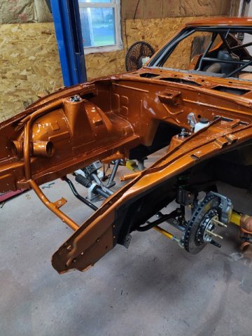

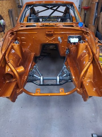

Long week number like 200 but happy with the my progress. Made a tweak to a color based off a cadillac cts5 v blackwing. Its a bit more "copper" tone of orange than I was picturing with the modifications but I am very happy with it. As soon as I started pulling the masked off areas and was seeing the contrast with the grey I loved it. Did get some fisheye on one door so I'll have to fix and respray that at some point and a couple sags/runs in the clear to sand out, but I can make some serious progress on the build now. did get the engine stripped down as well. Bearings, rings, valve springs and a gasket kit have been ordered to freshen it up. but otherwise everything measured out good and seems like a good starting point. -
