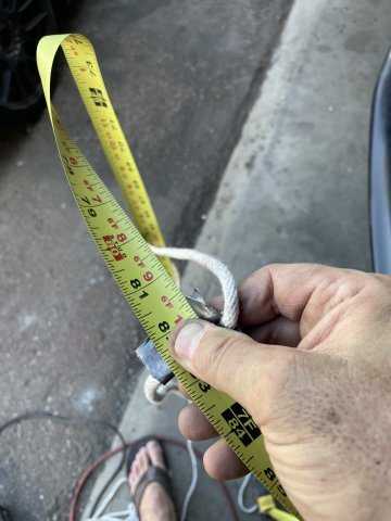

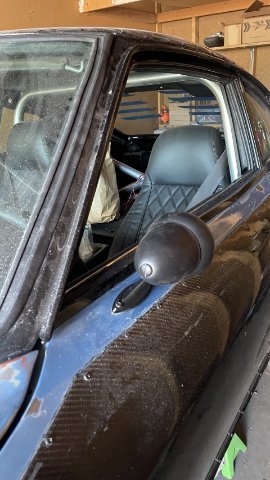

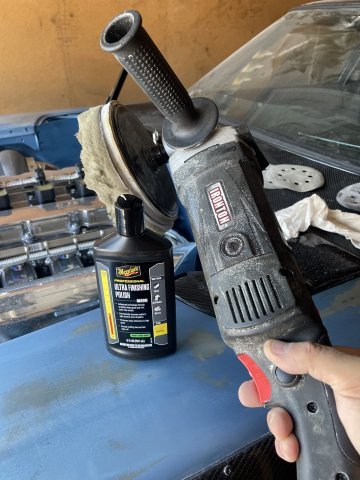

07-19-2026 ATLAS Z UPDATE: I started by color sanding and buffing the tops of the fenders and the sail panels with 2000 grit, 3000 grit and 5000 grit and then used Meguires Premium Polish with my foam pad on the buffer at medium speed. Then I re-installed the side view mirrors, and re-installed the emblems and plug for the antenna hole. Then I finished the door panels by putting the latch surround trim under the door release latches on both sides. Then I took some rope and measured out the length for the serpentine belt and the remaining brake lines, which will also be PTFE braided line form "Finishing Lines". All of this took longer than it sounds. PICS:

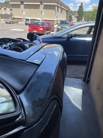

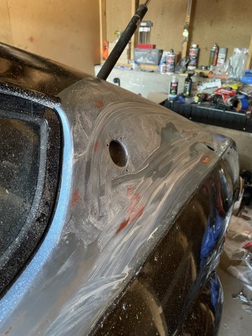

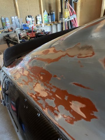

07-05-2026 ATLAS Z UPDATE: I finished feathering out the remaining blue paint, got it nice and smooth, then blew the car off and taped up the front fender and went ahead and caulked the seams. 260Z Fender Badge placement on the fenders looks good. Poppy's Patina Gloss arrives tomorrow, so we continue on! PICS:
