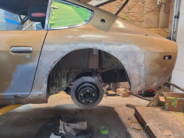

I'm real hesitant to try and mold the rear fenders. I have mixed feeling of molded vs "bolt/riveted on". So many Z guys mold them but very little details on longevity, expcially from something that is going to see excessive speeds, heat, vibrations. ETC. Anybody have any real world longevity experiences and installation techniques? -

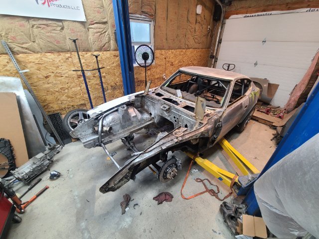

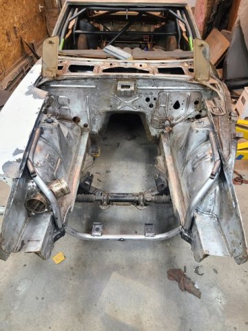

Although this is supposed to be mostly a race car, this car is a example of what I can build so and don't like cutting corners so changed my plans and going a bit further than originally planned. Pulled the glass (should have done that months ago). pulled the drivetrain and started sanding. Cut the arches for the rear overfenders. welded in the rear marker lights, fuel filler door, antenna, and started smoothing firewall holes etc. Hoping to get it in primer ASAP and start on body work. Found a few "easter eggs" under the paint but nothing too unexpected. Going to take the engine apart for a health check since its unknown. Depending what I find will be what I do. Hoping to see a healthy engine and just do basics. JZ are tough so feeling optimistic. - Yesterday

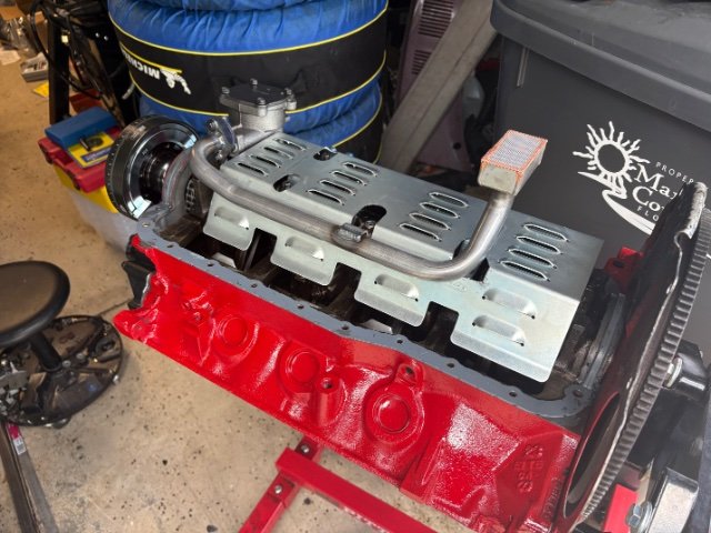

Screw up fixed, new oil pan is on. Had to modify windage tray for rear pick up to fit. Started on the harmonic balancer, not sure it’s on all the way, hopefully I’ll get a little more time tomorrow. -
I believe the winged maxima pan is the diesel pan

Some maxima oil pans have "wings" but most I've seen were simply front sump.

Looking at your pictures make sure that the oil pickup is parallel to the oil pan bottom. With it angled like that its going to be a ways away from the bottom of the pan.

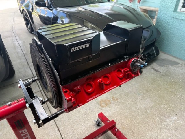

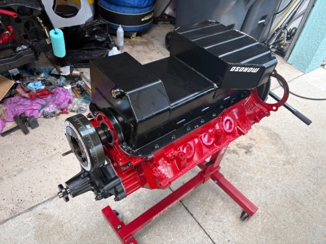

Im using the stock maxima oil pan. The diesel maxima pan should work also. It actually has more volume i believe and has a place to drain your turbo into also!!!
If your extending your oil pickup you can not drill the front dipstick tube hole. it goes straight through the oil galley. I was able to do it as i plugged mine first. You will have to make a dip stick tube holder in your oil pan. I drilled my block as Im way better at machining than i am at welding. What are you working on that you are front sump?
