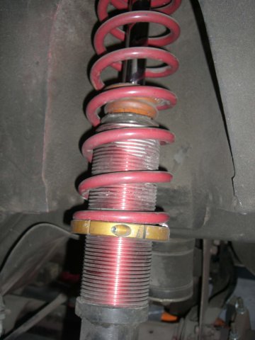

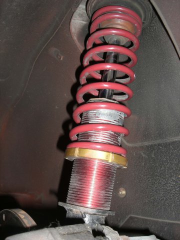

Well something was way wrong with the suspension on this car as soon as I drove it and now we see the damage, but the cause is a bit of a mystery for me. This is a ground control setup as far as I can tell, I believe the strut housings are 280z sectioned but I have to figure out how much was taken off. Both fronts are wasted and the rears are rubbing just not near as bad. Springs are Eibach 10†175# Rears and 150# up front. Inserts are unknown at this point. From what I can find around the site this is to light a spring rate, could that cause this kind of damage? Not sure why it would. Anyway looks like I will be looking for some parts soon and don’t want to see this happen to the new stuff. Any ideas are appreciated…Thanks

The problem is the inflexibility of the rubber insulator. It doesn't flex enough to allow the top hat to stay aligned with the spring perch. If you got Ground Control's newer style camber plate it would allow the two to stay aligned, and then the spring would compress straight. With the setup you have the strut is at one angle and the top hat at another, so when the spring compresses it bends and wears off the threads on the coilover. It's not particularly harmful, so unless you want to adjust the height to the area where the damage is or you want to buy a camber plate that can compensate, I'd continue to run what you have. New sleeves are going to get torn up exactly the same way.

Thanks Jon for another great answer, makes perfect sense. I don’t have a problem running theses if I can make it work. The ride in the front is just unbearably hard and wanders all over the road. I know I need to address the camber if its going to be this low but I was thinking of going with LCAs to avoid hacking up the car. Is the theory that the lighter springs cranked up will make the car stiffer than need be at the same height? This thing just has no give …Or am I just lost?
With a fixed upper spring perch you'll often get that kind of wear on the threaded collar. Adding a Torrington bearing and two races to the bottom spring perch helps a bit. Otherwise, just plan on replacing the threaded collar every couple years. Despite the looks its not that big a deal.

Jon, I agree with you and John about the cause but also I found that the OEM rubber upper perch will not keep the spring centered either. Somewhere I have a picture of mine from the race car where the bottom area of the upper perch was cut with a band saw and then ground until a carrera style upper perch was fitted into the OEM piece to keep it centered.

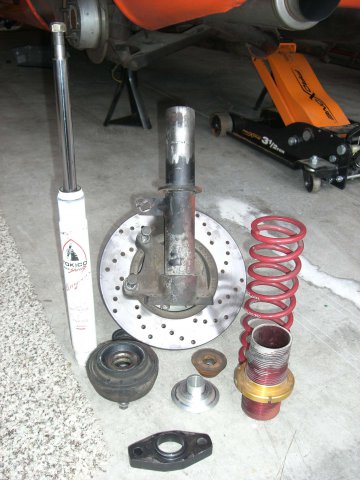

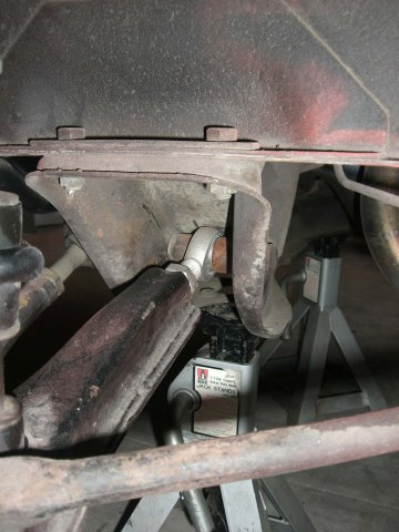

Well I finally got around to getting fronts out so now I know what its made of. Springs are 2.5x10 at 150# and they do have the top hat that fits in the end of the isolator. Struts are sectioned with the spring perch welded on 5.75 in from the bottom of the strut, I believe these are the 240 struts. The bumpsteer spacer is ¾ in thick and the inserts are illuminas BZ1073 for the VW. The struts aren’t leaking and seem to be smooth enough. I was also pleasantly surprised to find ALCA’s already on the car…cool. The only real problem I can see is the totally blown out to the point of binding control arm ball joints, also the gland nuts were just finger tight. So I guess unless someone tells me this setup just isn’t worth it I will replace the ball joints, and see if I can get it to feel right.
The sectioned struts may not have been welded on correctly allowing the springs to rub against the threaded collars. Depending on how the collars fit on the struts they may be stuck in one position and the collars will be damaged in just that area.
In most cases the damage is not in an area you will be using to position your perch so it's more of a cosmetic issue rather than a structural one.
I would suggest a set of camber plates (inner or weld on) and some real top hats made for 2.5-inch springs. This would allow you to center the springs and get some needed negative camber for those wheels (at your ride height you might need more spring and a few degrees negative to allow the wheels to tuck into the rear wells).

I believe Jon has hit it spot on, I have the exact same issue with mine. I am running GC's with sectioned struts and I took alot of care in aligning them properly. Ive never noticed the rubbing will driving and it really doesn't affect the functionality. Ill replace the sleeves whenever I install camber plates but until then everything works fine.

I am in the process of putting together a set of coil overs for my 73, which brings me to ask, are you only half way down on your treaded sleeves at the pictured ride height?
