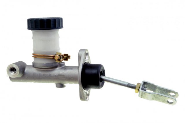

240Z clutch master cylinder clevis
Mike Mileski replied to Mike Mileski's topic in Brakes, Wheels, Suspension and Chassis
Unfortunately, Nissan has cancelled this part number and no Nissan dealers nationwide have any. I have even tried a couple of private Nissan parts suppliers with no luck. The vendors selling replacement clutch master cylinders must get them from somewhere, but I have had zero luck in finding out where. I placed two different orders with suppliers that still list the part number in their online inventory, but both replied back stating that they had to cancel because there was no longer any in stock. Mike Mileski Tucson, AZ -
You're right, I just didn't do enough clicking. I'm using an aftermarket clutch master and need to rethread the Datsun piece to 3/8-24 thread and I don't have the old one. For that price, I think I'll buy two of them. Thanks NewZed. Mike Mileski Tucson, AZ -
See the picture below to see what I'm talking about. Its the clevis at the end of the rod. It attaches to the clutch pedal. That's the part I need. Mike Mileski Tucson, AZ -
I can't find one of these for the life of me. All I want is the clevis that screws onto the clutch master cylinder rod that attaches it to the clutch pedal. I see them on all of the new clutch master cylinders that you can buy and they sell just the pin, but I want a brand new clevis and can't find any place that sells them. Does anybody know a source? Mike Mileski Tucson, AZ

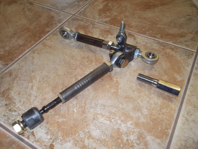

Front Control Arm Design
I think that, based on what you guys are saying, and thinking more about it, that I'm going to nix this idea. Mike Mileski Tucson, AZ -
Thanks for the comment. That's why I'm putting this out there. I can envision the control arm rotating a little bit, one way or the other, as it moves up and down but I can't envision any flopping around, in a static position, since the TC rod is a fixed length. The inner tie rod is a Moog EV162. Mike Mileski Tucson, AZ -
I have been putting together a new front control arm design. The outer portion of the main arm will have a rod end with high misalignment bushing in lieu of an outer ball joint. I used a double adjuster welded inside of piece of 1 1//2" OD tubing for the outer portion. The little rod end on top is for the sway bar link. The big difference is the TC rod. It uses a steering rack inner tie rod on one end and a pivoting rod end where it attaches to the main arm. That's the part I'm wondering about, will the pivoting rod end really make any difference compared to the normal solid connection? Any thoughts or comments on this? Mike Mileski Tucson, AZ
