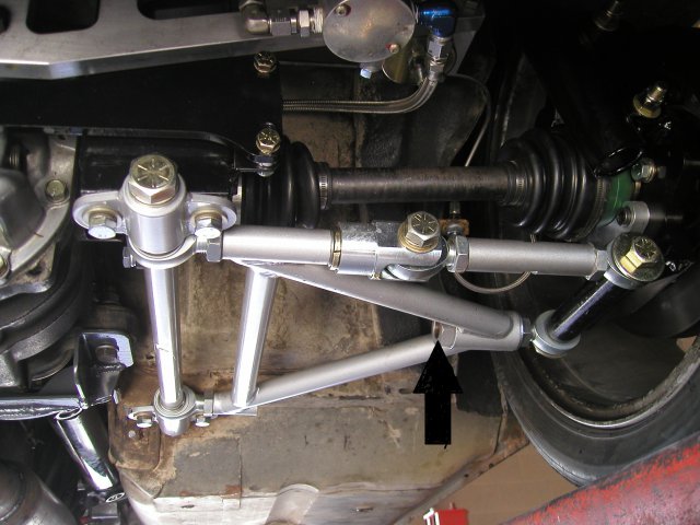

Adjustable front control arm options
Mike Mileski replied to wheelman's topic in Brakes, Wheels, Suspension and Chassis
If I ever decided to add a rear bar, I have a 3/4-16 threaded hole in the adjustment sleeve on the front portion of the arm where it attaches to the upright (see black arrow). It's located in the area where you would attach the sway bar link. I could easily make up something that would attach there and link to the end of the bar. Mike Mileski Tucson, AZ -
